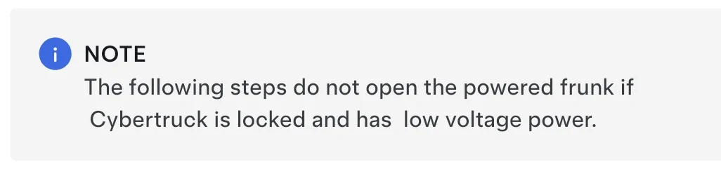

Hmm interesting idea. Just need to mount that button in a place where it can be accidentally hit by debris or anything on the road. That to me would be the biggest issue. Imagine driving and something accidentally hits it and your frunk opens while driving.
May 27, 2024
4,531
5,512
The frunk popper leads are supposed to only work when the MV battery is dead.
In that case, I wonder why they didn't wire them to the normal frunk button.
Edit: nevermind, I read that wrong. It still needs voltage.
