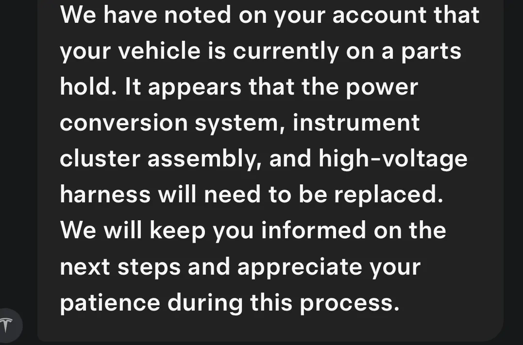

Looks like they have an idea now. Just in:
I think they mean Device Cluster Assembly, a high voltage part under truck that has to do with HV communication.
I don't "like" this, but I'm glad you're getting the answers. Luckily should all be under warranty. Really seems like this was a faulty part.

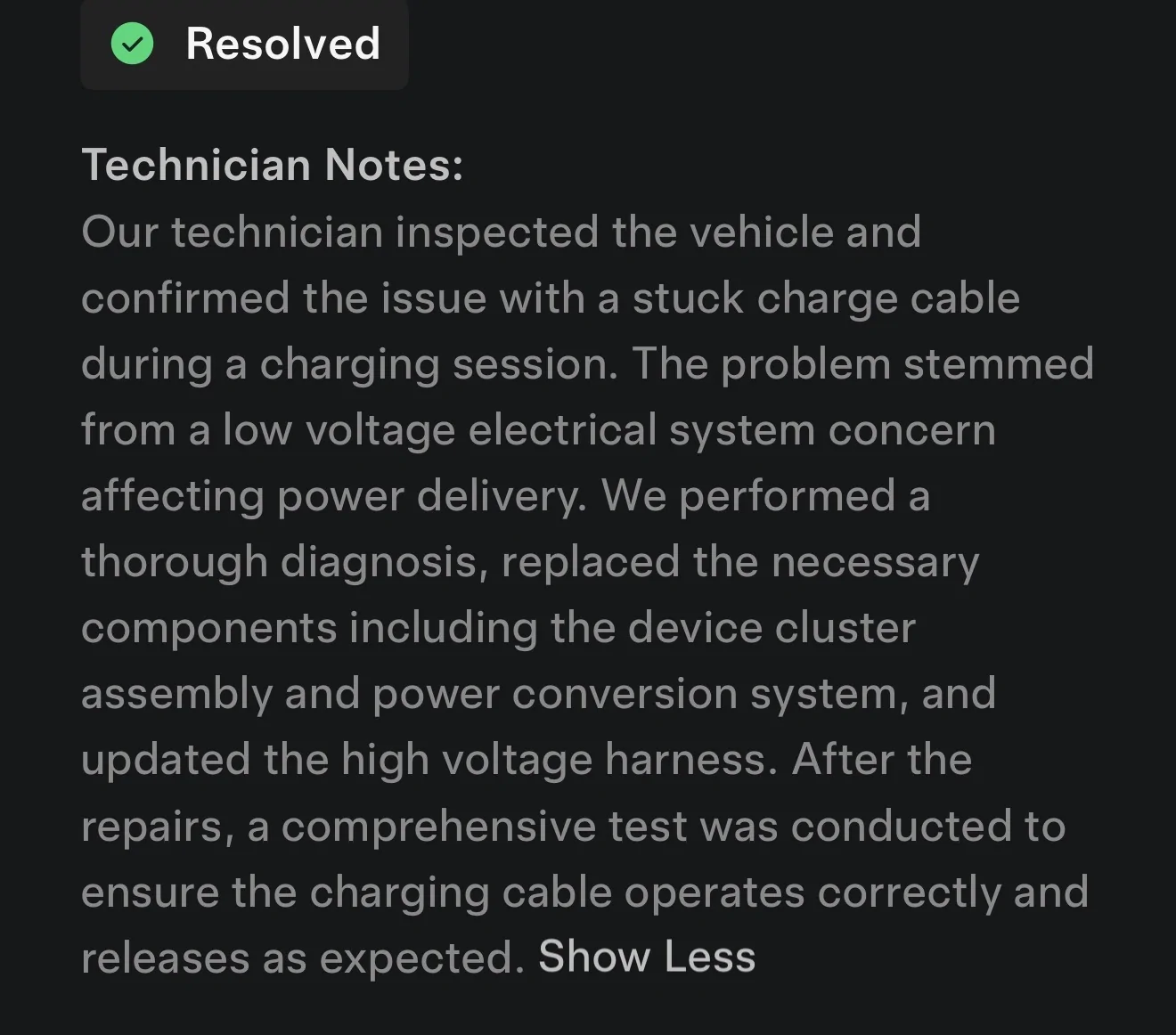

Well, after 18 days at the service center ”waiting for part” the truck is finally fixed. I‘m almost 4 hours away and it’s closing time so I haven‘t picked it up yet. It’s showing up on the app again after being a ghost. This is what the app shows was repaired:

Can anyone comment on what the “device cluster assembly“ is and what the “power conversion system” does?
Thanks.
