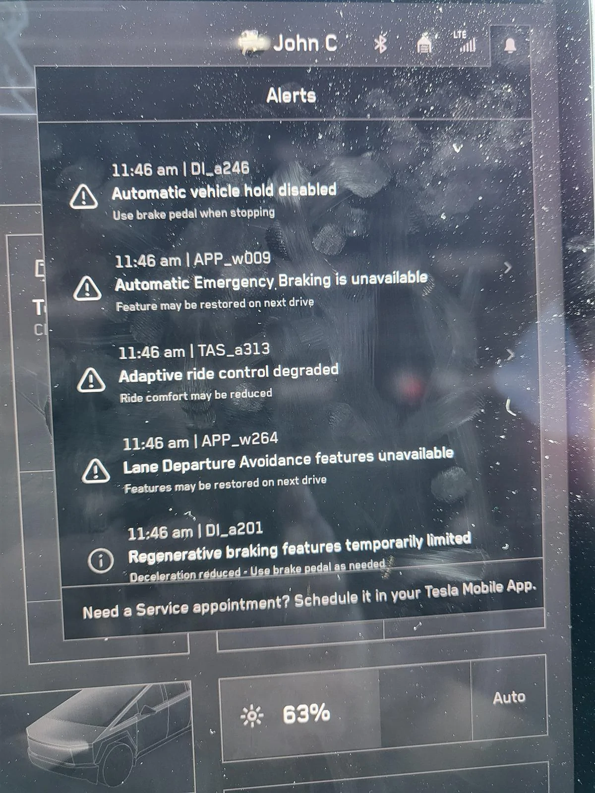

Had the car back for a day and it happened again today. Ended up spending maybe 15 mins getting in and out of the car repeatedly (while on the phone with roadside planning to get a tow) and eventually I got it to drive again. Photos of the error codes below. Fun.

Well that sucks, though not surprising. Unlikely that the previous issued fixed itself on it's own.

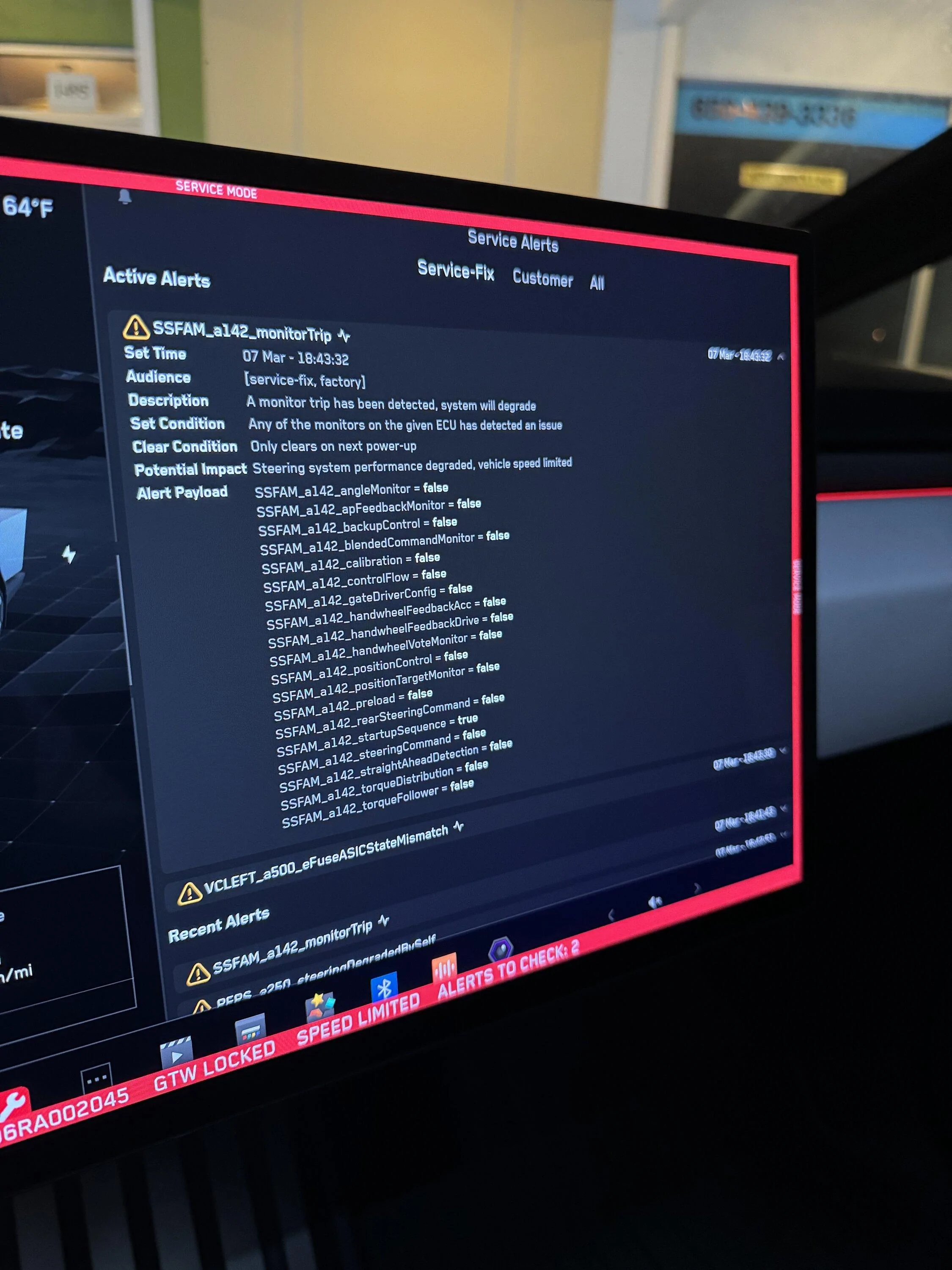

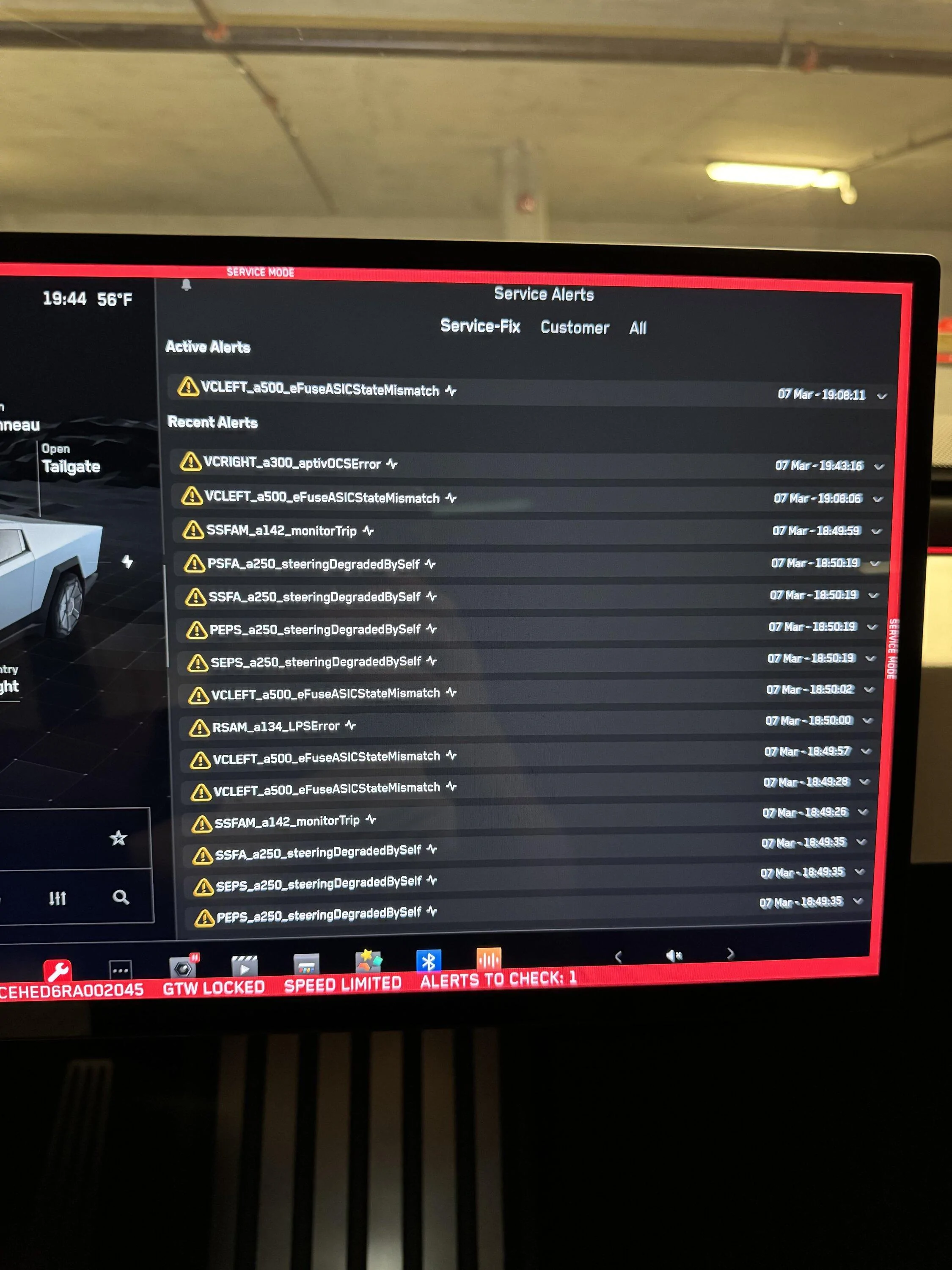

It seems there is a bigger issue at play here. Please keep us updated on what exactly caused this as I'm starting a list to keep track.
Did you see any other error mesages like power, SbW, Brakes or wiring etc?
I have now after 3 weeks....see attachment
