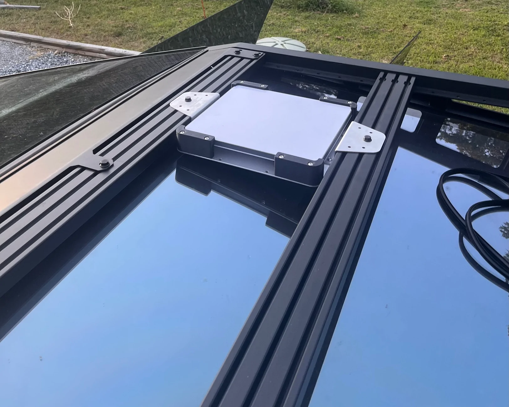

does anyone have or make a low-profile mount for the mini to mount it where the bed meets the window.

I've been running starlink directly on the roof feed for months. Works like an absolute champ, and I feel like a space-man roaming around this planet. The technical capabilities we have with this truck haven't been remotely tapped yet.
