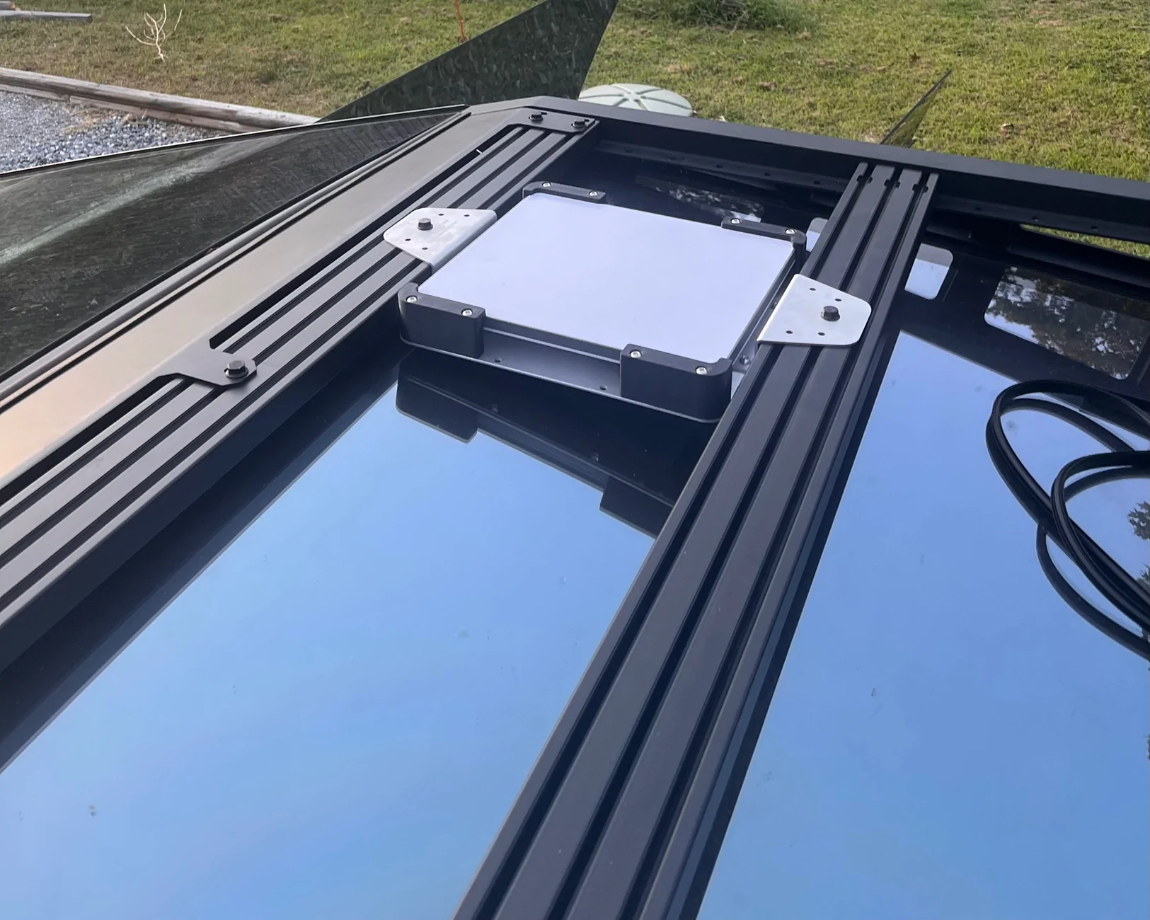

to the dish on the roof.

This system allows you to use a factory Starlink power cable ($31) while keeping Starlink mounted over the roof instead of over the bed. I had been running my Starlink on my crossbars mounted over the bed with the power cable running to the bed outlets. That worked just fine, but there were crossbars mounted over my bed - obviously not ideal for loading large items. I wanted the crossbars over the roof.
Some people run Starlink inside the cabin, mounted to either the giant dashboard or the roof with a suction cup mount. The problem with that is there’s extra cables in the cabin now and one of your outlets is permanently taken. Also, with the bed or cabin outlets, they disable if you ever plug the truck in to charge, which will kill your internet connection.
I’ve tried everything under the sun, and I can tell you the ultimate solution to all problems is mounting Starlink externally over the roof. No loss of power during supercharging (yes, I confirmed that today. I drove ~80 miles and had no outages other than the 1-2 second ones you always get while driving under overpasses and whatnot.

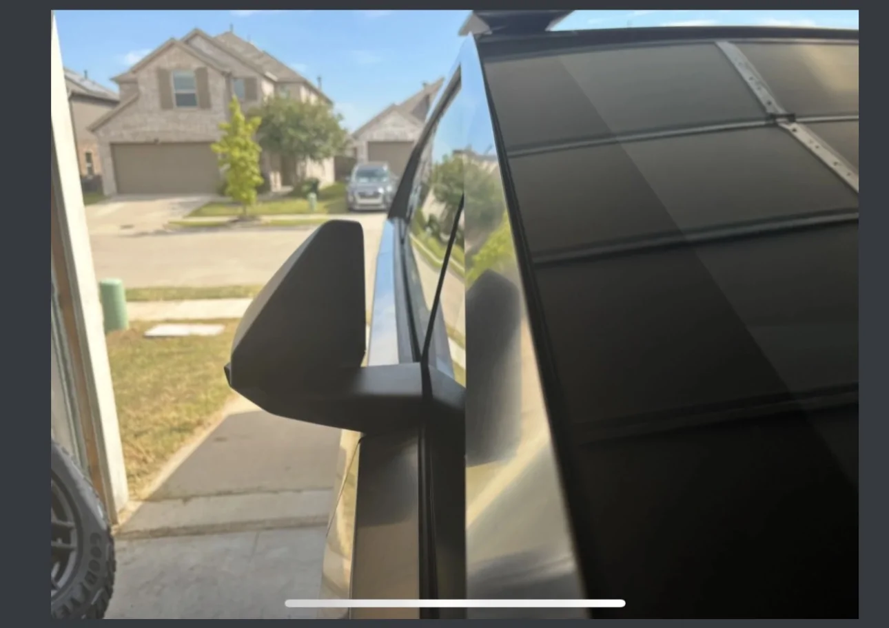

What’s going on in this pic? Is that solar panel? If it is it’s quite nicely sized

I will readily admit, as I did in the original post, that it’s possible this is all unnecessary and that Starlink would work just fine hardwired to the roof or frunk feed directly. I just wasn’t willing to take the risk and this provides both peace of mind and ease of replacement if some nut job snips your cable while you’re away from the truck.
The comments so far seem to confirm what I had experienced up to this point: we don’t know for sure if it’s fully safe to direct hardwire.
