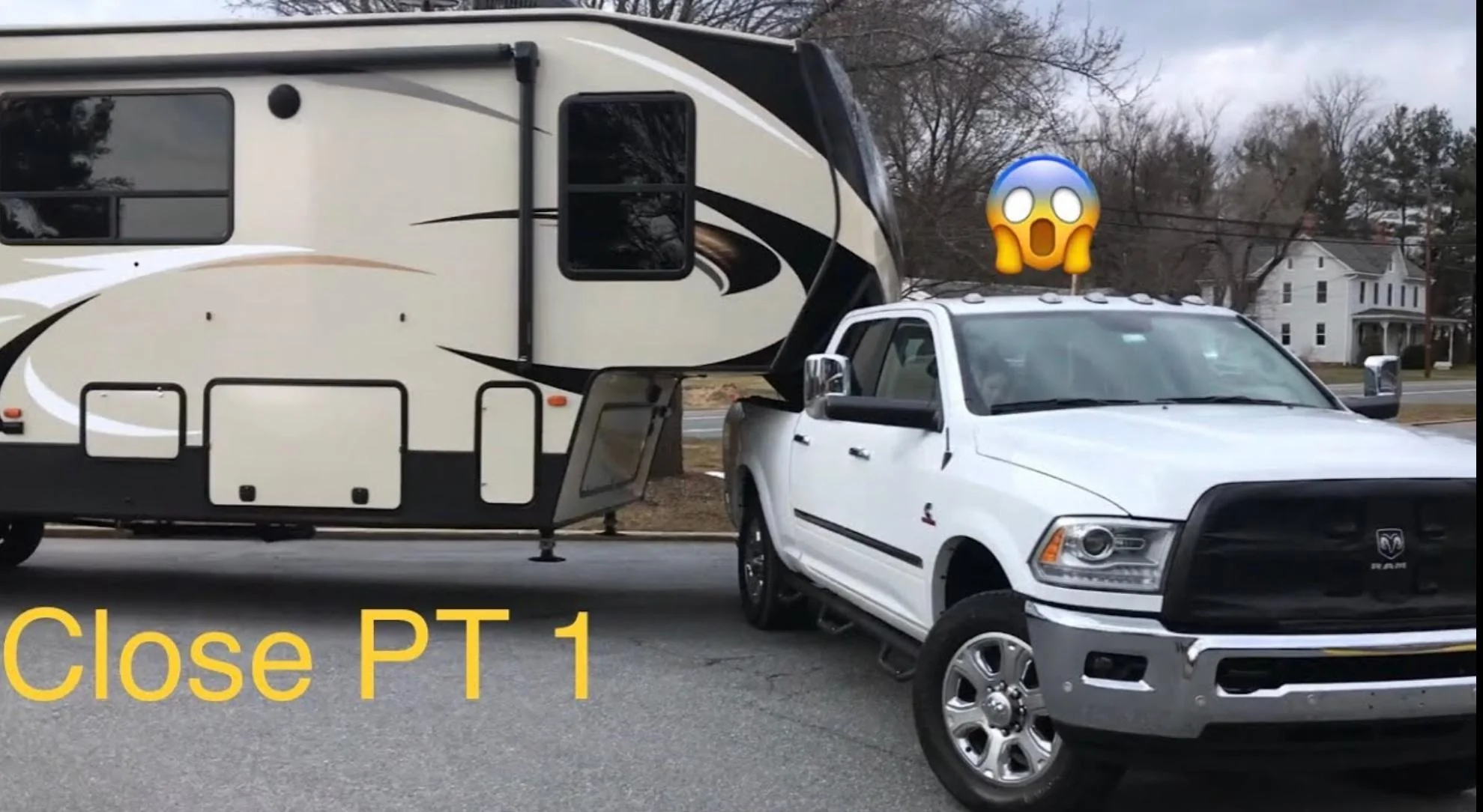

The 5th wheel issue has nothing to do with the tailgate. It has to do with the rear windshield and turning 90 degrees to it. On my F-350, with a clear bed of almost 7’, I can’t go 90 degrees. It’s pretty well understood that an 8’ bed is needed, or a slider hitch.
See what I mean about the turns? The 5th wheel pivots in the bed, you need 100% clear unobstructed 90+ degree turns.
Based on the tape measure pictures and other things, the only way it could ever work is if the bottom of the trailer was higher than the sail panels, which would mean the trailer has to be above legal height. They are in a specific reason to be at the exact legal height limit and still have 6’+ of headroom in the bunk area. We can’t change the dimensions of the trailer.
Also, the pin weight has to be forward of the axle to push load onto the front tires as the rear tires alone don’t have the load rating, in general, on any truck. That’s the primary advantage of the 5th wheel is putting weight on both the drive and steer.
