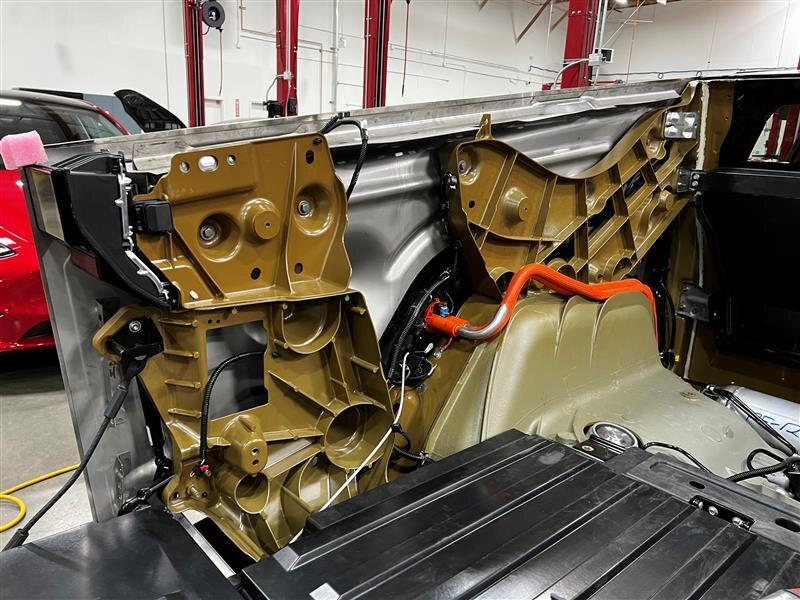

The quarter panels are double sided SS. The 1.4mm thick outer panel is laser welded to a thinner stamped SS section.
Your CT will require disassembly of the bedside to access the sail panel bolts.
