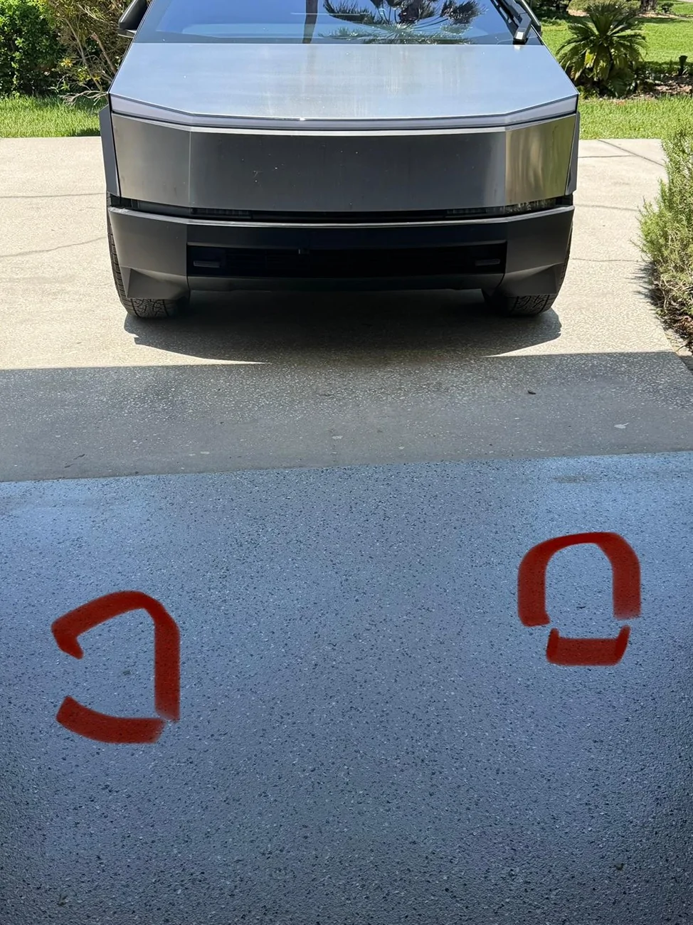

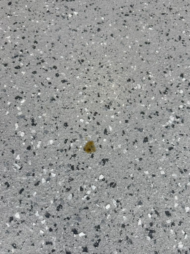

My Cybertruck is a 2026 AWD premium model with only 3 months, i have put 4,000 miles on, and I’ve started noticing small amber-colored oil spots on my garage floor every morning. They line up with the rear wheel area on both sides.
The truck drives perfectly, with no warning lights or unusual noises. I have a Tesla Service appointment on July 10, but I’m wondering if it’s safe to keep driving until then or if this could be something serious that needs immediate attention.
Has anyone experienced this? Any idea what fluid this might be?

Drive straight to the service center immediately and tell them that it is a safety issue and they will take the truck immediately for something like that and give to a loaner. Don’t wait till the service appointment. GO NOW!

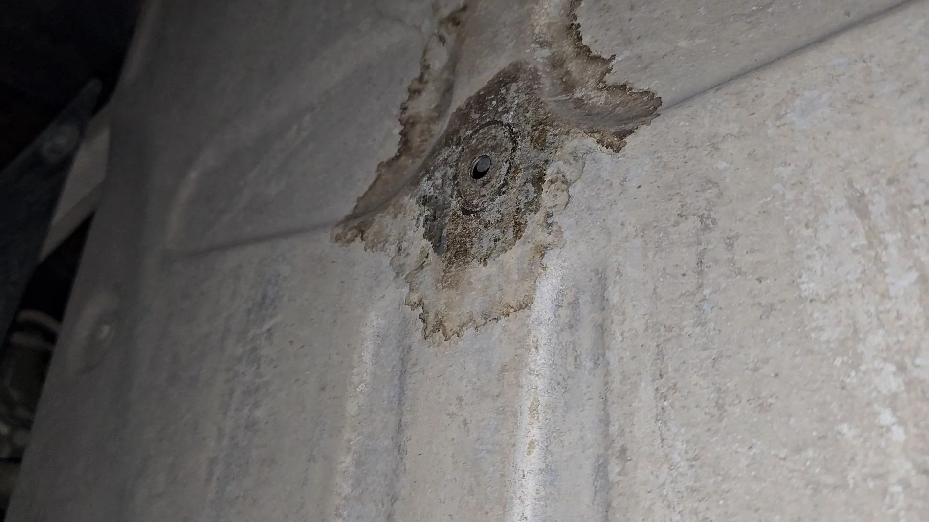

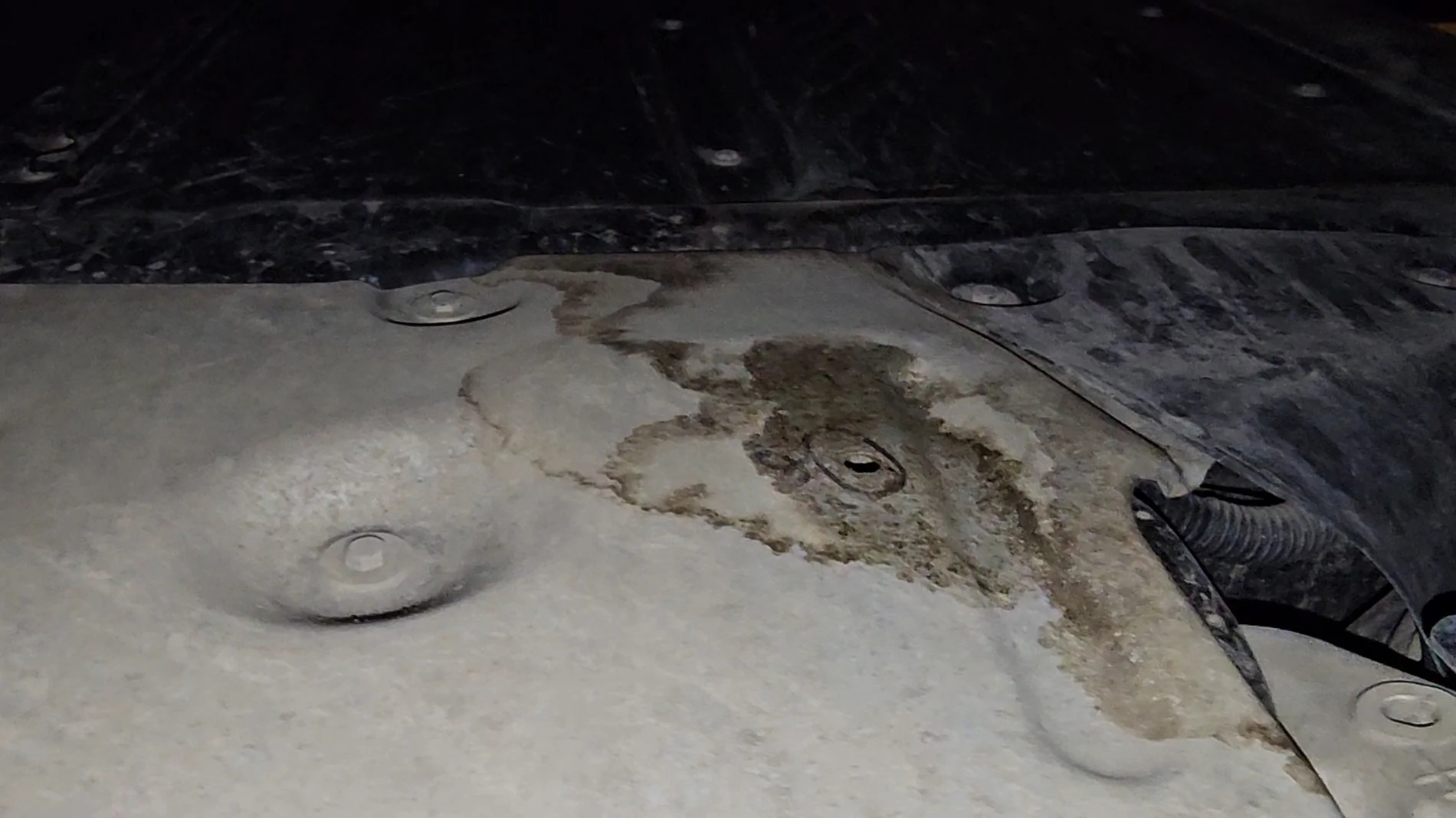

I have a similar issue but with the front axle. I took photos of the undertray skid plate. SC estimates $126 for inspection.
