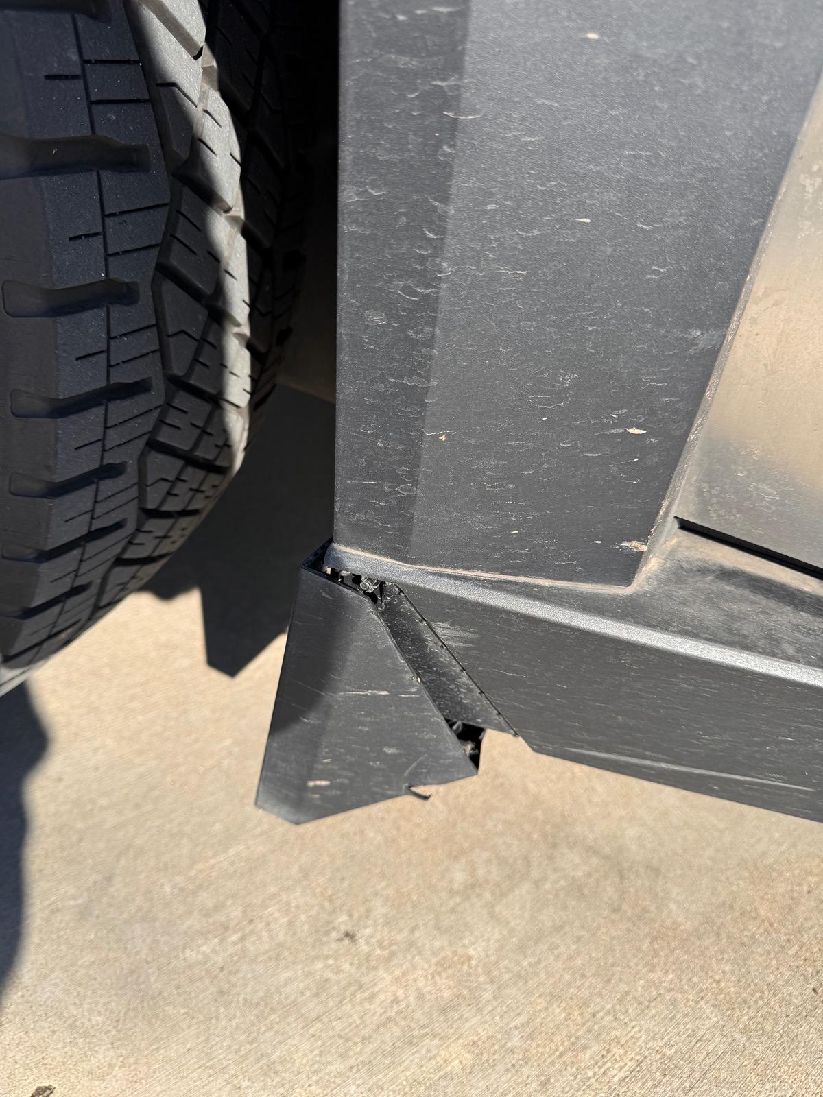

Well after 2000 miles I’ve managed to break both my rear rocker fairings. One side because of a tree branch and one side because of dead armadillo on the road. Both times driving on some dark roads.
Hopefully Tesla service wont beat me upside the head getting these fixed.

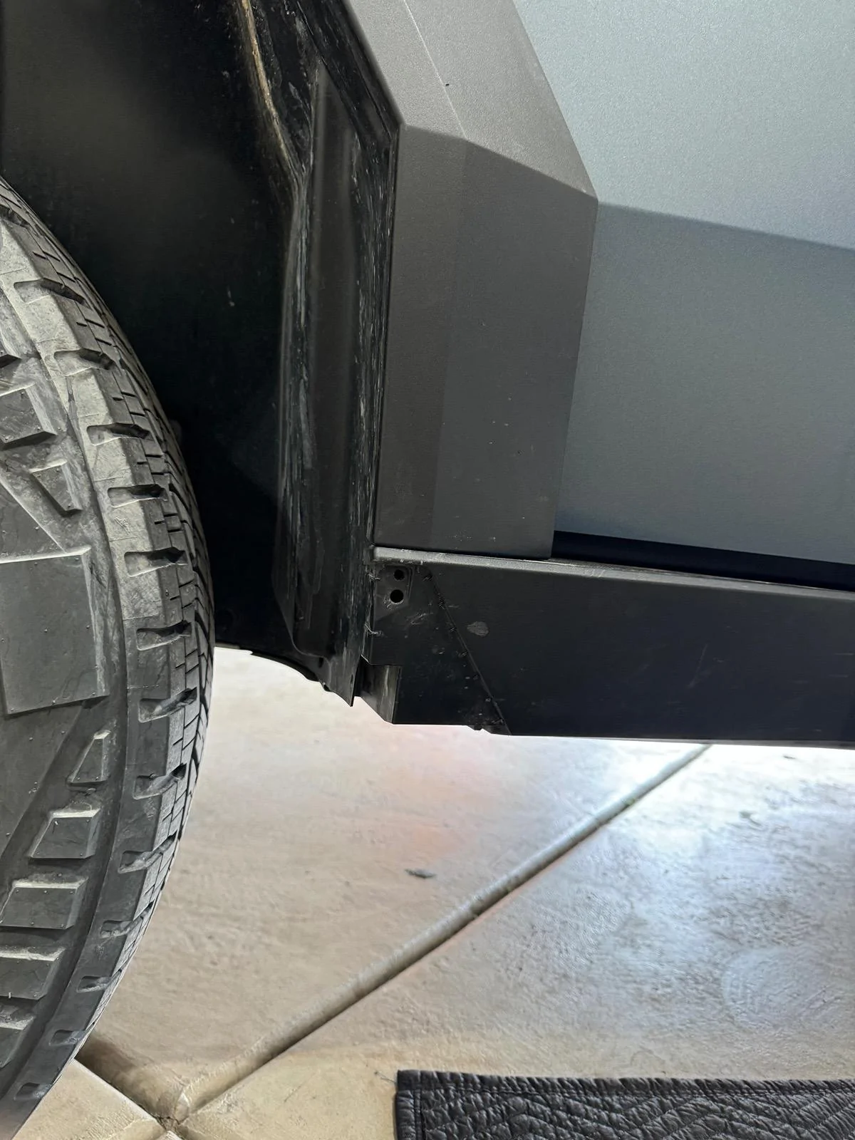

My beast was just delivered without both rear fairings I couldn’t believe it
Do you have a picture? Dying to see what it looks like without them.
Also really want to know what kind of efficiency hit you take with them off. I know the mirrors being removed didn't really move the needle, so I am hoping the same is true of these.

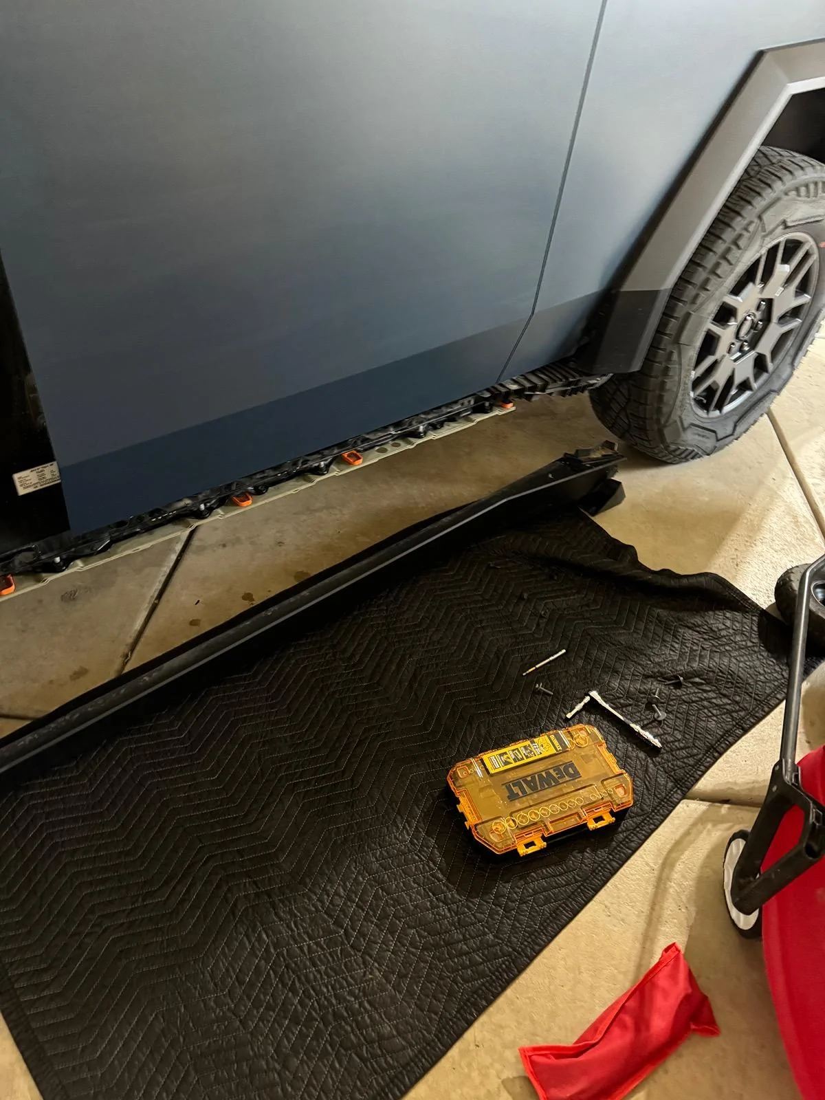

Just posting my thought, i broke both offroading and removed rhem. Its not hard at all! 8 10mm bolts and you can pull off the whole rocker panel, then a T35? to unscrew the rear fairings. First side took me 25 minutes, second side 15 minutes!
@Mettalicron, picture with them off?

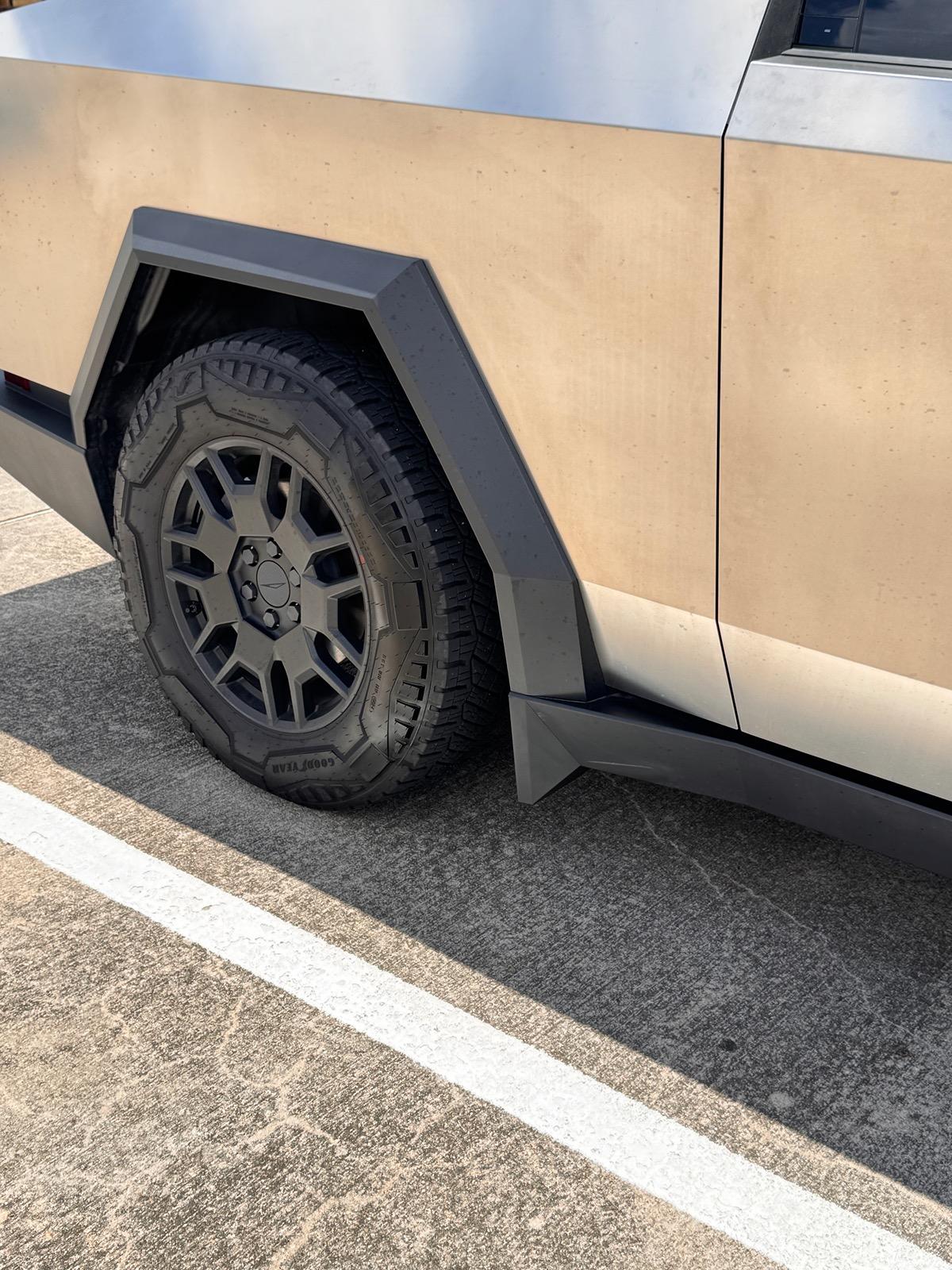

It looks like they're pretty exposed and fragile. Deleting them in some cosmetically clean way might be a good thing for some folks, especially for off-roading.
May 27, 2024
4,661
5,668
Yeah, the off-road guide recommends removal.
Only minor issue is the rear wheel liner pins to the aero fairings so it's slightly less secure with those removed.
