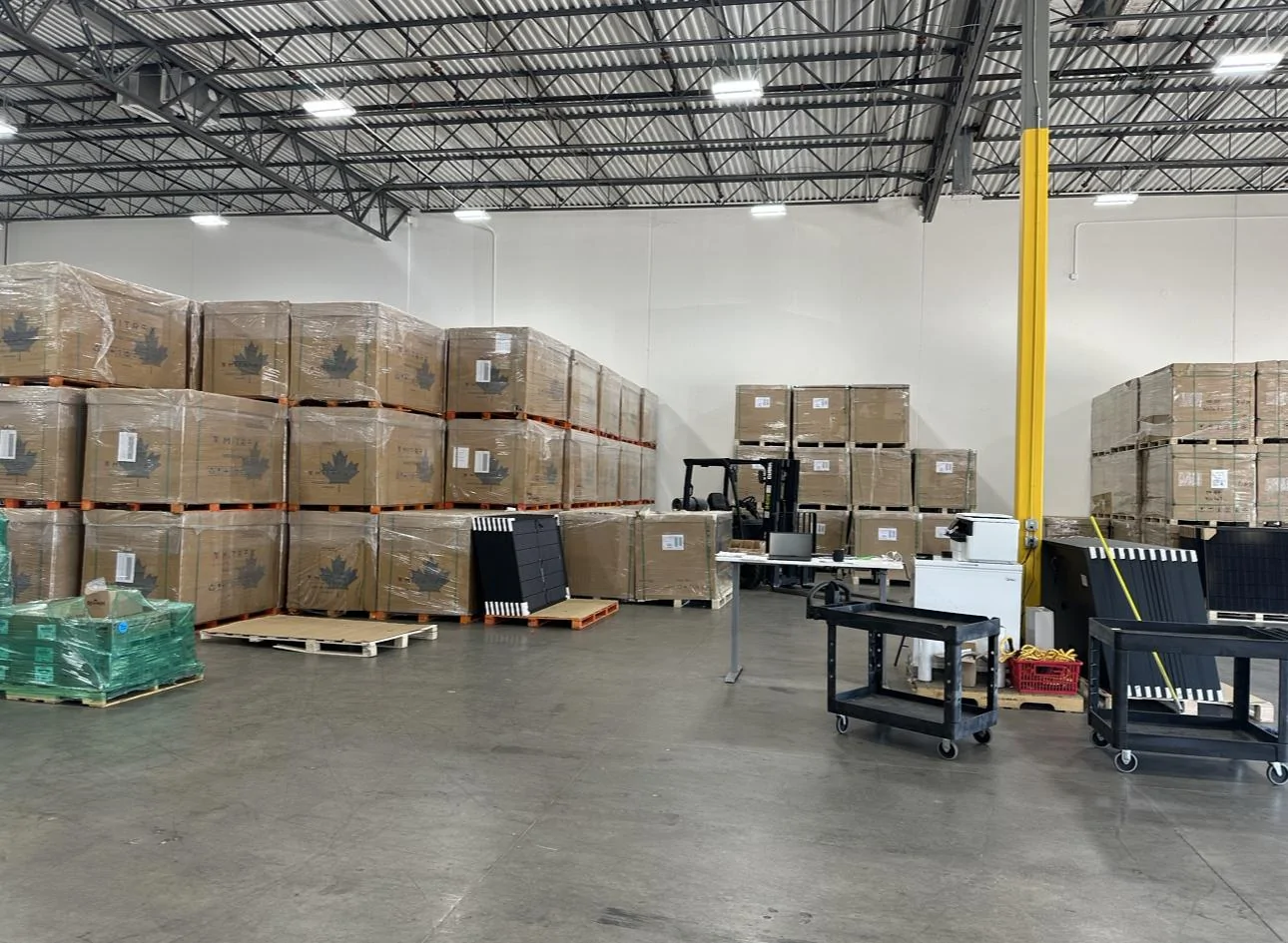

...Solar panels are not the fragile things of decades past.
You caught me I definitely do not know anything about solar panel durability. These are just decorative packages stacked in one of several large empty offices. Its this new Feng Shui technique ive been trying out.
Tesla Cybertruck Cybertruck 3mm body: hail resistant? IMG_6632
127
16,727
27,819
...Then you should know they're pretty durable now a days? Like, I have different panels from about every five years for the last twenty and the newest of them are basically indestructible by hail.
