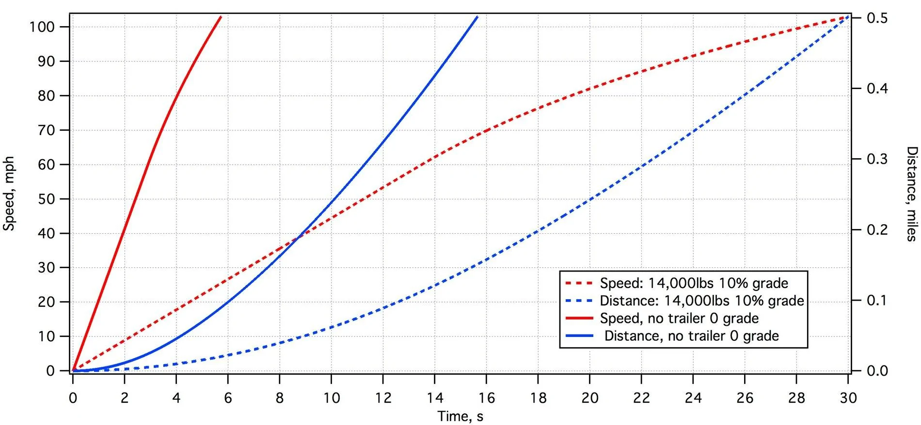

But the big question here is are these killer trucks? Omigosh yes! Elon said that we won't appreciate how good they are because we don't know enough to figure that out but perhaps he didn't realize how much just telling us the 0 - 60 performance reveals if we have a decent weight assumption. 6600 lbs seems pretty reasonable (3000 kg) and 0 to 60 in 2.9 seconds implies that the motors can deliver 27.7 kN of thrust and assuming that power limiting kicks in at 60, that the motors are capable of 744 kW, Those two facts imply performance curves that will be something like these;
The solid curves say we can expect 0 - 100 in about 5.5 sec and a quarter mile time of about 10 seconds. The broken curves are for a 14,000 pound trailer being pulled up a 10% grade. 0 - 60 in 13.5 seconds and the quarter in 20 seconds. I'm still looking for an error in my calculations because I just can't believe these numbers. When I look at the big (6.4 L) diesels I see 250 - 300 hp engines that can be blown to 600 hp. This truck has about 1000 and 14 kN-m torque at the wheels (0.5 m wheels). I don't know much about trucks. Are there diesels that can do this?

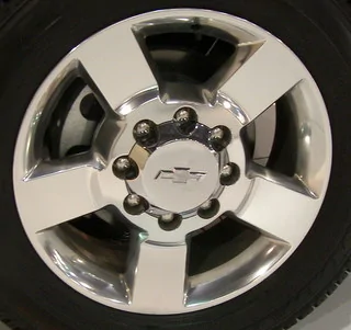

You can bet the CT will be using HD wheel studs and lug nuts to handle the amazing torque. Will they go 8 lugs as well, just like 3/4 and 1 ton pickups?

We estimate 27.7 kN of thrust. With half meter wheels that means torque of 13.8 kN-m for half meter wheels, 4.4 kN-M per wheel. If the lug nut radius is 10 cm that means tangential force at the stud radius of 44 kN which is torque related 5.5 kN shear on each of 8 studs or 7.3 on each of 6 plus their share of the gravitational force. As I don't know what sort of load wheel studs can handle I can't say more than that.
