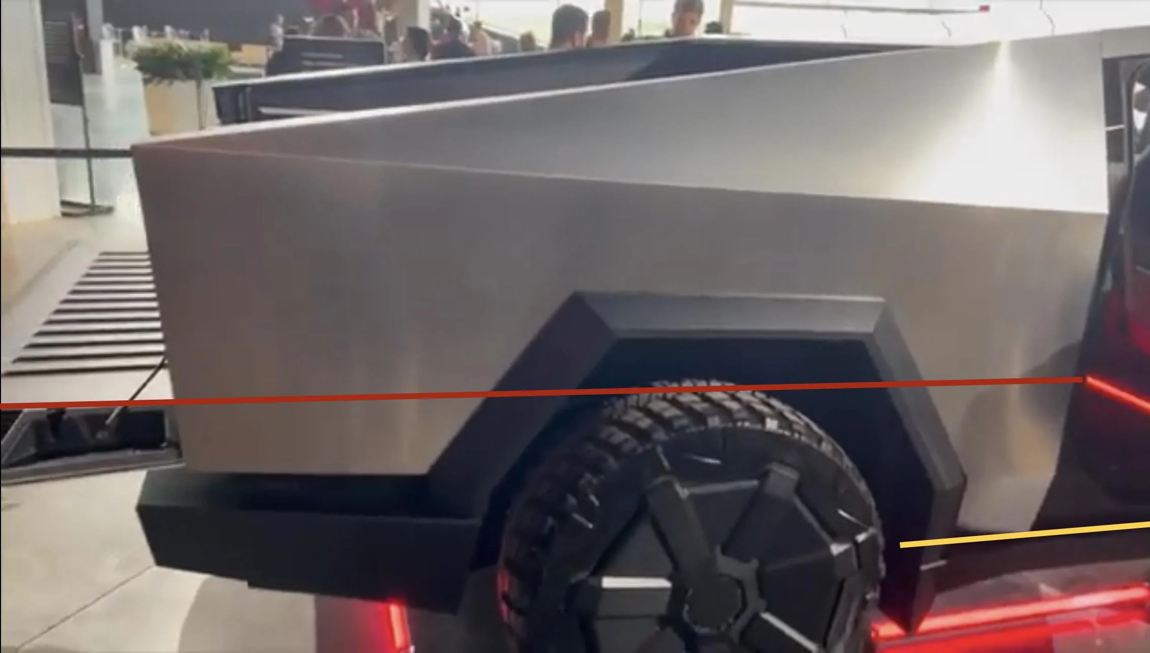

not ideal vantage, but:
as the pack is below floorboard of the cabin (yellow line), there’s quite a big of room above it before at vault floor level
It does look like there is some space there. I might of just overestimated the size of the vault roll. I haven't modelled that part. Is the pack really that low and under the yellow line? Because that would be good for the rear seat height too.
