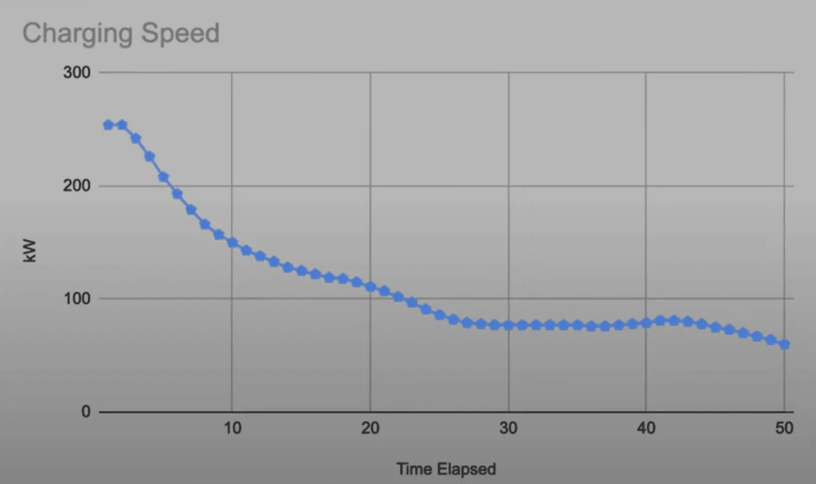

Will believe it when I see it, considering it ramps so quickly at a 250kw sc. what are we going to get, 350kw for a minute, then 250kw for a few minutes and on down the charging curve.

At this point it basically matches the model x and model s plaid charge curve. Not great for having an additional 25kwh battery size in their newest flagship product, and consuming what, 30% more energy? I really miss that 500mile range that was promised. Even an additional 20-30kwh under the bed would give it that much better charge curve without sacrificing highway range much at all ?

Ok, extrapolating from the charge curve. “Likely cannot”.
I can’t wait for someone to get a cybertruck to a proper v4 800v sc and see the charge curve. Anyways, peak rate is meaningless if it drops off after a few minutes, like the curve shown. It cannot sustain. Hopefully it’s a software issue and can be fixed as Tesla gains data on the new batteries and charging system, proving the cooling can keep them cool, but for every battery there’s a peak c rate that you can’t go over, and charge rate can only increase by adding more cells and thus capacity.

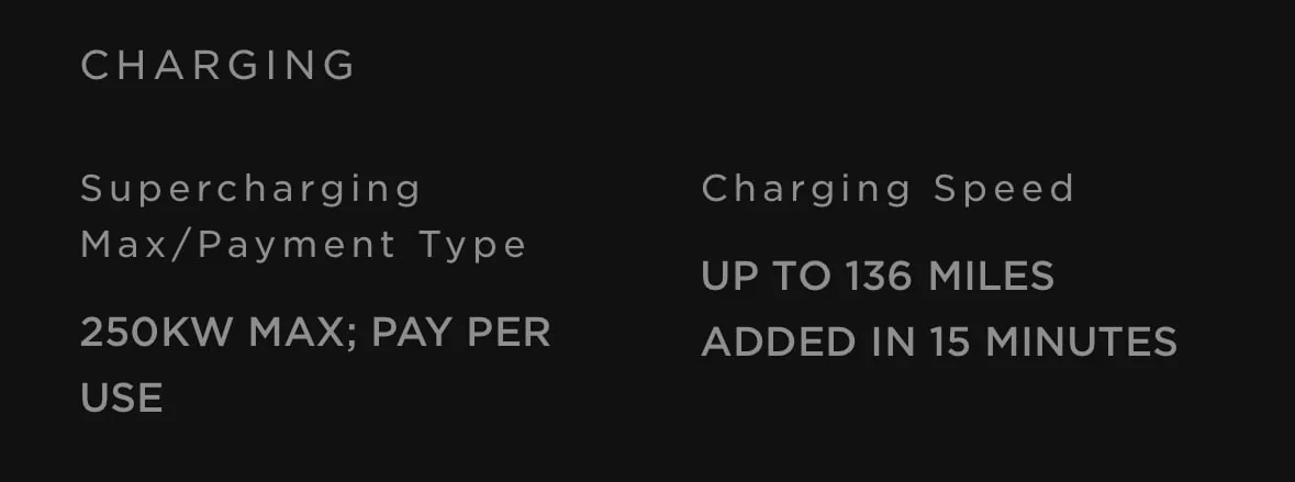

With a reasonable extrapolation, this charging curve meets Tesla’s stated charge rate spec of 136 mi in 15 min for the DM CT.

136 mi is 40% of the 340 mi total range. It should be able to charge from 0 to 40% in 15 minutes.
With a reasonable ramp up to 250 kW from 0%, maintaining 250kW until 20% and tapering to 150kW at 40% SOC should take a little under 15 minutes. It might even be able to go from 5 to 45% in 15 minutes.

People don't realize that there are like three V4 chargers, so pretty much a non-factor.
Hopefully the really poor charge curves we are seeing currently on the CT will be fixed with software in the next week or two.
Because the truck needs either good range, or good charging, both would be nice but it CAN NOT miss on both and we all know 500+ miles of range is long gone, so a lot is resting on charging speed.

With a reasonable extrapolation, this charging curve meets Tesla’s stated charge rate spec of 138 mi in 15 min for the DM CT.
@Gigahorse if you're referring to the post above yours. That's at v3

Yea all the #s we have so far are from V3s and V2s but 90% are V3s, the curve currently looks really bad but hopefully will improve in the next day or two with some software pushes.

We haven't seen a 0-40% run. So he may not be wrong. Also, could need more preconditioning. Can't judge now

Yea, that one had a good 20+ mins of preconditioning, not sharing voltage at a charger, etc.
0-40 I am sure will look better but personally think if numbers from 90-100 should be thrown out because "who charges to 100!?!?!" that sub 10% should be also, because do you really want to be under 10% that often?

Back in the plan your own trip days. We would try to get to superchargers as low as possible. 90-100 takes forever to charge. 0-10 doesn't. That's why we throw top out.
But bottom can be bad too if it's cold
