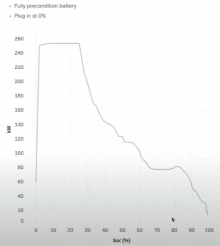

Exactly the same happened when the first 4680 Y's came out, but don't remember folks still freaking out about Model Y charge curves.
Yes, they did and still are ... this is a tech guy and has written a lot about it.
Branden Flasch who works in the charger industry has a Model Y 4680 and has been none-to-pleased with the charging.
Example Dec 23, 2023:
Tesla Cybertruck Cybertruck Charging Curve (Recorded by Owner) OxG02FO

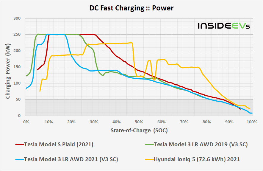

Why we are excited to see a v4 charging curve, since v3 plus cybertruck is worse than rivian and has the same taper as a model s/x plaid, which means if falls off 250kw FAST. If it wasn’t the cells limiting the charge rate, regardless of 400v vs 800v charger, we should theoretically see the cybertruck sustain that max 250kw rate much longer than a model s/x.
Plaid actually has the best charge curve of any Tesla right now
Tesla Cybertruck Cybertruck Charging Curve (Recorded by Owner) 1704043819265

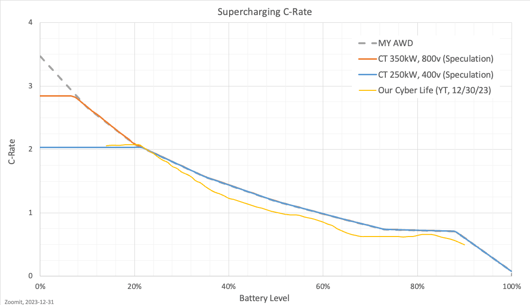

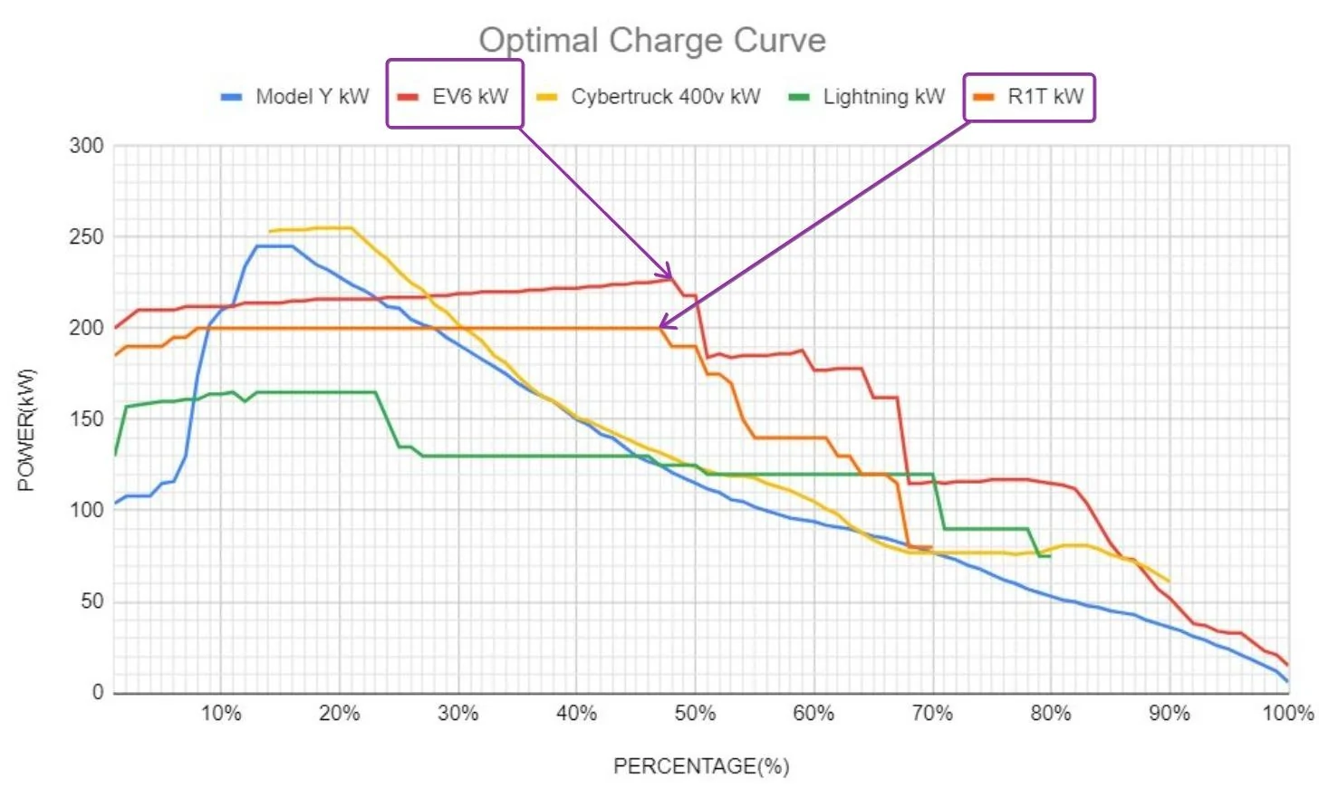

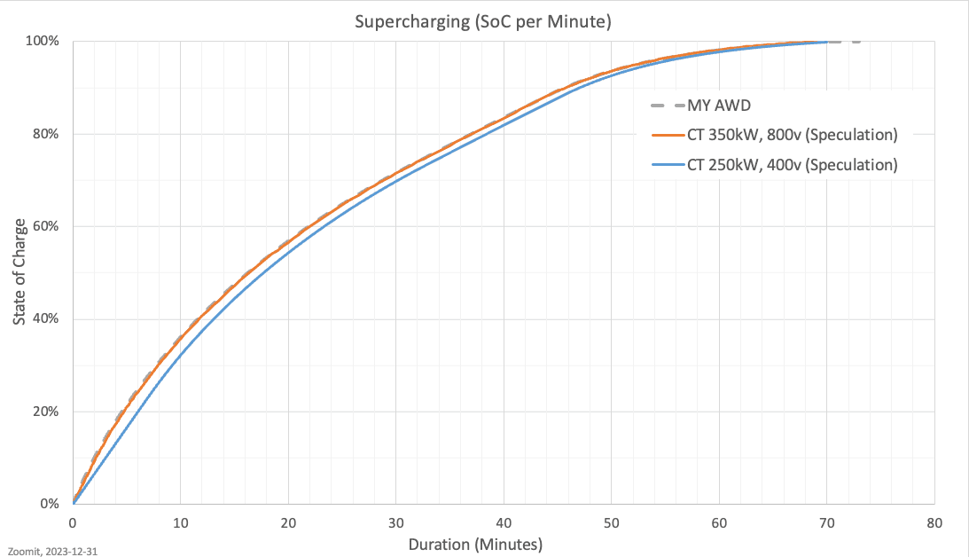

As well stated by @JBee, 800v charging does not significantly improve charging speed over 400v when the charge power is cell limited. I think that is what we're seeing now with the 4680 Cybercells in the Cybertruck for a majority of the charging curve. The reason why I think it's cell limited is that Tesla appears to be using basically the same charging profile (e.g. curve) as the 4680 Model Y AWD. The two curves look very similar when adjusted for pack size using C-rate as a reference.
If that is the case, I expect we'll see more real-world charging data that is similar to the Our Cyber Life video, though possibly with relatively minor improvements if low cell temps or station capacity were constraints. Just to state it again, this also means that 800v charging would not provide anything more than a very minor increase in charging performance, and only when started at very low SoC.
I created a charging model (overlayed gray dashed line below) based on the demonstrated Model Y 4680 charging power from Branden Flasch and extrapolated that to the CT pack size. Results are below.
Obviously I'm speculating, but until Tesla improves the charging curve, don't expect significantly faster charging than what's already been shown at either 400v or 800v stations.
Tesla Cybertruck Cybertruck Charging Curve (Recorded by Owner) Screenshot 2023-12-31 at 11.14.57 AM (2)
Tesla Cybertruck Cybertruck Charging Curve (Recorded by Owner) Screenshot 2023-12-31 at 11.03.54 AM (2)
Tesla Cybertruck Cybertruck Charging Curve (Recorded by Owner) Screenshot 2023-12-31 at 11.03.52 AM (2)
Tesla Cybertruck Cybertruck Charging Curve (Recorded by Owner) Screenshot 2023-12-31 at 11.45.22 AM (2)

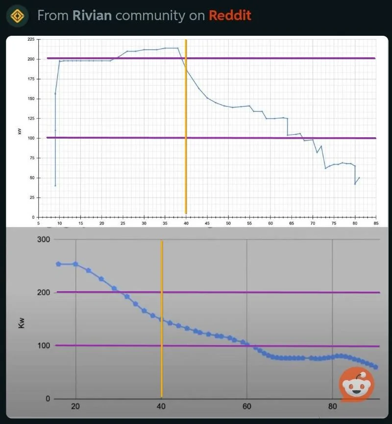

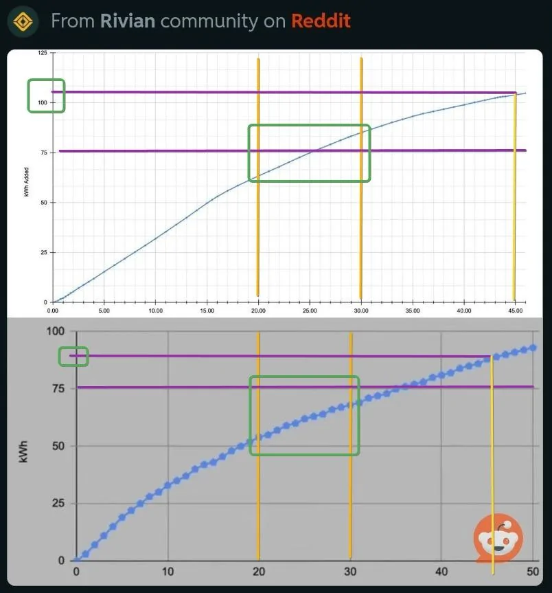

76% battery aka 93kW took over 50mins - charge to go from 14-90%
Of that 50mins only 19 of it was 250kwh - really low high charging speed for such a large battery
With current usage stats that is 50mins of charging for 143 mins of driving - aka a lot of travel time on a trip would be charging
All of that unfortunately aligns with data on charge times coming from other people posting info, which is not good.
Oh yea and this was with a preconditioned battery with outside weather of 73 F about perfect conditions......
It's obvious to me that the open tonneau and tailgate affected the dynamics of charging speeds. Moral to the story: Keep my Vault SHUT....._/

Not really buying that excuse as they have had 4680 in TMYs for a while and certainly have a ton of data on charging them. I would have expected better especially with Tesla knowing how the CT would be compared the existing EV trucks out there (Rivian, F150 lightning)
Rivian comparison:
Agree, precedent with 4680 MY does not inspire confidence, charging curve has yet to improve on that and we're almost two years in. This could seriously dampen demand, you can't have both range and charging be underwhelming.
At this point it basically matches the model x and model s plaid charge curve. Not great for having an additional 25kwh battery size in their newest flagship product, and consuming what, 30% more energy? I really miss that 500mile range that was promised. Even an additional 20-30kwh under the bed would give it that much better charge curve without sacrificing highway range much at all ?
It's way off S/X refresh, those hold 250kW to over 30%.

Here're updated graphs with Ryan Shaw's charging data from his YouTube review (at 11:00).
Tesla Cybertruck Cybertruck Charging Curve (Recorded by Owner) screenshot-2024-01-06-at-9-41-02%E2%80%AFam-2-
Tesla Cybertruck Cybertruck Charging Curve (Recorded by Owner) screenshot-2024-01-06-at-9-41-07%E2%80%AFam-2-
Both these charging sessions overlap remarkably well. Therefore,
  1. This builds my confidence that this charge curve represents an optimal charge session for today's hardware and software configuration.
  2. The current Gen 2.3 cell charge curve c-rate is less than the Gen 1 curve from the Model Y AWD.
  3. My speculative V3 and V4 charge curves as shown are likely too optimistic.
  4. This lends credance to my theory that the battery thermal management system has a lot of untapped potential and can support much higher charge power.
