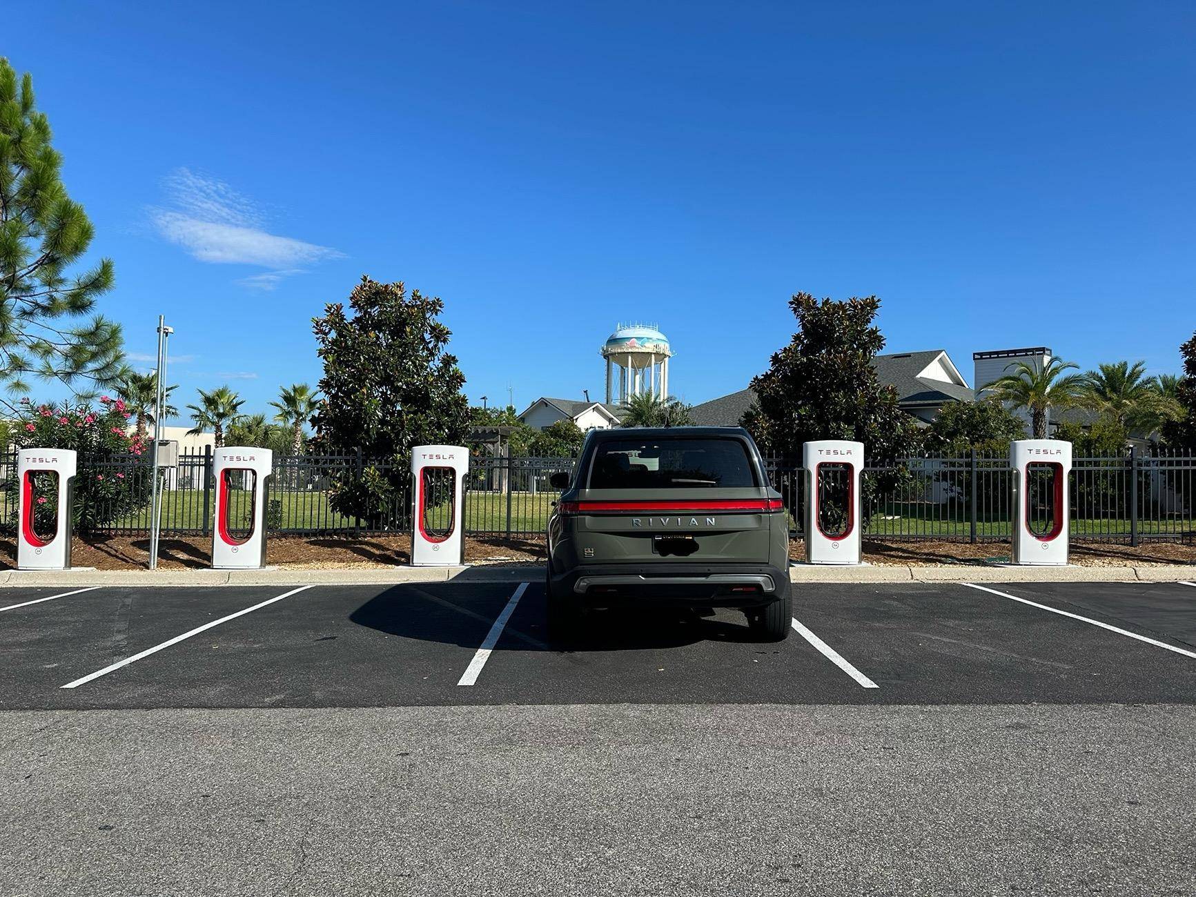

I am assuming that is this NACS extension cord is intended for people with boats and trailers, since otherwise you can just back up to the charger cable.
The bigger issues is Ford, Chevy, Rivian vehicles (plus others as they gain access to Superchargers) with the charge port in a location (front/driver side) not ideal for Tesla Supercharger location.
One easy solution is--as some Superchargers parking lines are configured--Supercharger is in the middle of the parking spot. Example: https://www.rivianforums.com/forum/...9-ft-2-3-meters-coming-soon.33007/post-617176

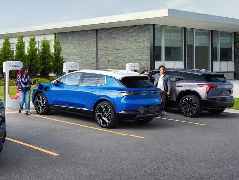

And from a problem standpoint, look at the blocked Superchargers:
https://electrek.co/2024/09/18/gm-r...-adapter-givingaccess-tesla-charging-network/
The solution is GM, Ford, Rivian, etc. assist with funding Supercharger V4 rollout. Plus Supercharger lane marking as pictured above. And industry standardization around driver/rear or passenger/front charge port location. This horse been beaten enuf already!
