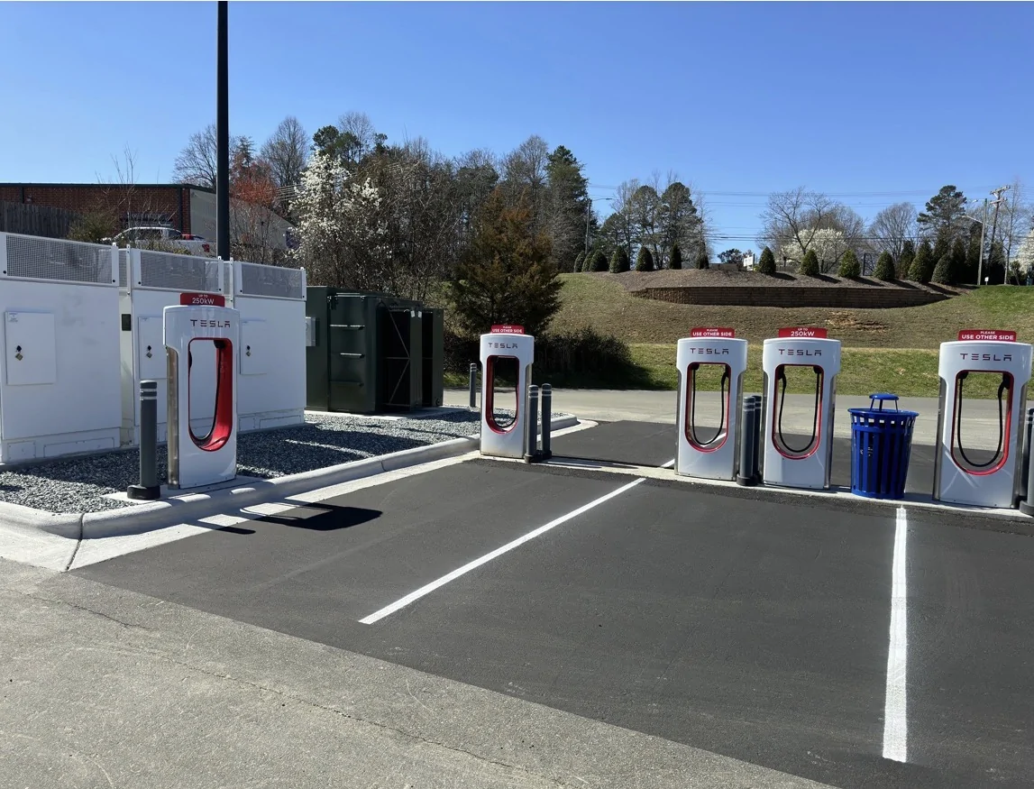

Almost very supercharger i frequent now has at least one. It’s a regular spot except instead of the charger being at the back of the spot it’s right across from the charge port when parked. Something like this you pull into forwards.

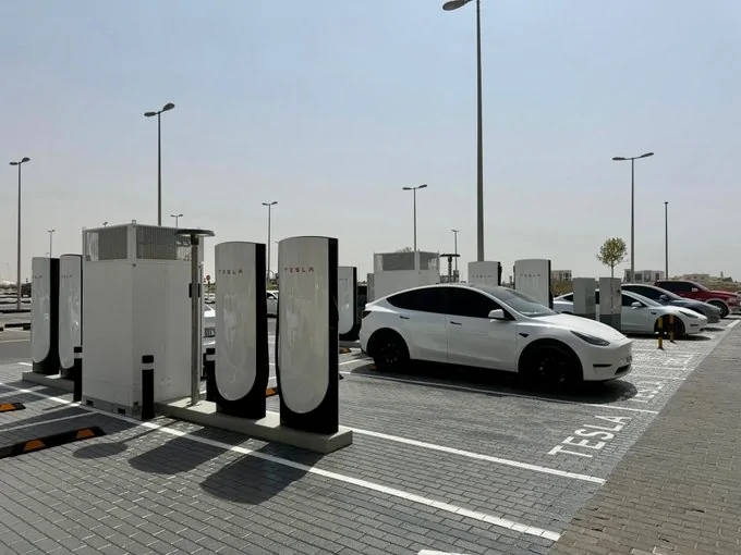

Good point. I have seen the one special stall. I was thinking more of Euro? style where all the stalls have side chargers.

if you have something mounted in the hitch like a bike rack, or shelf or spare tire, etc - unless th SCs are arranged so that the thing in the hitch fits between them like this:
Tesla Cybertruck NACS extension cord for Superchargers IMG_0590
and there are definitely some that wont allow for this, then you either have to wait for a pull into/through slot or take up a bunch of spots, or demount your hitch jawn.
and then theres the rest of the world that now able to use our charging infrastructure - their ports are all over the place.
an extension although presently unsafe will be useful for those cases. or maybe they can just lenghten all the cords - which yeah youmight have heat issues still.
