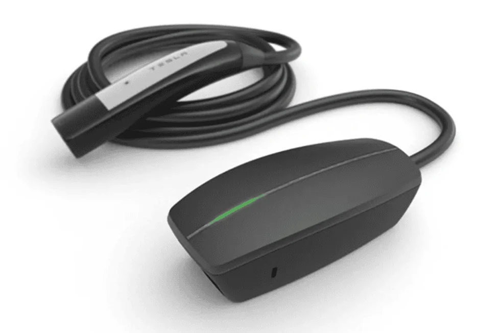

Anyone have a PSMC go bad? I had an electrician install a 14-50 in my garage and was using the Powershare Mobile Connector that came with the truck to charge daily at 32 amps until the last Friday when I was trying to charge up to 100% for a long trip and just happened to notice that my charging amps had reduced to 6A. The only option I had in the app was to reduce it to 5A - it couldn’t go higher than 6A in the app. I noticed when I walked down to the garage that the green lights would stream down to the end where they would end with a red light. I unplugged it from the truck, then unplugged it from the wall, waited 10s or so, and then plugged it back into the wall and then back into the truck, and at first it started charging normally (green streaming & 32A) but after 30s or so the red light came back and amps reduced to 6A. Since then the PSMC has never charged over 6A again, but the truck has charged fine at a couple Superchargers.
The Manual says that a single blinking red indicates a heat issue at the connection to the truck, but if I unplug the PSMC from the wall for a couple minutes and then plug it back in, it has the red light before I even plug it into the truck, so it doesn’t seem like the problem is heat at the truck end.
I tried the 3-prong connector and that gets the red light too, so I suspect the PSMC is bad, and I don’t see any way to reset it, so thinking I just need to get it replaced.
Given that this is my first Tesla, and I’ve never had luck calling Tesla or messaging them in the app, I’m assuming I need to just drive to a Service Center and ask for a new one, but does anyone have a better idea?
Thanks in advance for any wisdom you can share!

Sounds like a mobile connector failure. Could make a service request in the app and/or stop by your local service center.
