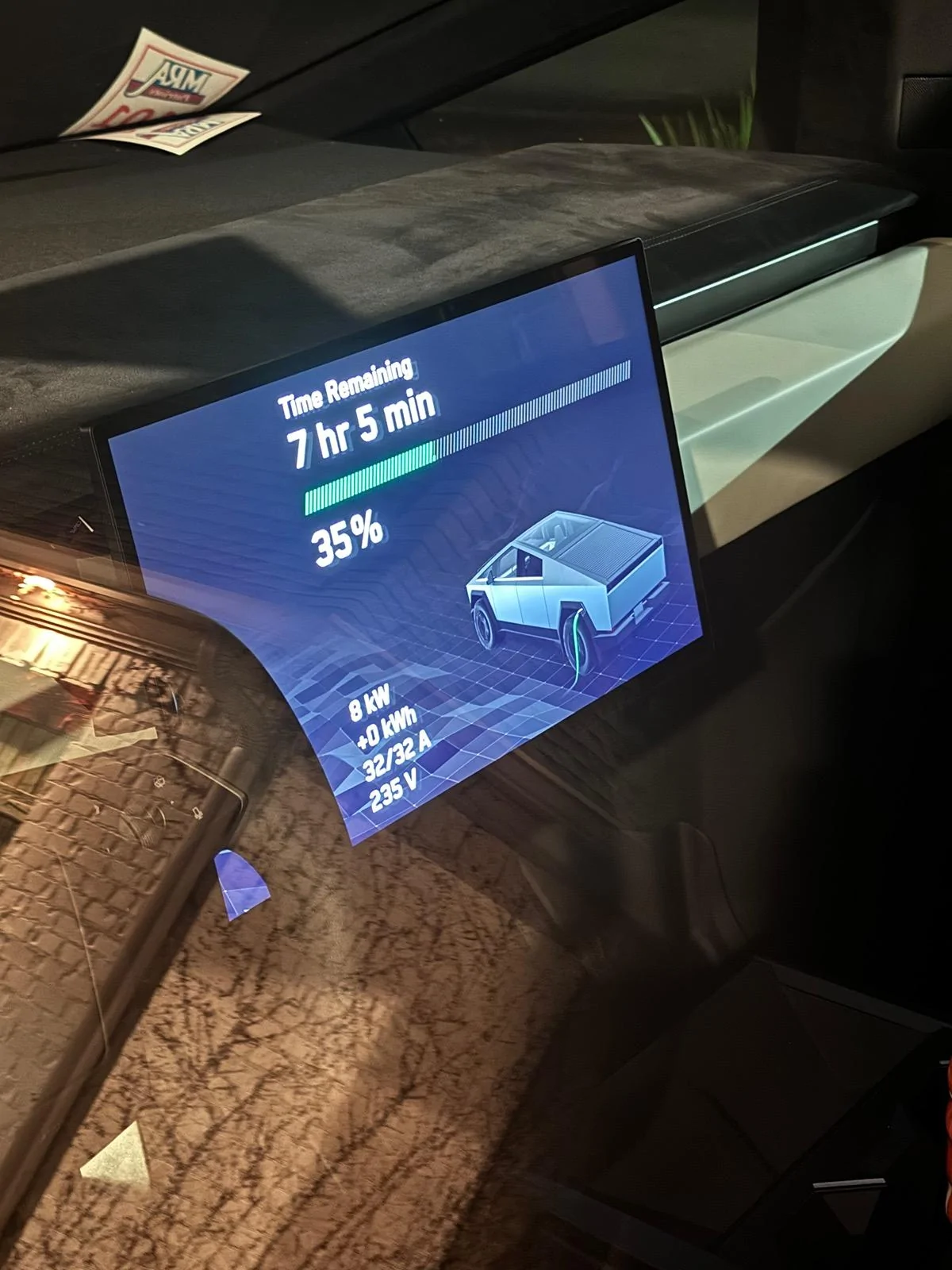

My problem is using 14-50 adaptor come with the truck only gives me 6A on a 50A outlet. Use my friend’s gen 2 MC with gen 2 14-50 adaptor can go up to 32A, but as soon as I used my own 14-50 adapter on his gen 2 MC, the charge back to 6A again. Then we tested use my gen 3 MC with his gen 2 14-50 adapter, it works up to 32A again. Is there something wrong on the adapter itself? Very strange.
Tesla Cybertruck PowerShare Mobile Connector (Gen 3) -- Discussion IMG_2325
that is odd. This is what I get when using my 14-50 adapter that came with the truck when using a 14–30 to 14–50 Y adapter connected to my dryer plug (14-30) in my house. I would definitely ask Tesla to replace yours.
May 27, 2024
4,540
5,526
Pulling 32A from a 30A outlet is a bad idea. You should set your charge current to 24A or less.
Huh, yeah that's no good and strange. That's when I was using the 14-50 adaptor. I have since changed it to the 14-30 adaptor using all 14-30 cables and it now defaults to 24A. I figured it was all automatic and would pull whatever is available (and safe) but I guess not. I'm still very new to this. ?
May 27, 2024
4,540
5,526
It is automatic in that the MC sets the maximum charge current based on the connected adapter. In this case it had a 14-50 which can handle 50A*80%=40A, but the MC itself is limited to 32A max.
The 14-30 adapter sets the unit to 30A*80%=24A.

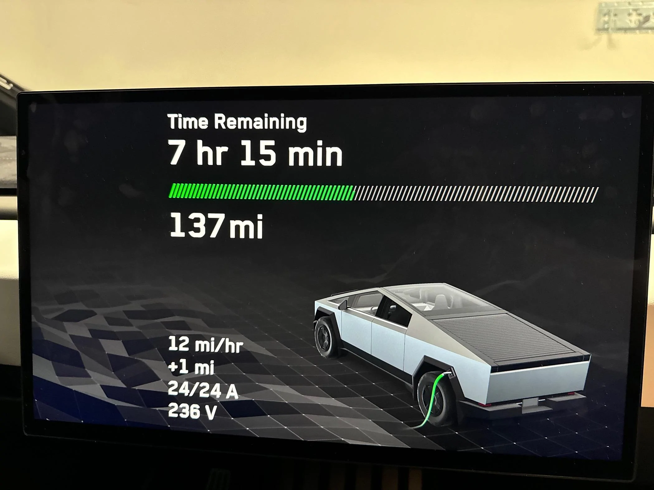

Since my house is for sale I'm not going to spend $2000-$4000 for the wall mounted solution/powershare so this is the solution I'm using for now.
1 Nema 14-30 splitter connected to my dryer plug in laundry room:
https://a.co/d/0DtoG0o
1 25' Nema 14-30 extension cord:
https://a.co/d/hCqmv0k
1 Tesla Gen II 14-30 adaptor (as seen in other post)
1 hole in laundry room wall... ?
Entire setup was only $200 and charges at 24 amp, 12/13 mi/hr, 236v
