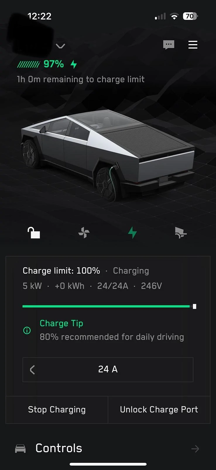

Update from OP:
Received the Tesla 10-30 adapter today, had a road trip starting after work this weekend, not far-100mi or so-but going to have limited charging where we will be til Sunday.
Juiced up to 90% at a supercharging station last night, and figured overnight the 110v would trickle it to 100%. Big dreams…cut the charging at 97% about 11am today and left work early to plug that bitch in with the 10-30 to the now-corrected circuit.
As expected, she’s up and juicing properly now.
Tesla Cybertruck PowerShare Mobile Connector (Gen 3) -- Discussion IMG_8665
Still feel like a dumbass, but also still glad my stupidity led to this thread.
