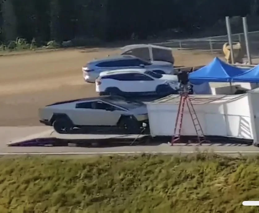

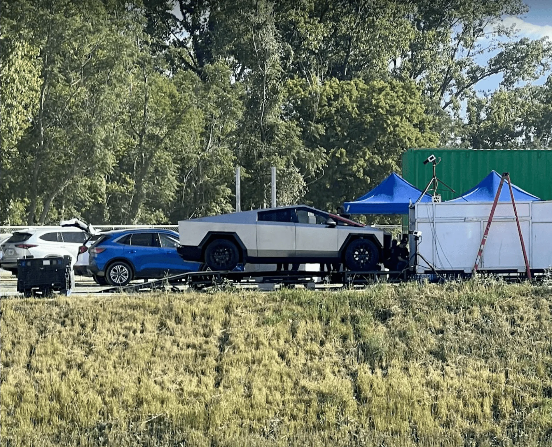

It’s not technically a wind tunnel. I would call it a semi-controlled airflow simulator. A wind tunnel is: (1) a tunnel, (2) generally closed, (3) the airflow is highly controlled, and (4) the device is highly instrumented. The facility at Giga Austin is a mobile unit to get ad hoc measurements at manufacturing facilities rather than sending them out to a real wind tunnel. They need not be accurate as they are intended for manufacturing tweaks.
not quite
but not for aerodynamics, and instead for wind acoustics (eg testing cabin noise)!
https://media.ford.com/content/ford...ld-first-mobile-aeroacoustic-wind-tunnel.html
Which would explain also the turntable: unlike aero drag tunnels (need head-on wind only), to test wind acoustics in the cabin you’d want to know whether any external vehicle features “pick up” cross-winds to create audible nuisance
for Ford, apparently they use it in early/pre-production design phase: “sources of unwanted wind noise in early production vehicles to be identified faster and solutions developed sooner”
also explains the smoke, and why it can be done outdoors (sensors are in the cabin)

I wonder if this kind of test is good for a general overall real life drag coefficient.
see above
It’s not for aerodynamics
It’s for aeroacoustics
It can be outdoors and in this setup because they’re testing for whether cabin noise is generated by air across its envelope.
Which is also why it’s on a turntable:
Tesla Cybertruck Cybertruck Spotted in Wind Tunnel / Airflow Simulator at Giga Texas (4.12.23) FCE7760E-0746-4D78-A868-B02D79CBE2F9
Unlike with aerodynamics, with aeroacoustics you need to check if winds from any directions create cab noise
Like if a side gust of wind causes the BAW to suddenly start whistling the song of the @CyberGus
Or if a gust from the rear makes the CT giggle

see above
