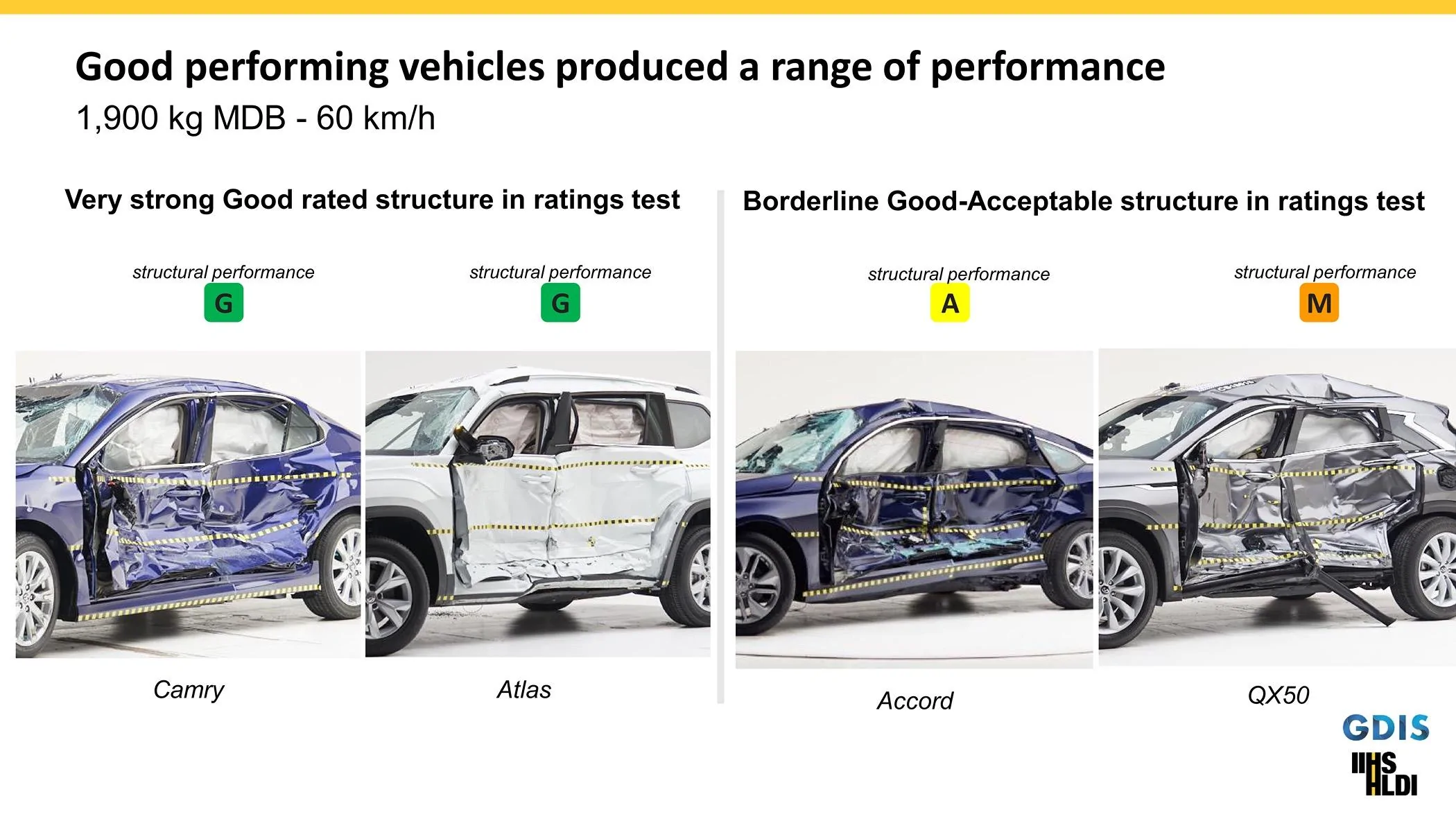

You want to flip over? This performed perfectly, the doors absorbed the crash. And because it's so stiff and strong, the frame looks straight still, while most vehicles fold in half from side impacts.
Amazing that the ford edge (how did people get the idea it was a tacoma/tundra?) looks like it ran straight into a wall. Look at other side impact tests, and the vehicles rip right through each other.
So looking it up, there's a 2,300 lb weight difference with the edge(4500) and the ct(6800).
Side tests are tested with a ~3K lbs dummy (regardless of class).
Head on crashes are tested @ 35mph to an immovable object.

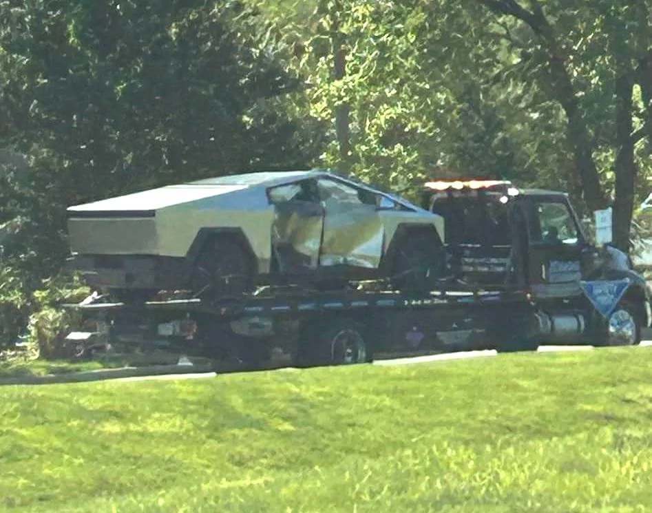

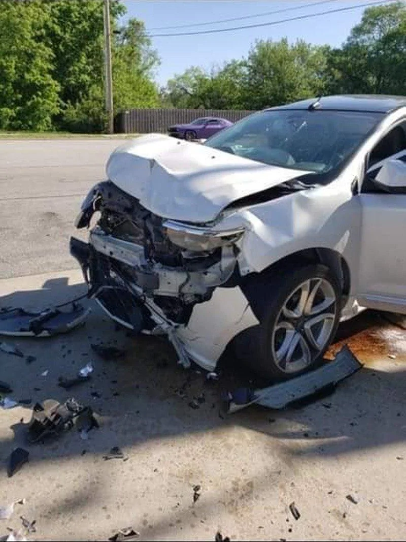

Is it just me, or it seems the CT did pretty poorly actually, compared to side crash tests of other Teslas and Rivian, where there is barely any penetration in such situation?
Cybertruck owner/driver was ok.
As I mentioned in my previous post, it appears that the airbag in the other vehicle did not deploy during the incident. It is concerning to consider the potential injuries that could have been sustained by passengers in the backseat of the Cybertruck, given the significant intrusion observed.

Curious where this happened so we can get a look at the road layout, I went through the original FB post, but there's no clues there. The photos are not wide enough for any of the location services to find it with any level of confidence.
Everyone walked away from what was obviously a collision of significant speed, so both vehicles did their job. It is curious why there appears to be no airbag deployment in the Edge though.

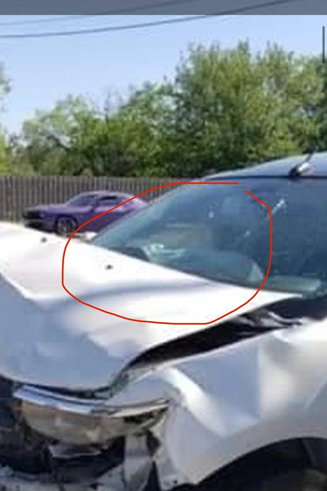

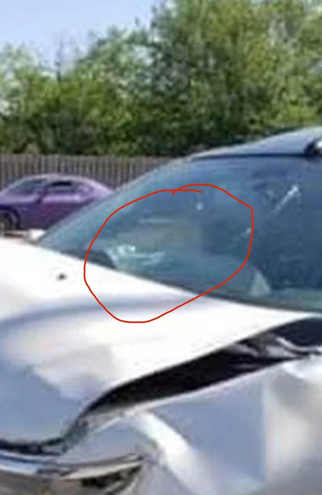

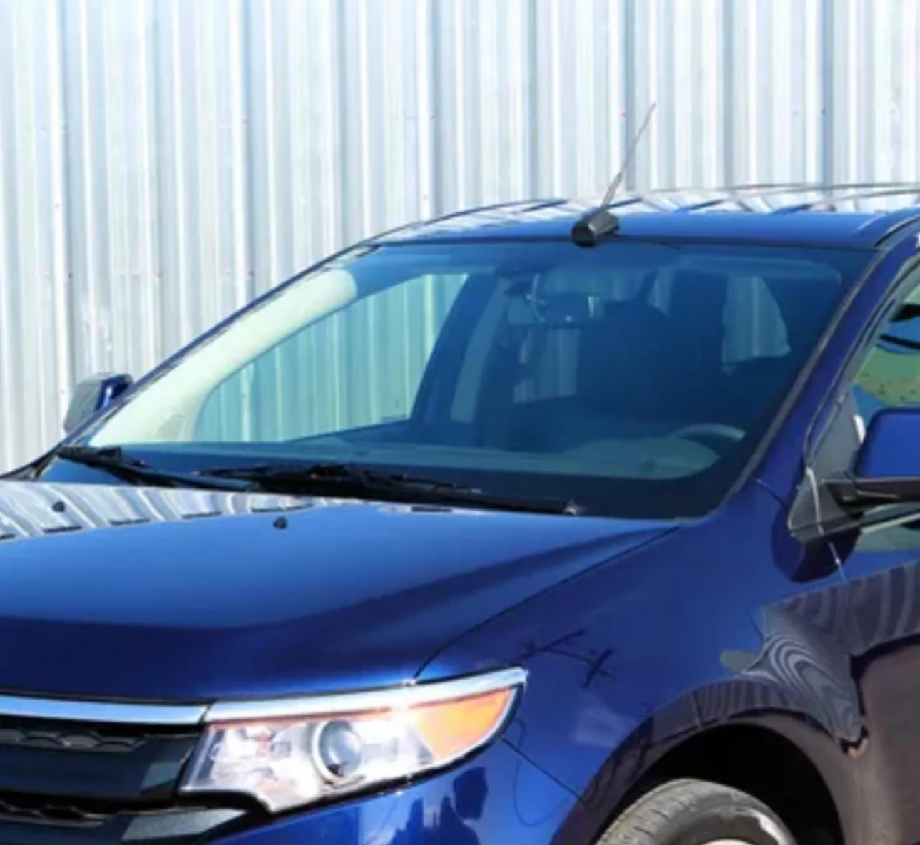

Why are you assuming this? Of course the airbag went off unless the sensor was defective. You can’t see very well due to the bad quality photo, but here’s a stock edge vs the crashed one- appears the passenger bag blew up in the dash, and the steering wheel bag isn’t visible in the photo angle.
You and I have different definitions of "significant".
You can't outrun inertia. If the side was 2-inch plate steel, an impact would have put 100% of the energy into moving the vehicle sideways, instead of crumpling to absorb it. The occupants would get hit by the 2-inch steel plate at 50 MPH, even if it didn't bend at all.
Side-impact design must balance between energy-absorption (crumple) and energy transfer (stiffness). The side-impact airbag mitigates both.

I think CT did extremely well in this crash. If you look at the ditch CT picture, you can see there is a big gap between the outside panel and inside panel. so it is very likely that the impact didn't go though the insider panel. the Ford does look like it hit a wall.

The details are in a Facebook group from KC here: Kansas City Car Spotters | It was only a matter of time | Facebook
The daughter of the owner said there was no intrusion into the cabin either in the front or rear that the doors took the punishment but didn't cave into the cabin. Owner had minor injuries from airbag deployment and shock of impact. Car is at Tesla collision center in KC, feel free to contact the individuals involved if you need more info via that Facebook thread.
Impact speed was estimated between 45-50 mph, Cybertruck withstood the punishment, the offending vehicle and it's iron block were repelled with prejudice. Cybertruck did excellent here.

So this real world side impact crash might have involved forces about twice the standard test done by IIHS.
The extra forces are due to much higher impact speed (impact speed estimated 45-50 mph vs test 31.1 mi/h) and much higher weight ( weight of 2014 Ford Edge trim? + driver + passengers? + luggage/cargo + fuel in tank vs test 3,307 lbs )

liked the analysis guys, we see intrusion into the CT, but the doors are very thick/deep for further impact space
