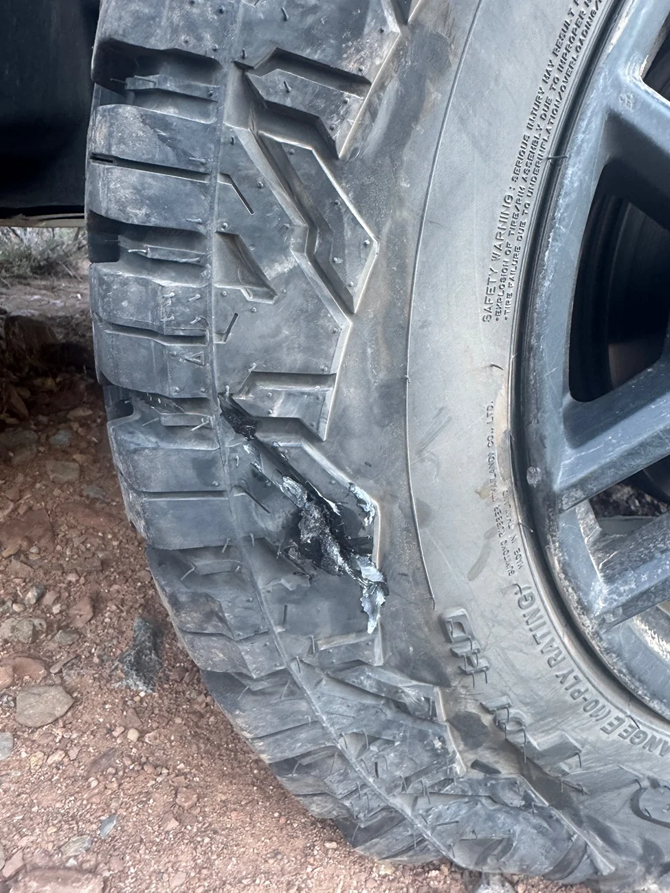

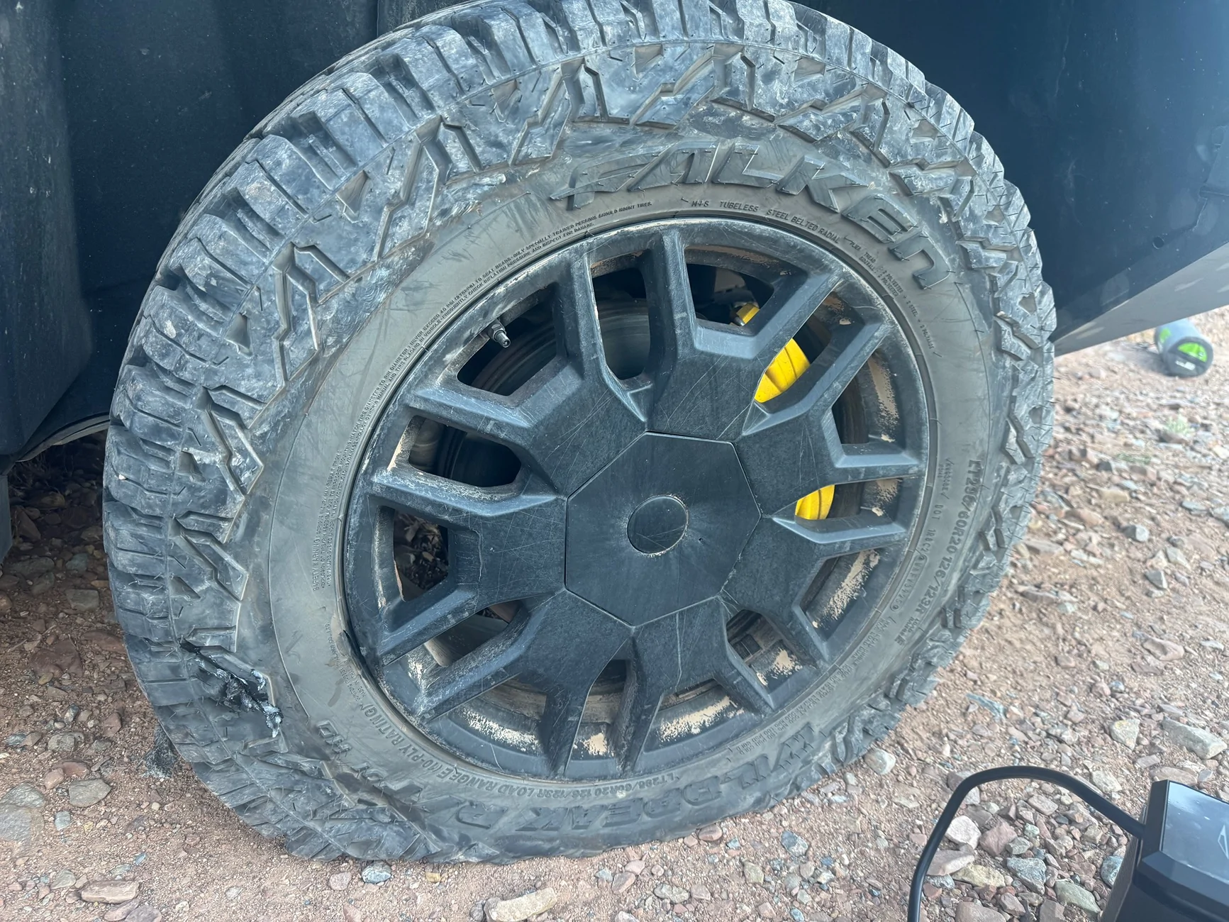

Two weeks ago, Spring Mountains, SW of Vegas, OnX level 5: I clearly didn’t know where my left rear tire was, or whatever tf gave it this brutal, unpatchable puncture.
There was also a secondary deep slice by the rim, presumably executed by the rim…
Plugging fail. Patching fail. Tesla spare tire and jack (and pump) for the win.

Ouch! I've seen a big spike in sidewall cuts in the last couple of decades, ever since many people started routinely airing down well below what is required (or advisable) for the technical difficulty of the trail and the loaded vehicle weight. The more weight you pack (including spare wheel/tire/jack, etc), the less you should air down. Trust me, you don't need really low pressures for most stuff, just know where your tires are and pick good lines. I still don't understand this fetish with airing down below what is necessary to safely complete whatever terrain you're looking at. I think people are afraid of failing miserably if they don't air down enough. Which of course leads to unnecessary sidewall tire cuts. Or maybe they don't know how much to air down so they listen to people who want to sound like they know what they are talking about so they just quote some low numbers because it makes them sound hardcore and experienced. Some of these people get flat tires off-road all the time but apparently it's just part of the experience for them. If they aren't breaking things and failing, they are not having much fun. It's also possible they just haven't connected the dots yet (because they think it's always necessary to run lower pressures than really necessary)! In other words, they don't have any time with higher pressures to compare sidewall failure (cut) rates.
I don't like flats, even in a past life when I always carried a spare, so one of my goals is to complete the route without getting a flat. It's not that hard if you have the correct air pressure for the terrain challenges and loaded weight. Never go lower than you need to, especially if you are not travelling light. And relentlessly cut unnecessary weight. It all adds up and increases the chance of cuts and punctures. More importantly, pick lines that won't have your tires making slicing movements against sharp rocks. But it's still possible for shit to happen, even with skill and care, if the terrain is difficult enough. Plus, mistakes get made.
The part I don't understand is you had a sidewall cut and a spare tire and a jack but you thought you would try to plug it first, sidewall patch it second, and only use the spare if those two methods both failed? If I had decided to pack a spare and necessary tools, and I found myself in your shoes, I would have gone for the spare first (considering it was a pretty nasty sidewall cut and not a simple puncture). I'm guessing with that spare sitting on top of your bed topper, there wasn't much exigency to make the plugs (or the patch) work, the urgency or necessity simply didn't exist with that aired up spare staring down at you. I don't use patches, I think your best bet to fix it without the spare would have been with some creative plug use.
Of course, avoiding the sidewall cut to begin with is always preferable. It pays to get good at that.
Thanks for the constructive feedback. So, yeah the roof mounted tire isn’t a thing anymore, that was a short-lived experiment. My spare was in the truck bed, but it was covered in too much camping gear. It’s okay though, I’ve now got a little experience with my plug kit and the patch kit. I’m hella new to all this, so steep learning curve.
