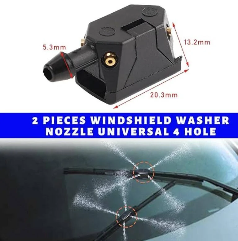

Had the Tesla mobile tech out to check the wiper assembly again as there was barely any water coming out. He replaced the wiper, made sure the pump was working, hose wasn't kinked, and fluid was flowing. He said a few of the nozzles were clogged but otherwise there was nothing to be done. He confirmed this is a known issue with most trucks in the cold. He was hoping that Tesla would replace the pumps with more powerful ones soon in all the trucks, that is the solution that is needed.
For me, driving in snow is bearable, and on local roads. When driving on highways when it's melting with salt hitting your windshield it becomes really hard. And when it's below zero it really becomes a nightmare.
Hopefully by next winter there is a solution, or I'm going to have to 3d print some mounts and put some old school sprayers on the hood and divert the hose from the wiper to these. Might still do it yet......
