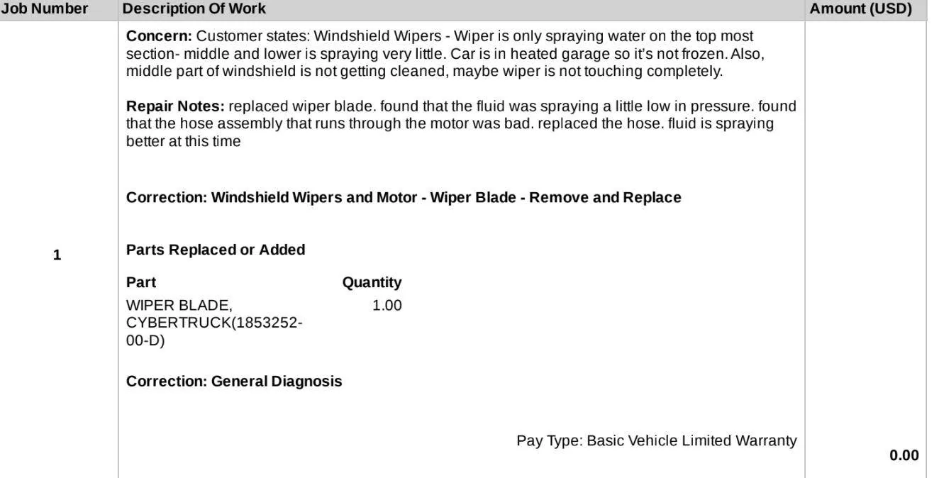

I had service done today, unfortunately I didn't have time to take video or photos before it got dark. The SC agent said that motor and wiper were replaced. However looking at the invoice, I'm not sure if motor was replaced. I was able to see that the jets are spraying a bit further out than before and I see more fluid. You guys tell me what you think based on this:
