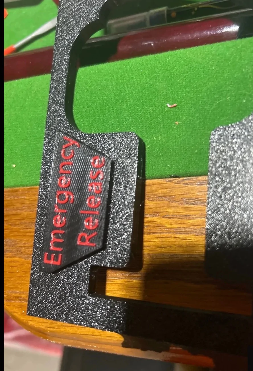

If I had a multicolor printer I could do colors like you and what is design has. I just started adding little plates with multicolor that glue on.

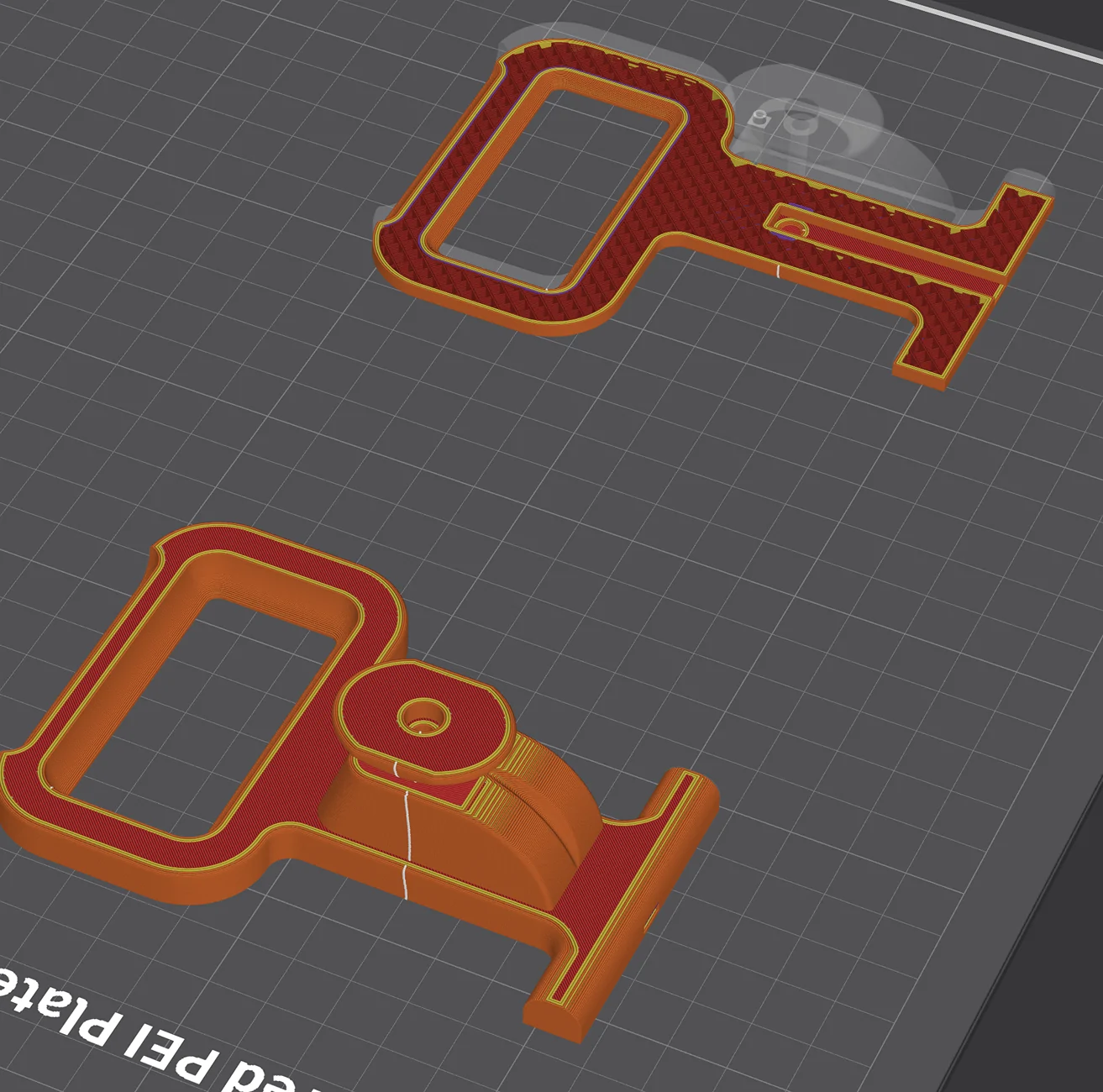

They were probably PLA is my guess
No, I printed them in Petg, it is a design flaw where the layers on the release handle are perpendicular to the force you apply. It is very fragile in that area - not to breaking but layer separation where it falls apart. Under an emergency situation, last thing you need is the lever snapping off. I'm at work now, but I'll take a pic when im home to illustrate what I'm talking about.

Ahhh ok yea if you can I’d love to see it
If you want to and if you can, send a pic of the actual pull handle from the side, I can show you where it
So the flaw is at this layer where it meets the handle - I took the pic off your site just to illustrate it for you, I'm in no way implying yours have the same flaw. However, I suspect the original designer knew it was a weak point as they put a hole for an M3 screw, but even with that, it would need some form of internal nut in the main body of the handle to not come apart.
Gonna take a good look when I get home tonight

Could it be due to layer height and infill? I'm printing at .20 and 15% infill and it is very strong.
