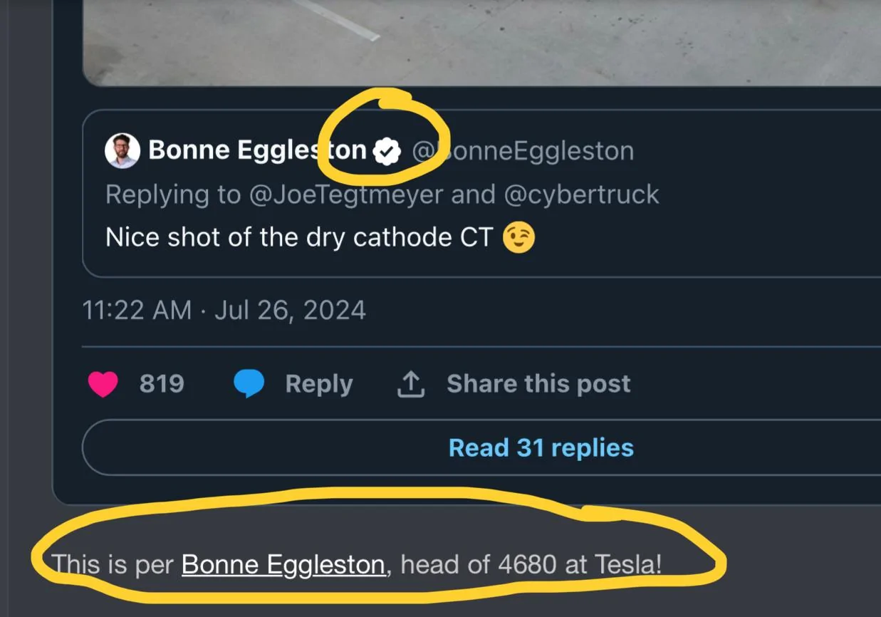

Sorry but how do we even know it’s a dry cathode cyber truck? Looks just like a regular cyber truck with a wrap. ?

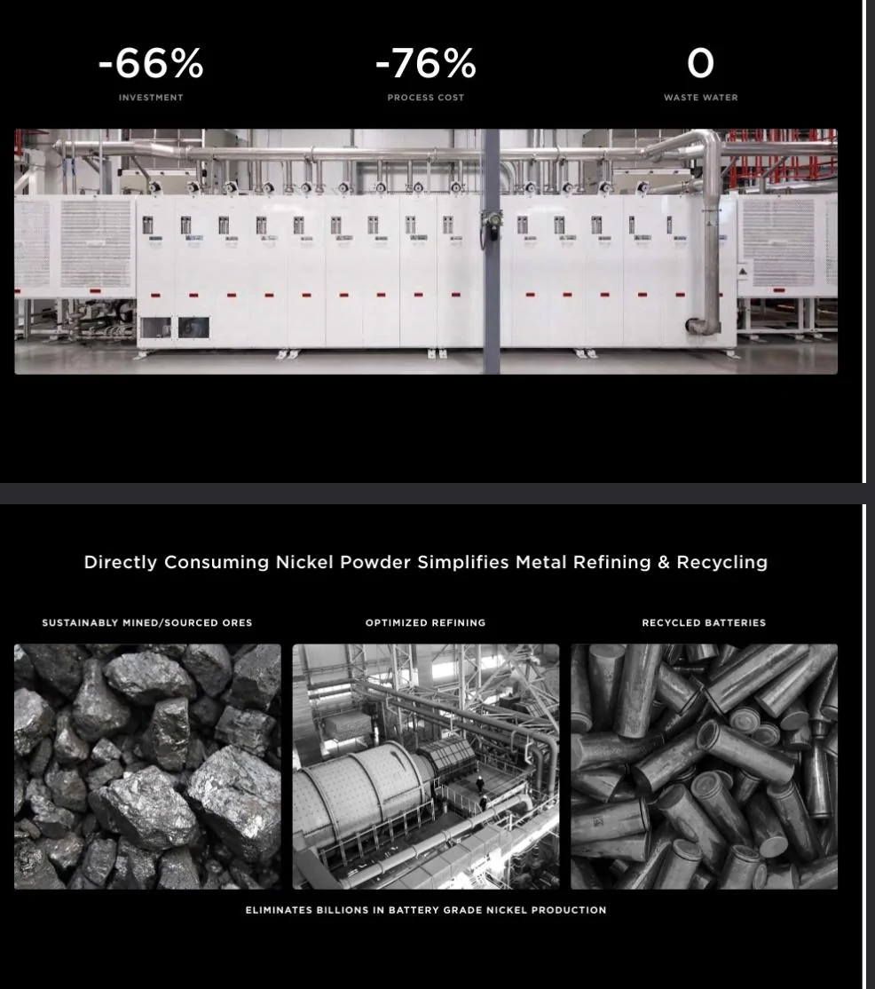

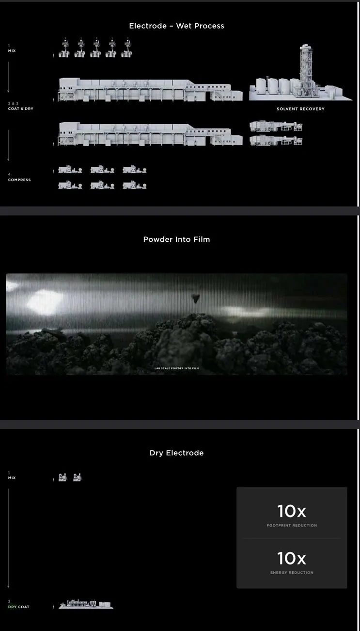

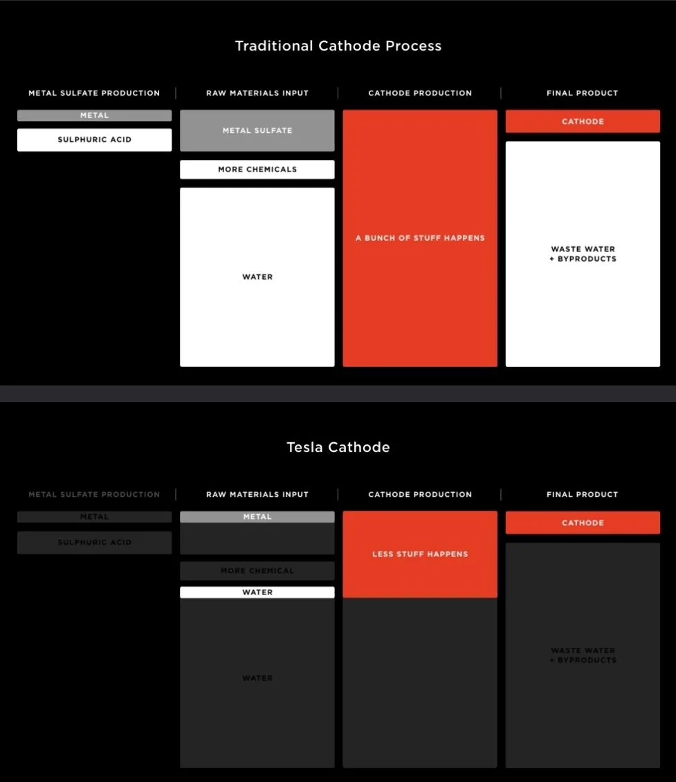

And alot alot less water, which is a sticking point at their current factory sites.
Clarification:
The cathode wet process uses a solvent which is reclaimed and recycled.
The new cathode electrode material generation process uses less water (zero net) due to skipping the nickel sulfate step, but that is independent from applying it to the metal foil.
Tesla Cybertruck First Dry Cathode Battery Process Cybertruck Spotted at GFTX! SmartSelect_20240727_180849_Firefox
Tesla Cybertruck First Dry Cathode Battery Process Cybertruck Spotted at GFTX! SmartSelect_20240727_180620_Firefox
Tesla Cybertruck First Dry Cathode Battery Process Cybertruck Spotted at GFTX! SmartSelect_20240727_180647_Firefox

Well that explains that! good to know for those that are not so involved with the topic. Thanks. ?
