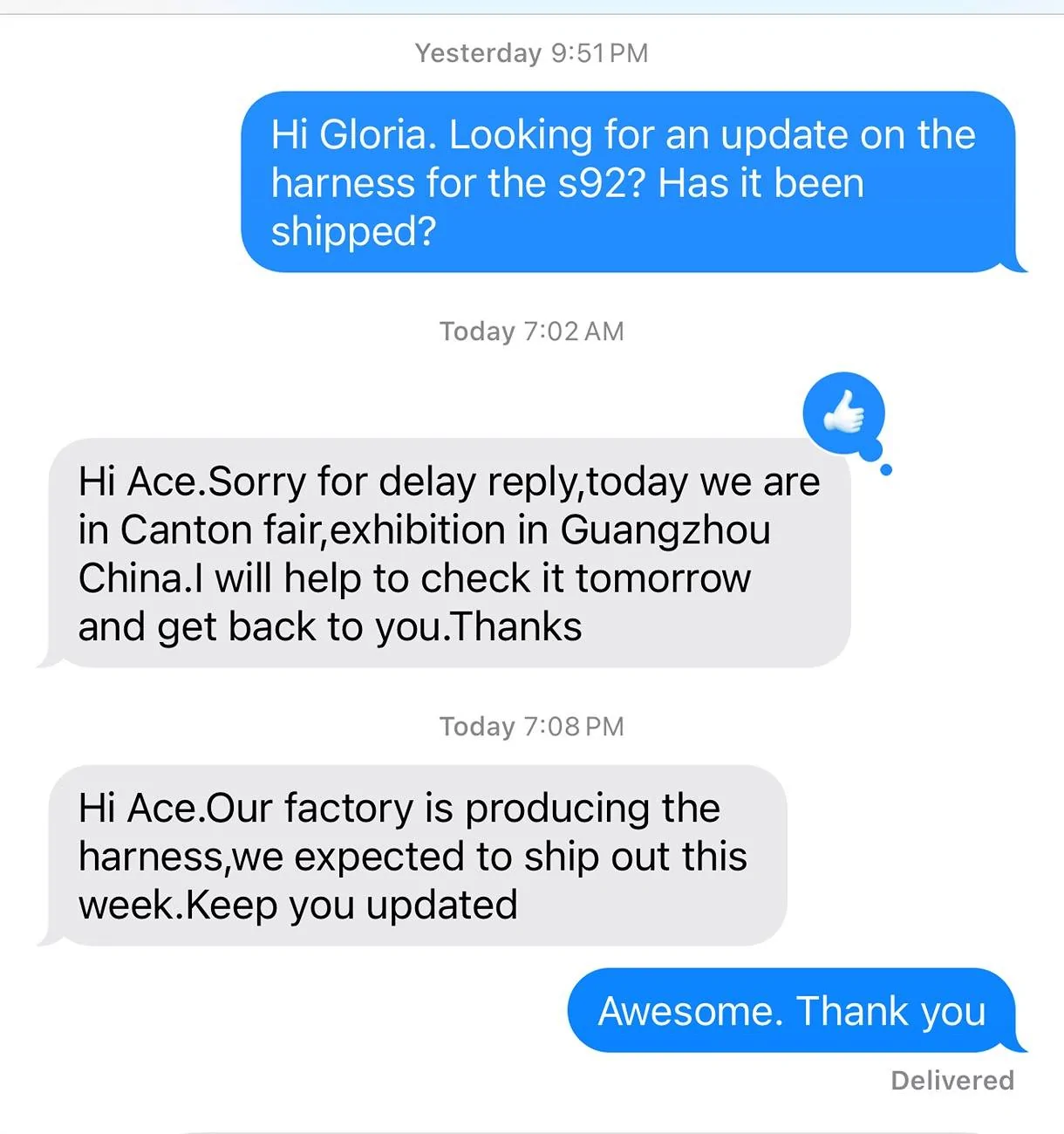

They got back to me yesterday, said there's a new batch being shipped soon.

Has anyone else get a communication for the new wire harness?
Nope. I’ve been ghosted by them. Is there a place on here where we can review Vendors because between Tesstudio and EVBase I’ve recieved a bunch of crap and very little/no support

This was their response from my inquiry on 4/28:
Thank you for following up.
Our team has developed the new power cable required to address the error message issue. However, we are currently in the process of testing the harness to ensure its stability and reliability before shipment.
Once the testing is successfully completed, we will arrange to send you the correct harness promptly. We truly appreciate your continued patience and understanding during this process.
Please don’t hesitate to reach out if you have any questions in the meantime.
Best regards,
Cherry
TES Studio Customer Service Team
