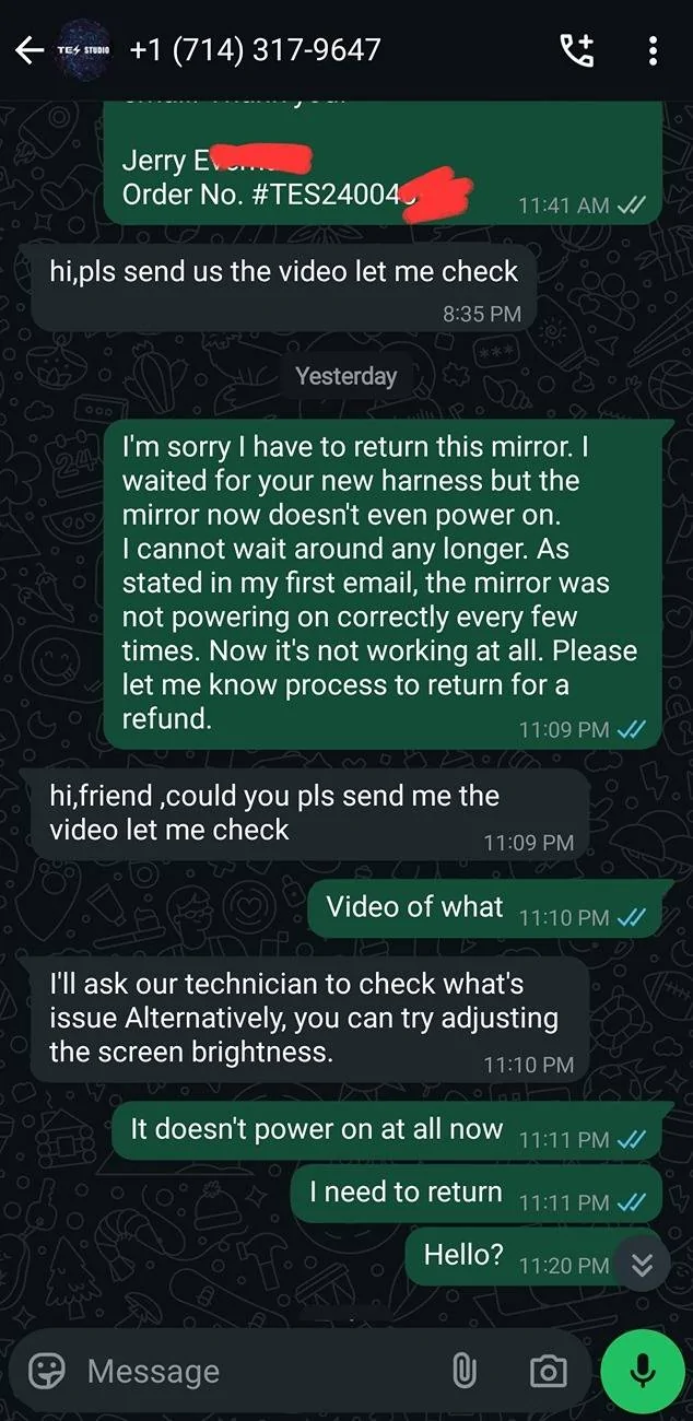

I'm sorry I have to return this mirror. I waited for your new harness but the mirror now doesn't even power on. I cannot wait around any longer. As stated in my first email, the mirror was not powering on correctly every few times. Now it's not working at all. Please let me know process to return for a refund.

During our first interaction, I tried to ask you for the order number, but you didn't provide it. However, in order to resolve your issue, I immediately sent you our customer service WhatsApp. You can still contact our customer service on WhatsApp to resolve your problem, but you must first provide our customer service with your order number. This is the key to solving the problem. Thank you.
That is not correct. See below where I clearly added my order number. I have sent it again.
Alright, I will check with our customer service and have them address your needs.
