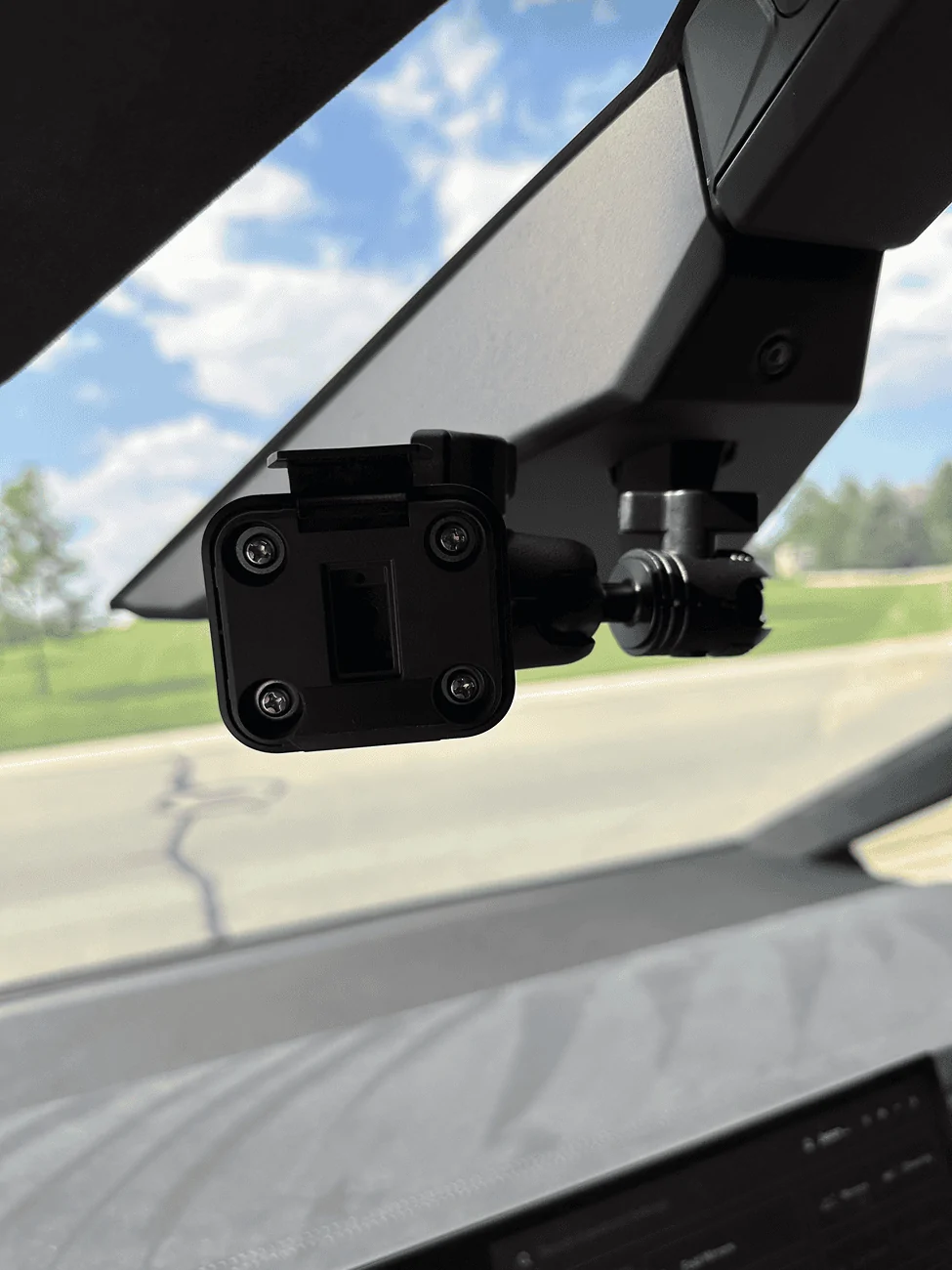

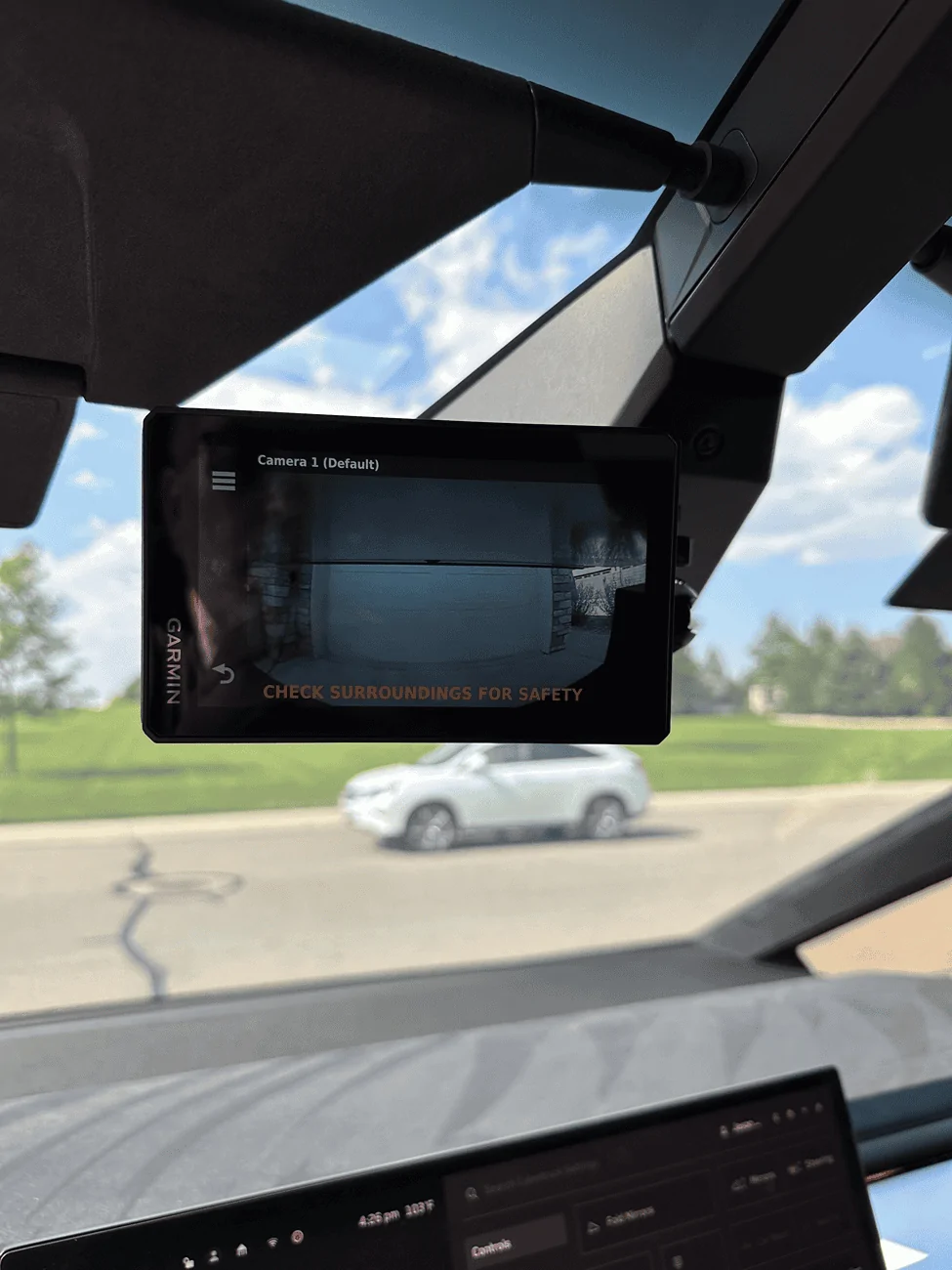

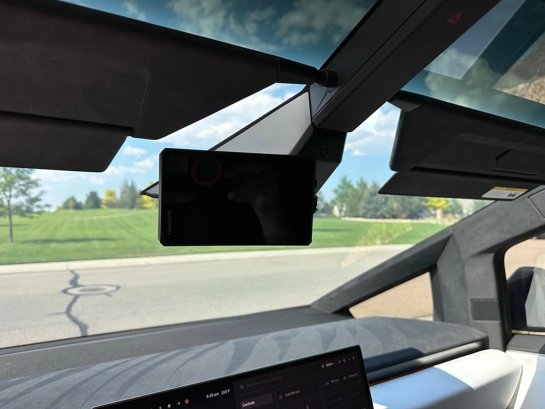

Hi All, bit different spin on the same ...
I'm ok with using the on screen rear view, but when I load dirt bikes (>1 which is most common), I have to leave the tailgate down and it doesn't work as it's pointing to the ground. I dislike the lil physical mirror as I'm sure most of us do...could use it because with bikes in the back the cover is stored so it could work with limited visibility. But....
I have a Garmin Zumo XT I use for long distance street motorcycle rides and I bought the Garmin BC 40 Wireless, Battery Powered rear view camera....installed the Zumo on the OEM Mirror 20mm ball and the BC 40 on the lic plate - now I have a rear camera view where a physical mirror goes and it works with the tailgate down!!!! Additionally, since Garmin it connects to my inReach sat messenger (no cell signal in Colorado mountains), topo maps, backup GPS, national parks/poi's/offroad/gas stations, etc extra "in mountains" functionality!
I dont plan on using all the time so didnt wire it to the Mirror 12v, nor the Truck USB-C (I may, we'll see)...it's quick release and I can charge off the USB-C in the center storage.
2nd Pic is with tailgate down....
3rd Pic is mounting - it all comes off easy (< 10sec), except the Tesla mirror arm.
