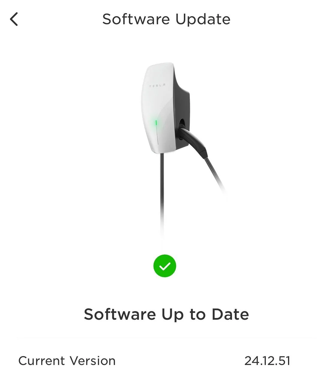

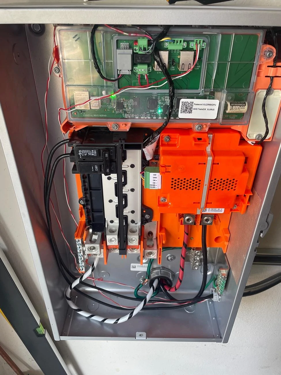

Thanks Darren! I’ve confirmed that the two universal wall connectors I have connected in a group are up to date.

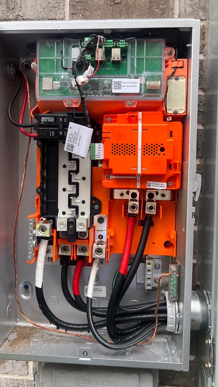

Like you said, I still see no lights in the gateway:
Not much info is available on the gateway. I wanted to know if more than one charger could be hooked up to the gateway. It looks like the bus bar has plenty of slots for additional breakers. Then I wonder if a generator could be added to back feed system through the bus bar.

Side note, your installer didn’t move any circuits to the Gateway either. I told my installer they need to do that as it’s the whole point of the gateway backup and they said their diagram only had the one. I’ve reached out to the parent company (Treehouse) Tesla paired me up with telling them that they to send the electrician a new diagram to move the circuits.
Unless Im wrong and they all get backed up through the lower “External Backup Circuits” wiring, but they didn’t connect that either on mine. Looks like they did on yours.

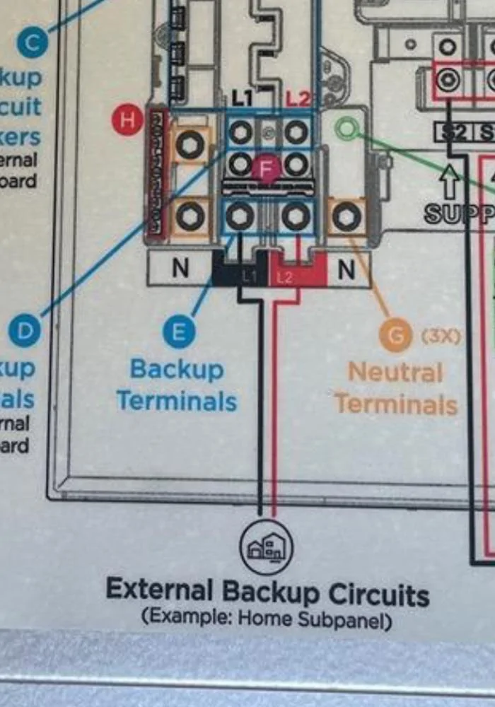

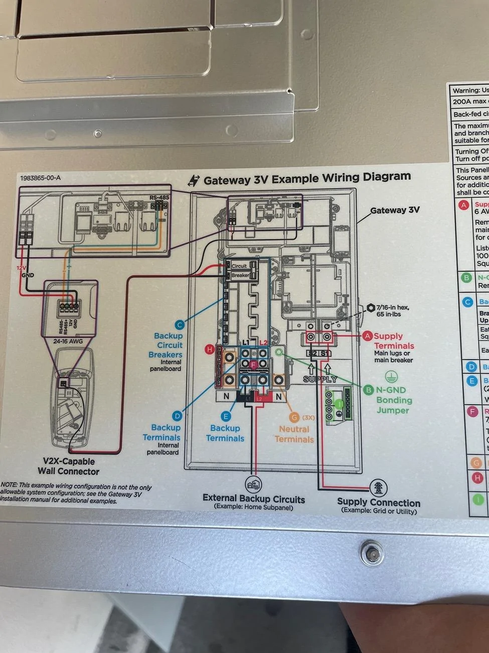

Could you post a picture of the text table partially shown in the second picture? It give descriptions of the circled letters.
Here you go.
Not sure about the wiring question. No doubt you could connect two chargers, but not being an electrician, I’m not sure about the back feed system.

I’m not sure I ever posted the final wiring:
They ended up feeding the Gateway with a 125A breaker from the main old breaker box (not the 60A they originally installed).
Then they also moved 6 circuits I selected from the old breaker box to the Gateway for backup (Refrigerator, home internet Fios box power, garage door power, selected lights/outlets throughout the house to allow lights, power to charge phones, power to WiFi router, and power to plug in window AC units in bedrooms if needed).
Lastly, of course, the 60A from the Gatway to the Universal charger.

Thanks for the picture. The third line down says Back-fed circuit breaker requires hold-down kit. So I have no idea if its related.

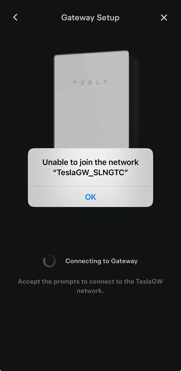

Solved my multiple homes app issue. Posting in case someone else has the trouble. Shoutout to Tesla Motors Club where I found the solution.
I cannot get the support chat to work. I click “Chat With Us,” it turns gray, but no chat initiated. So, I called.
1. Call 877-961-7652
2. Option 3 for charging
3. Someone answers very quickly
4. Explain the situation and have them remove the universal charger from your account.
5. You’ll need to be by the unit to read the model number and serial number to them. It’s on the left side by the QR code.
6. It instantly removes that “home” from my app, leaving me just the Gateway “Home”.

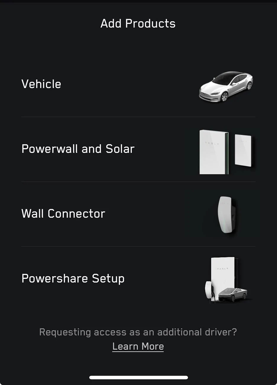

7. In the app “Add Product”
8. Pick “Wall Connector” and after “Get Started,” select to add it to your current home.
9. You’ll need to be by the connector to connect to its WiFi.
10. Mine said it couldn’t add but found a previous registration. I did not chose to use old, but to try again. That did the trick. Maybe I tried too quickly. It added no problem.
10. Took a couple hours for the CT to show in the garage on the Home Screen in the app.
I believe the entire issue is because I added the charger first and it lets you chose to add it to an existing home or add a new. The Gateway did not let me chose. It forced a new home. So, add the Gateway first. The reason I did the charger first was because of the issue of no power to the gateway. I added the charger first to update the software to then allow power to the gateway. In retrospect, perhaps I could have updated the software in the Tesla One app and not the Tesla app.
