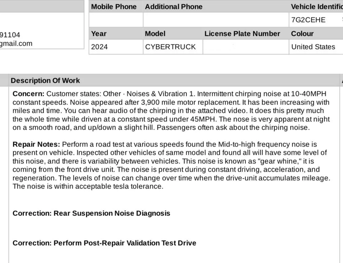

Thank you for the responses. I feel your pain. Yet feel better knowing I am not the only one hearing the morse code. This is what was written by service. I would be surprised if this has not been solved on the 2025 trucks.
Below is what service wrote.

Yup and it’s very annoying. SC tells me it’s the inverter.
Inverters can make a slight whine, but the pulsing sound is obviously typical gear whine, in your case the Service Center folks are simply wrong. I love the gear sounds, but then I've been driving heavy-duty trucks with manual transmissions since I was 17 years old.

Mine does this and every other one I've ridden in does this. Mine is a little more consistent in its chirp, and is much less noticeable when I'm using FSD. SC told me its normal as well. If something goes wrong, that's what the warranty is for.

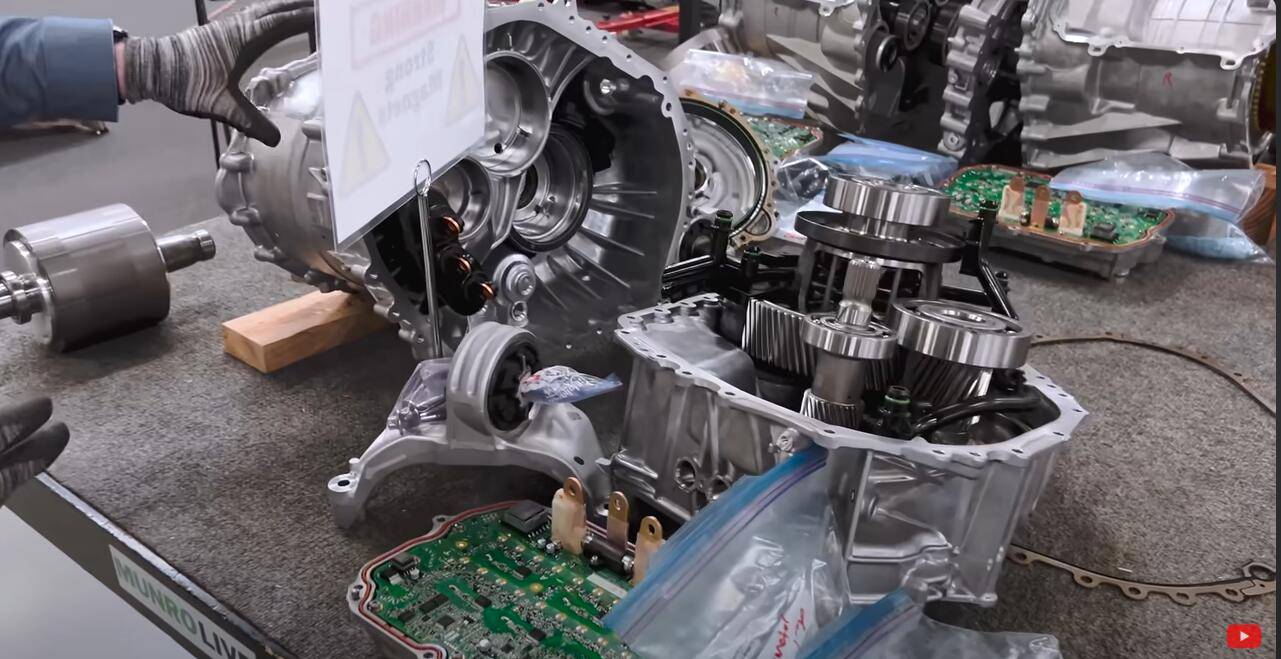

I'm curious if the Cyberbeast make this noise as well. Both versions have a permanent magnet synchronous motor in the front or rear, depending on the model, but there is a slight difference based on some of the spec sheets I've seen. (222kW on the AWD, and 212kW on the CB). If anyone is curious, the motor and gearing in questions is pictured below.
Tesla Cybertruck gear whine 1739903554775-3u

Gear whine chirping10-40MPH
Does your truck make this noise?
I am told this is normal.
See video (sound on)

They had my truck for a couple days..but the beeping never occured when they test drove it..it doesn't happen on every ride. Does yours?
I've been to both Tempe and the Scottsdale locations here in Arizona. Please complain again if it happens to you again..the more people complain, the more likely they will have a fix.
Here is what the service manager at Scottsdale sent me..
"Thank you! We’re all still scratching our heads here. At this point engineering is looped in, they are unsure of anything that could make that noise. We also added your concern to a chat of over 800 people that are cybertruck specialists and no one else has ever experienced that beeping."
