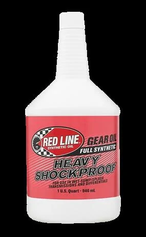

You can try using a different gear oil.
Tesla Cybertruck Gear Whine - Any stories on resolution? 0000848_heavy-shockproof_464
