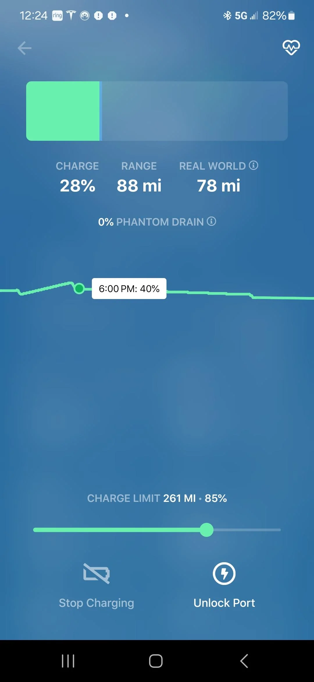

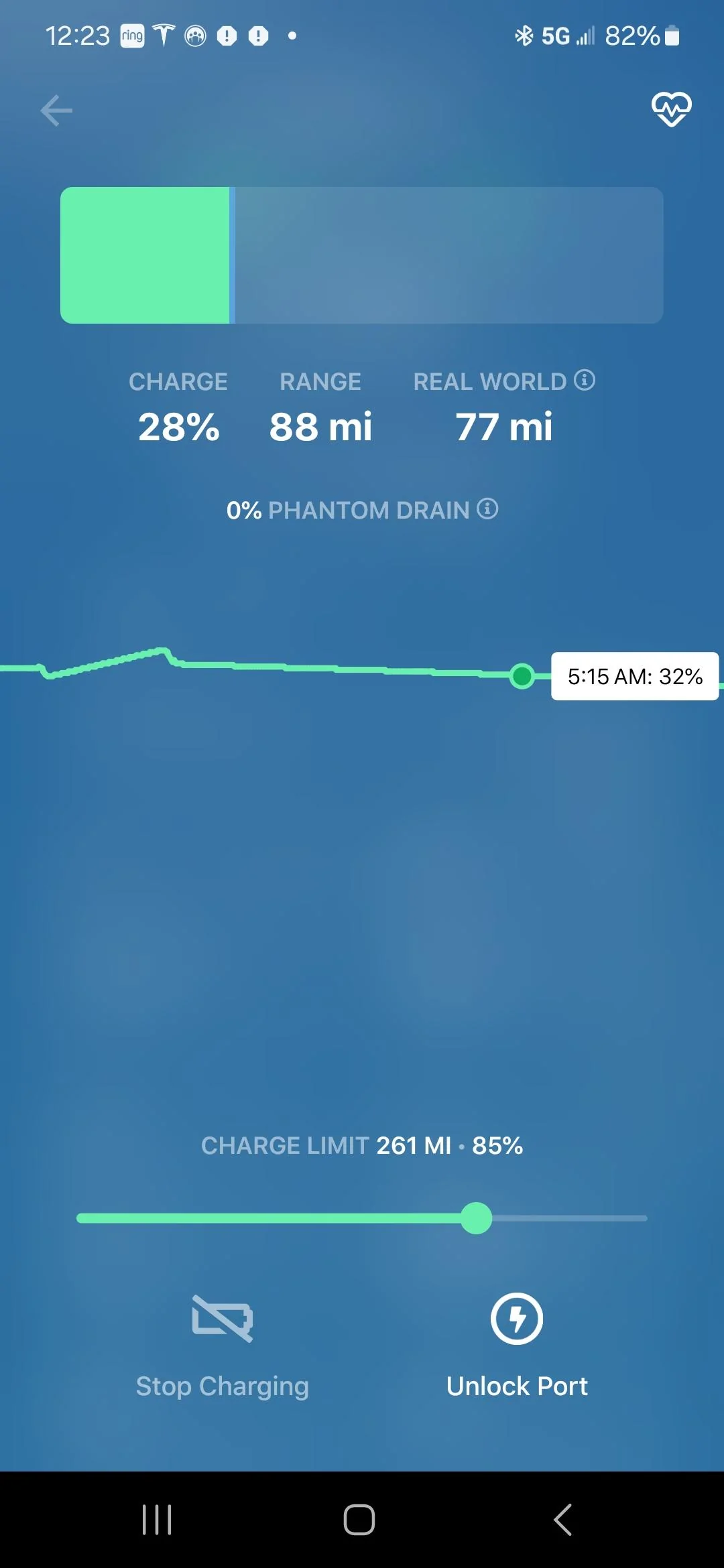

I've also noticed high overnight drain, but I almost never leave it plugged in, so it's not just when cabled up. Last night was especially bad, with Tessie data showing 8% lost overnight!
I agree with the speculation that the truck is uploading massive driving data while on wifi and therefore awake all night. Compare the overnight to the daytime on the right side of the plot which shows zero loss over 6+ hours while off wifi with the truck parked at work:

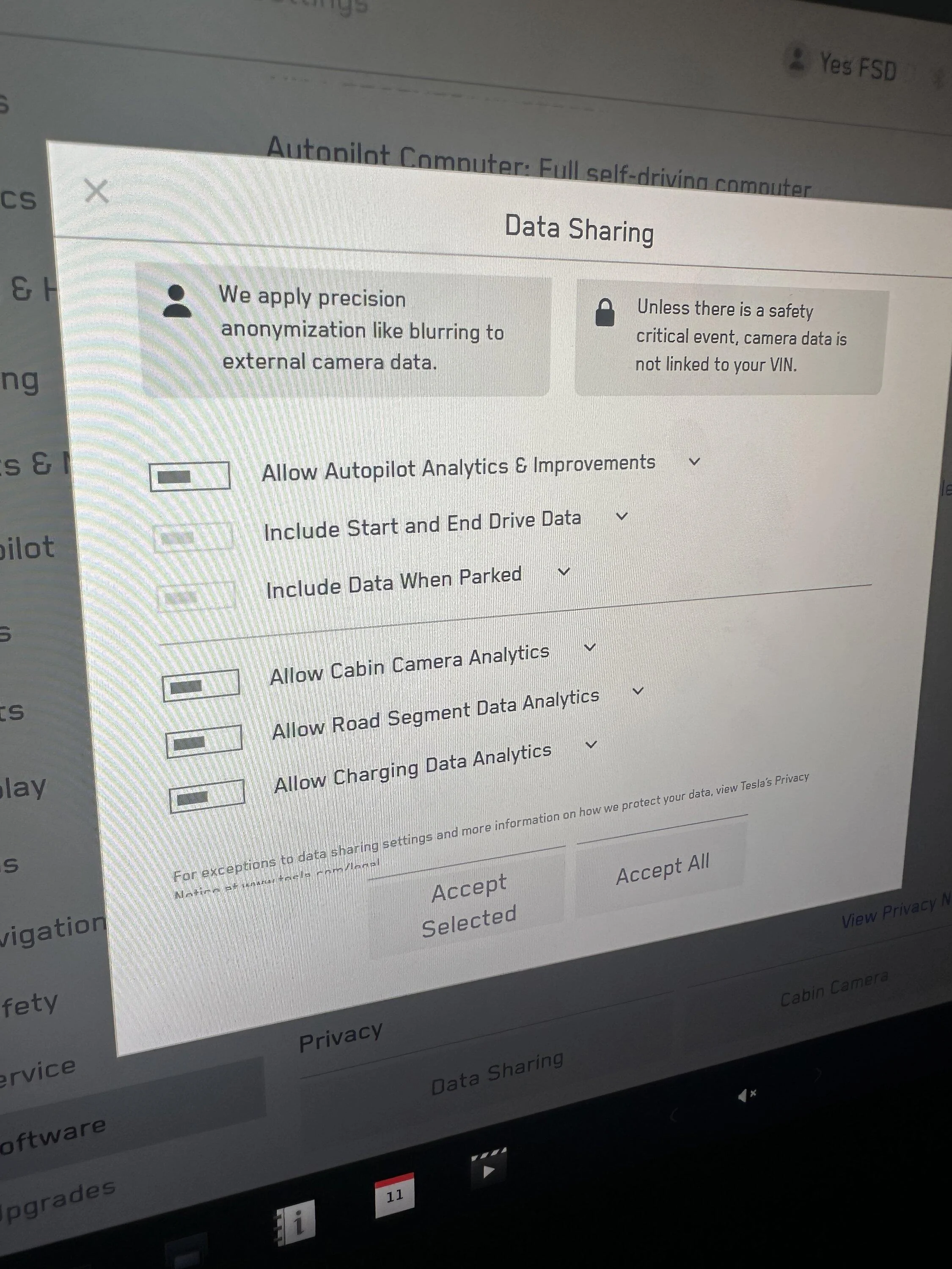

Would the phantom drain come from the truck sending video data to help neural network with fsd and autopilot development?
I would love to see phantom drain comparison for people that choose to share video and data with tesla and those that dont to see if different.
