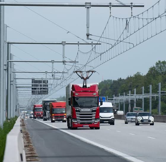

Drove down this highway in Germany the other day.
BTW Trollybusses have been in operation there for 70years.
