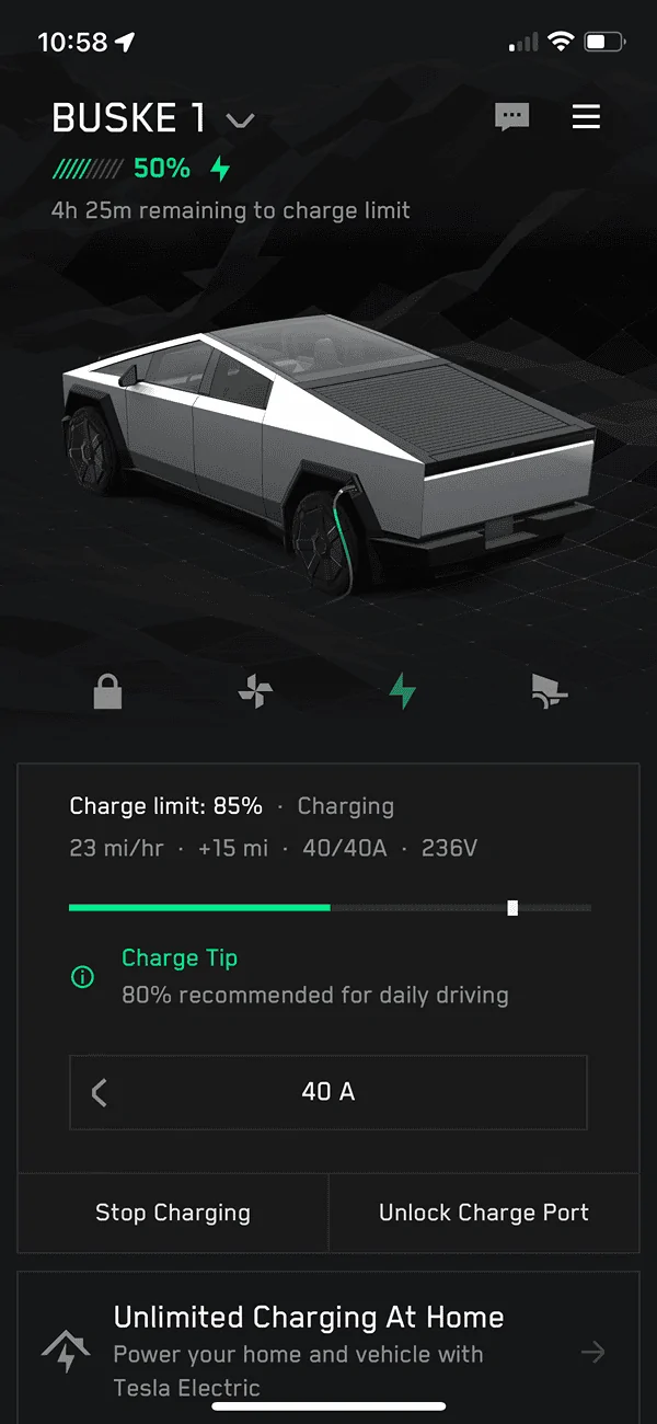

I'm just going to add some data.
I have a 240v on a 50amp breaker. Best I get is about 18miles/hr at a limit of 32A.
I didn't realize 32A was the max the CT can take?
Tesla Cybertruck Charging the Cybertruck at home? IMG_2347
I’m using my old mobile charger and it charges at 40amps. It’s a better quality charger than the new ones and has thicker cables.
