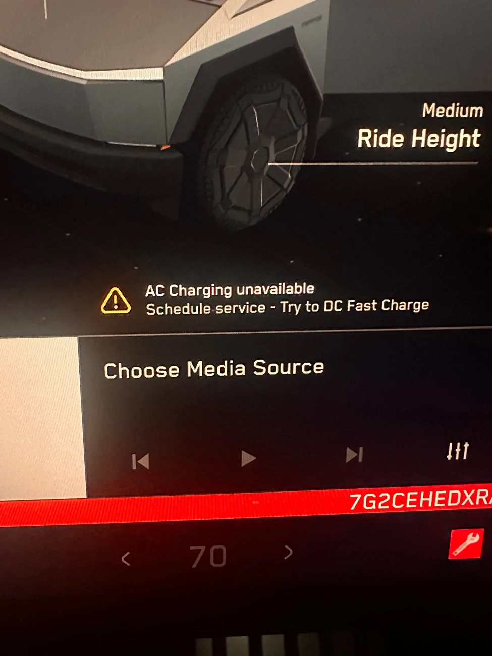

My Foundation Cyberbeast v# 31xxx 24k miles just started L2 charging maxed at 24A. Log shows "PCS2_a103_IsoTempSensorIrrational DCAC2 AC2 temp N" temperature anomaly error May 7th, I normally charge in the middle of the night so I haven't noticed the reduced charging. Just happened to charge during the day today and noticed capped out at 24A. I tested at a local Supercharger and can successfully charge there. Put in svc request and May 20th is soonest. Since others have said no new gen PCS parts expected until June/July, not sure what they can do. I do need my lightbar recall done and I added that to the request since I did get the letter saying bring it in whenever.
