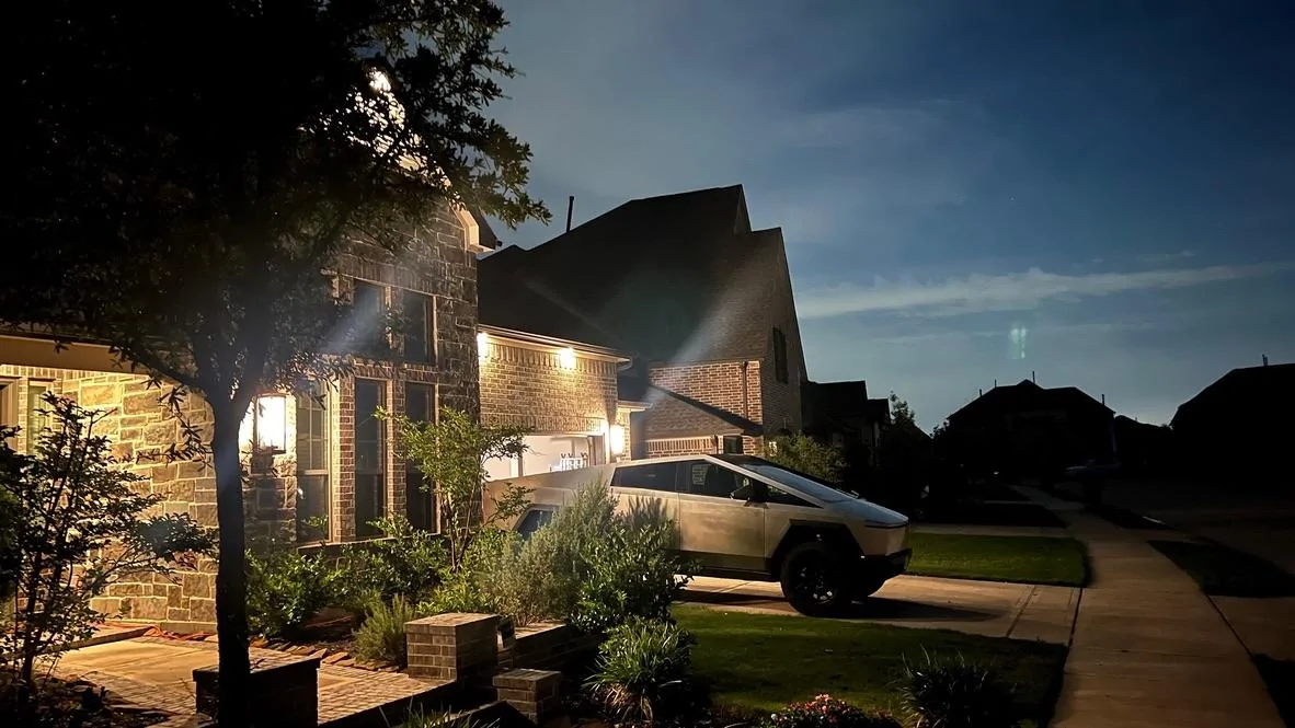

Running the AC is doable, but as others have said, it depends on how long you want to run it and the specs of the AC. I recently had variable speed ACs installed (unrelated to CT purchase). I can run two at a time. Practically, would just move the family into master bedroom and run the small unit that runs that room. It peaks at 6A. With variable speed, most of the time it’s running far less than that draw.
Running 75% of the lights in my house, 2 TVs, Wi-Fi and 2 fridges, I was running right around 1kW, if I recall correctly. If you were trying to conserve power for a prolonged outage, the truck would run the stuff for many many days.
Tesla Cybertruck Non-PowerShare home power IMG_0882
