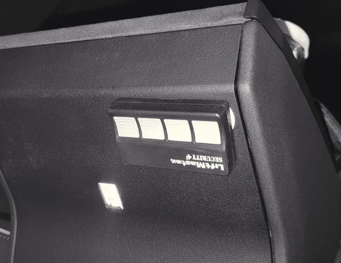

We have three houses with three different systems, all of which can receive Homelink codes, and two that have MyQ. However, with the truck I’m staying old school. This isn’t so bad:
Tesla Cybertruck Homelink on Cybertruck - anyone install? imag

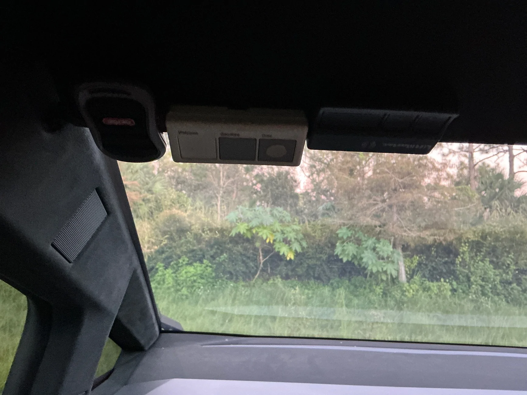

This is even better. Out of sight, yet easily accessed. Does not interfere with the cyberfridge, either.
Tesla Cybertruck Homelink on Cybertruck - anyone install? 1762075222321-a9
