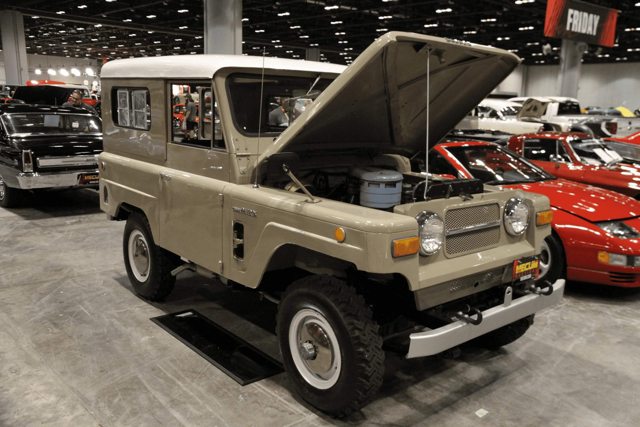

I've been off-roading all over the Western areas of Canada, the USA and Mexico for decades. My first off-road vehicle was a 1969 Nissan Patrol, of which I've owned three over the years. This was an inexpensive way for me to explore the wilds of North America on a budget. Here is what they look like with the hard top on:
Tesla Cybertruck How much would you pay for a range extender. 1691202604487
That hard top unbolts from the lower body and the windshield flips forward onto the hood. I ran two of them to Mexico on different off-raod adventures. They both had oil bath air filters and a 4L cast-iron straight six-cylinder engines with a three on the floor and dual-range high-low transmissions and Warn manual locking hubs. One trip my buddy and I took the roof off in Washington State in May and drove throught the American Rockies, through New Mexico and deep into Mexico, returning via a ferry out of Mazatlan to the Baja Peninsula. We off-roaded some of the most remote areas we could find, including making the first crossing of a high off-road pass in New Mexico of the spring. We know we were first because there were no tracks in the remaining snowpack. Central Mexico had numerous and lengthy backroad and off-road routes to high altitudes near the Volcan de Colima and down to sea-level south of Acapulco and we travelled roads in Baja off the mainline highway, crossing the mountains several times (once after being told by an off-road motorcyclist that there was no way we could through the slide he just rode through) and driving to numerous beaches accessible only by high-clearnace 4x4's or pack animals (or lengthy hikes).
Of all the miles of off-road travel I've done, soft surfaces have made up far less than 10% of the trail. Others might choose to specialize in only beaches or only mudding, depending upon your preferences and the goegraphy you travel in, your experiences will obviously be different. I'm speaking from mine. Laugh all you want..
I also owned a Subaru wagon which, while not a dedicated off-road vehicle (it was bone stock), it saw plenty of wheeling. One day my wife and I decided to take the "scenic" route across the Washington Cascades at the end of a road trip in our new-looking Subaru with OEM all-season tires. I told her it might not be passable and there was a chance we would have to turn back, greatly increasing the length of our return trip but she was game. After about two hours of very slippery and tricky driving, we broke out onto the top of a high ridge and the driving became less technical. Soon we came across a group of lifted Jeeps, the local off-road club on one of their Sunday off-road outings. They looked at us like we were in a spaceship from another planet. I greeted them and one of the first things they wanted to know was how we got up there. Being a smart-ass, I think I told them "we drove". He said he understood that but wanted to know if we knew of an easier route to the top. I told him we came up the main trail that we were on, that our map didn't show any alternate routes. They were dumb-founded that an un-lifted Subaru could traverse the same trail they had come up in their purpose built, lifted off-road Jeeps, all high and mighty.
I have a long history of wheeling, and not always in purpose-built vehicles. My VW bug and my VW rabbit also took me to many places they didn't really belong. Obviously, the Model 3 is not an off-road vehicle, but that doesn't mean it can't go off-road. I've done routes in my Model 3 that the 1978 VW Rabbit and the 1972 VW Bug could not have dreamed of doing. The Model 3 can climb slippery steep hills better than my previous Subaru, although the Subaru could traverse more rugged terrain (but not by as much as you might assume). My Performance Model 3 is an early Performance version and has the same suspension and wheels as the AWD Model, later versions were lowered and had less optimal tire fitments for off-roading.
Many of the high trailheads in the North Cascades "require" high clearance vehicles to access and the snow-free season is short. Some of the high routes don't open up until late July in normal years. They are not passable in any 4x4 due to old snowpack. But, when the snow melts, I've been using my Model 3 to climb these steep, rugged and rocky routes with numerous washouts. Occasionally I have to turn back, if I encounter a washout or landslide that is too extreme, but mostly I get through. I often need to relocate a key rock or two. In the high-country I only run into high clearance vehicles, and they often voice complete astonishment that a Tesla made it up there.
Is that off-roading? Well, I've been told multiple times by off-road enthusiasts discussing routes in the bar that you would need an off-road capable vehicle to make it to where they just descended from. The same route I had just done in my Performance Model 3! And the efficiency it returns is astounding, compared to what I'm accustomed to in a gas vehicle.
I've been told by a guy in a lifted Toyota that I needed a high-clearance vehicle to make it to the spot he was returning from with 5 gallons of high mountain huckleberries. He was in disbelief when I told him I had just returned from where I saw his truck parked at the end of the road while he was off picking berries. He thought I was mistaken. I was not. His truck and my Model 3 were the only vehicles for many miles. Call me a "court jester" if you like. I have a little experiece off the beaten path all over the western half of North America. Yes, laugh all you want...
The power grid in the US is extensive. It's not uncommon to be in the middle of nowhere and have the off-road route run under the high-tension lines or cross them multiple times. The reach of power transmission lines in the US exceeds the reach of gas stations, by a fair amount. The grid is constantly being built-out and modernized and the next decade will see an acceleration of this to take advantage of new solar and wind coming on-line, to move the electricity to where it is needed.
