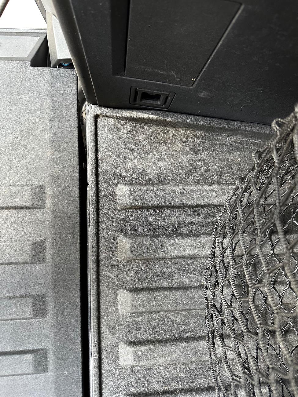

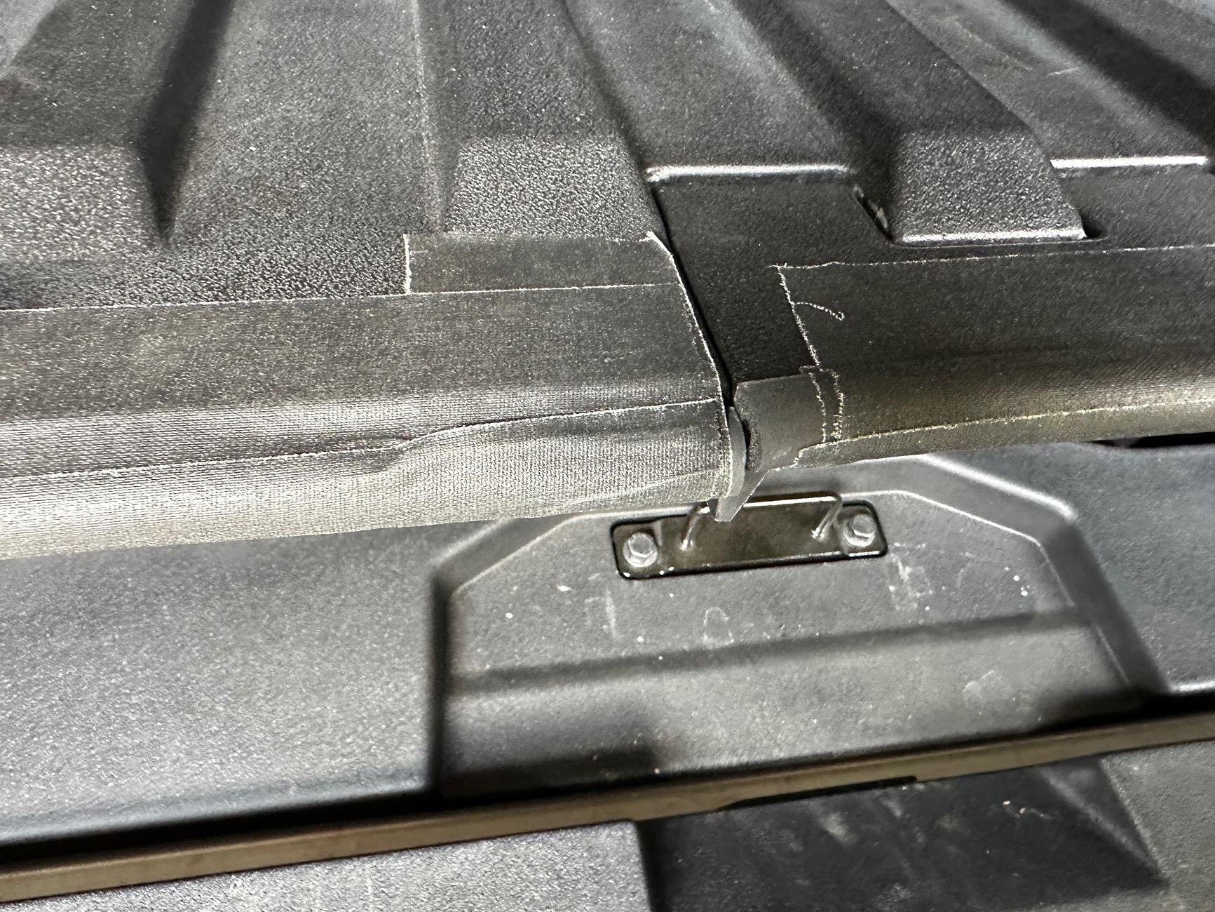

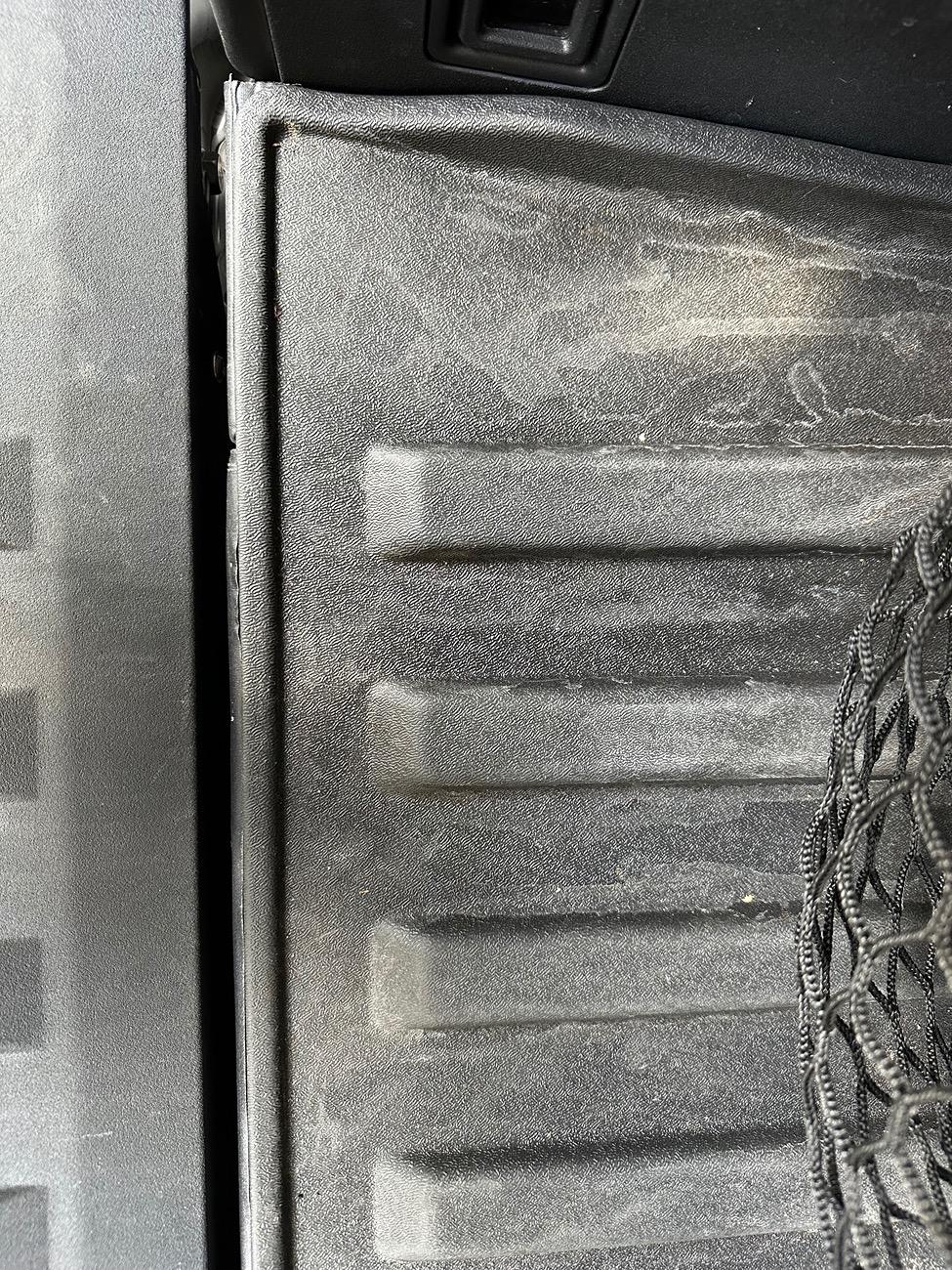

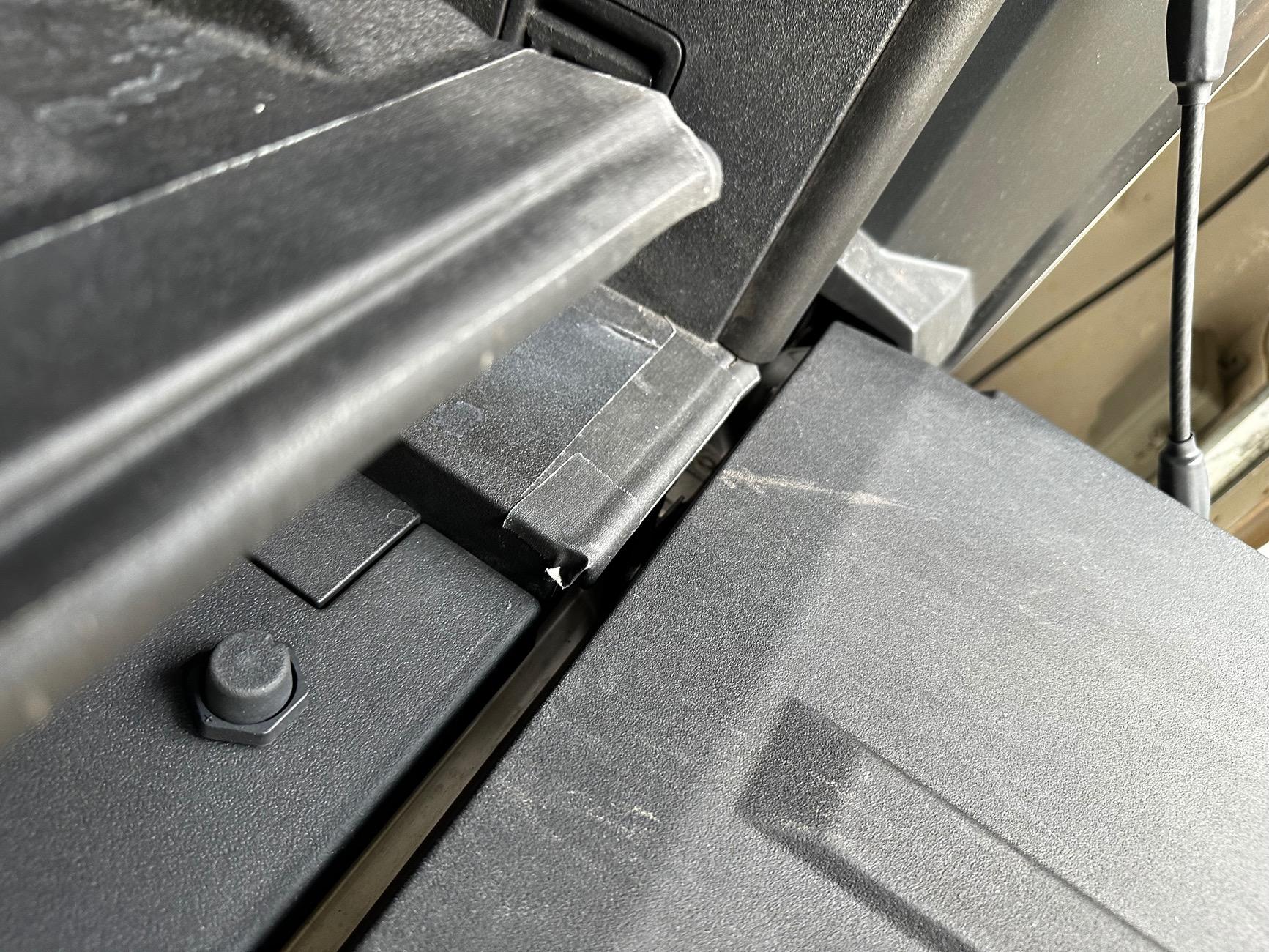

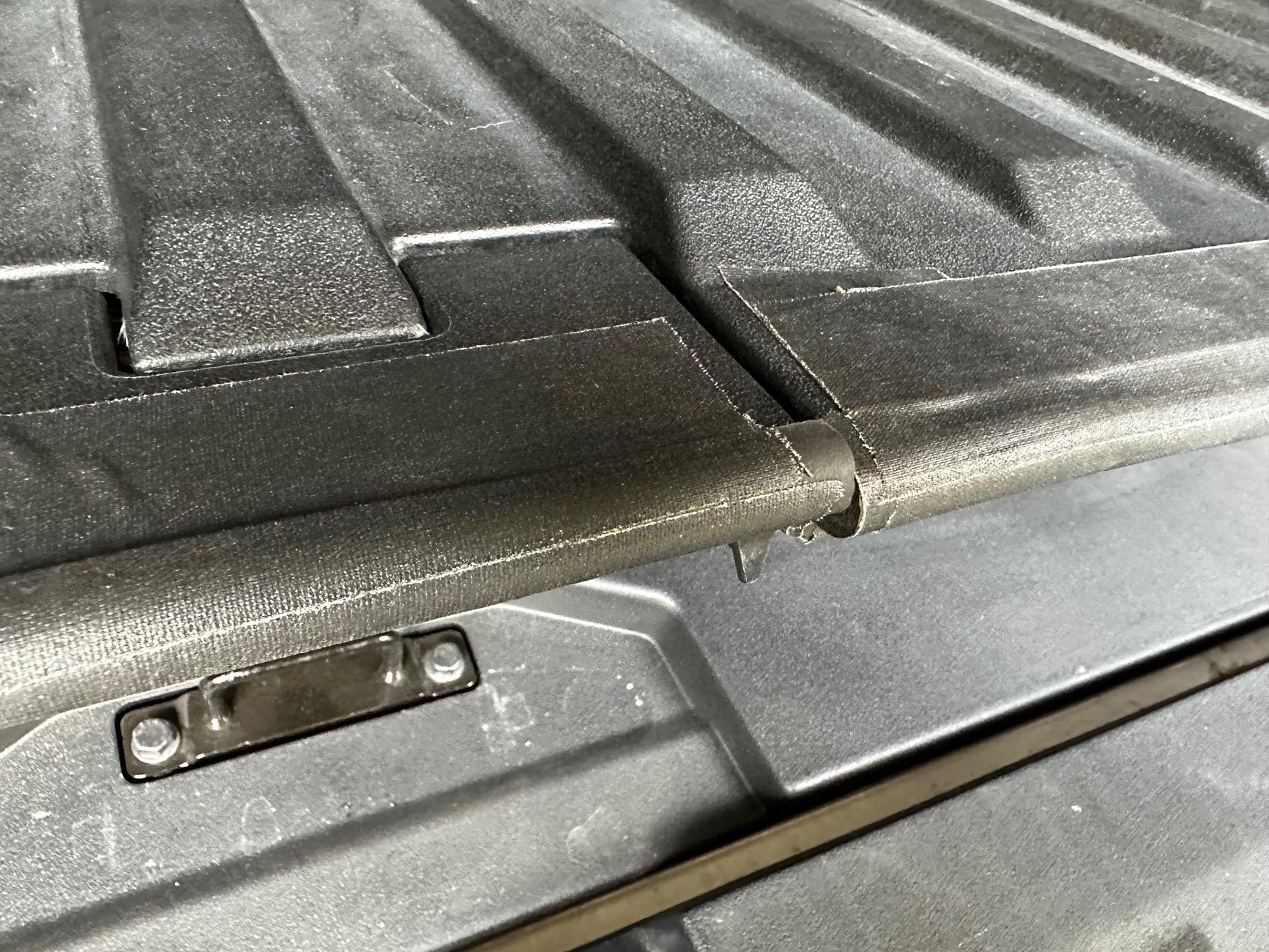

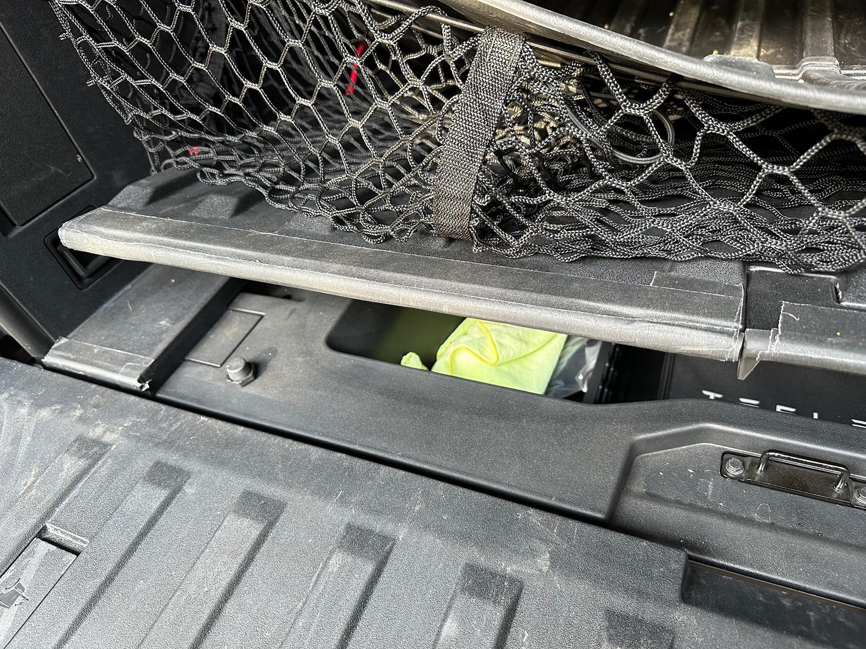

Today I found a five foot length of cast-off ½" D-shaped weather seal in my garage. It must have been peeled off an ancient project and the adhesive on it was dried out and mostly missing. I used it test a way to seal the tailgate gap along the bottom of the gate, starting with @Cybergirl's advice to "...stuff it in the gap by hand..." That D-shaped weather seal looked like it would work to prevent most dust from getting into the vault. It won't won't keep bulk materials out out the gap, but I'll use a tarp for that.
It would be better, though, if that seal stayed in place and I didn't have to stuff in place every time, or even think about it much, so...
With no adhesive on the old seal I used gaff tape to attach the seal to the trailing face of the vault bed floor, flush with the top of the floor. This photo shows the position of the seal how the tape was applied. I cut the seal at the outer edges of the under-bed compartment door and at the edges of the door release tab, so I could open the compartment without disturbing the seal.
The tailgate squeezes past the seal as the gate is opened and closed. That does put a load on the seal and will cause some wear over time. When closed the inner face of the gate compresses the seal enough to close the gap.
I'll test this for a while to see if the seal stays in place after undergoing a reasonably large number of open/close cycles.

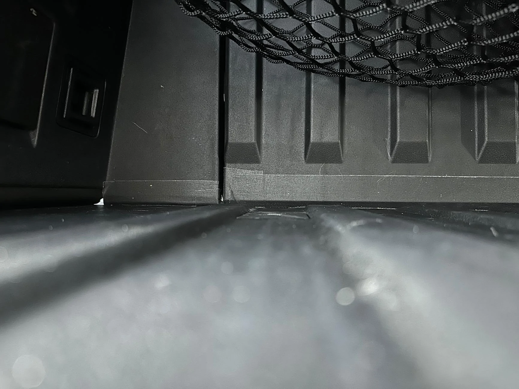

The view below is looking down at the now-sealed gap, with the tailgate closed. No daylight except at the edge of the bed on driver's side and a minor one at one of the cuts in the seam to allow the bed compartment door to open. Note that I have an aftermarket bed liner. The weather seal is taped to the actual bed, underneath that liner.

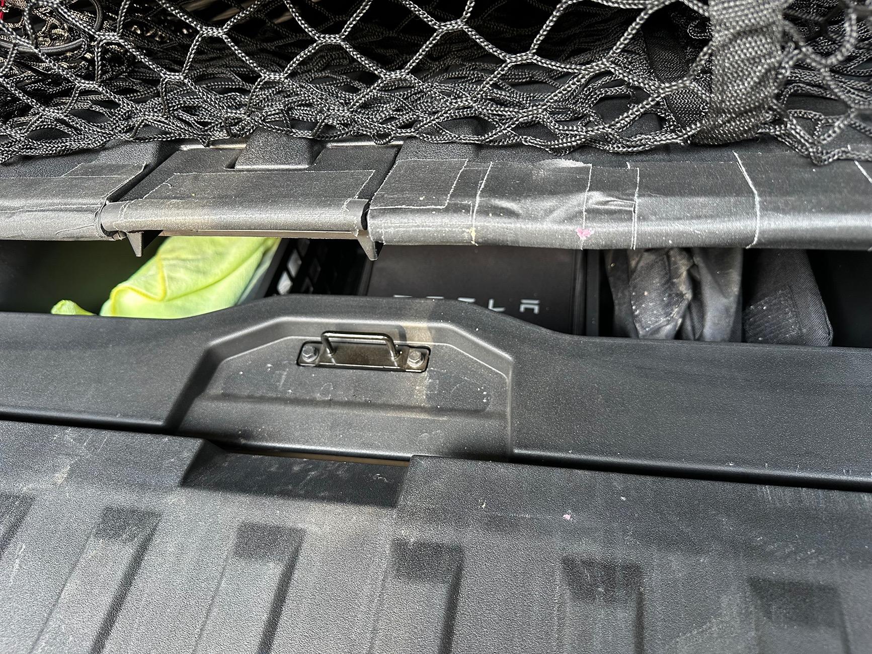

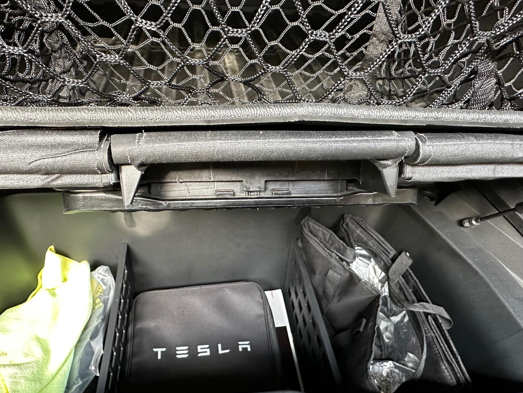

In this view below the tailgate is down and the compartment door is partially raised (raising the bed liner with it. The weather seal can be seen beneath the rather sloppy tape at each of the cuts I made in the seal to allow the compartment door release to operate.

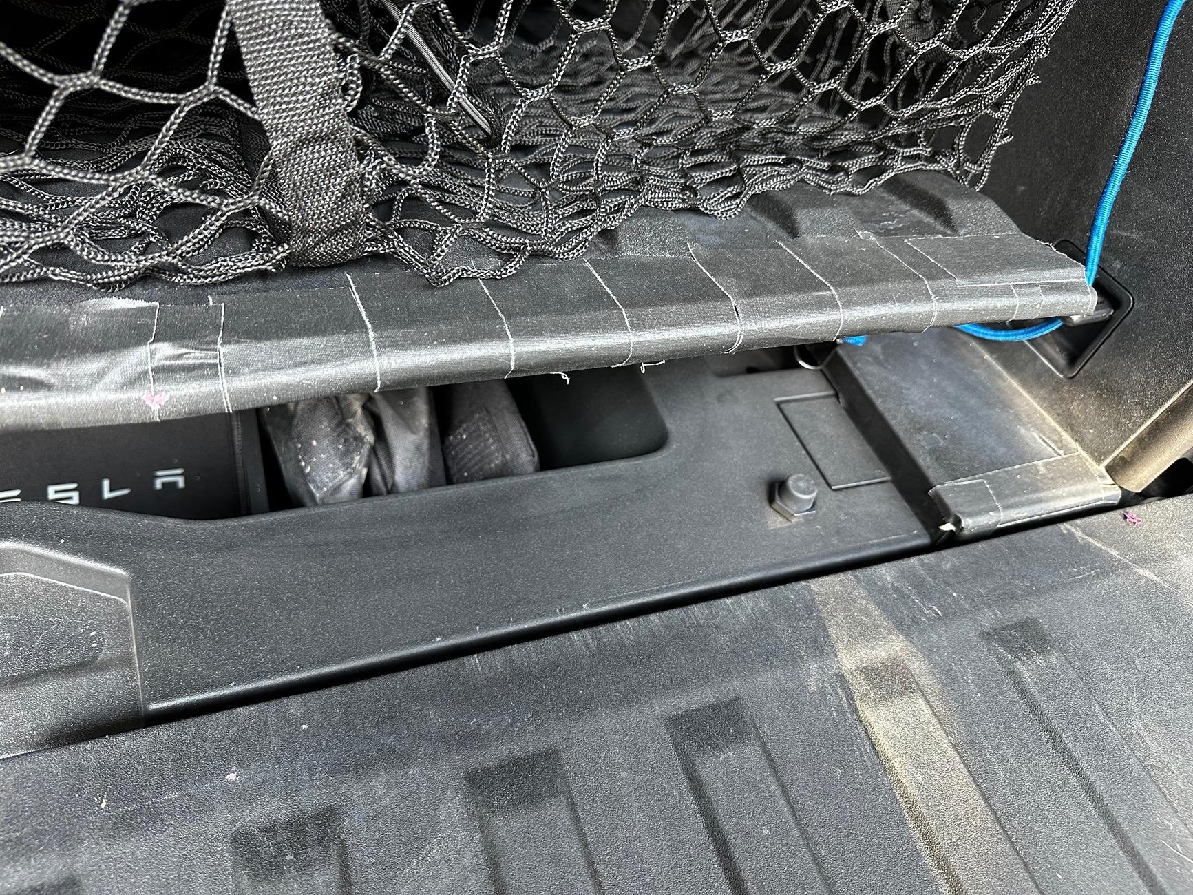

In this view below the bed liner is lifted to show how the seal is taped to the trailing edge of the bed, to the right of the compartment release. Another line of tape runs along the seal and is wrapped down under the seal, pressed onto the face of the bed end and wrapped under the lip of the bed, at the bottom. The seal is attached in a similar way to the release handle.

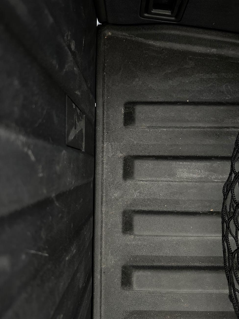

This view below shows the seal attached to the short edges of the bed, between the compartment cover and the side of the bed. The seal is taped to the bed in the same way (sloppily...) as it is to the compartment door. Remember, this is just a test! ;) If it works I'll re-do it more neatly.

Here is my follow up report on this hack.
It works....
After two weeks of typical use, multiple trips to the lake, to the grocery store, hauling some musical equipment and moving some furniture, the taped on seal under the added bed liner looks about the same as it did when I put it on. I cycled the tailgate at least three or four times a day during those two weeks, so call that 50 open/close operations.
As you can see from these photos with the bed compartment door lifted up some so you can see the seal taped to it, nothing has torn, slipped or peeled off. The gaff tape it still sticking tight (I pulled on it to tell), there is no significant wear on the tape and the underlying D-shaped foam weather seal is not deformed.

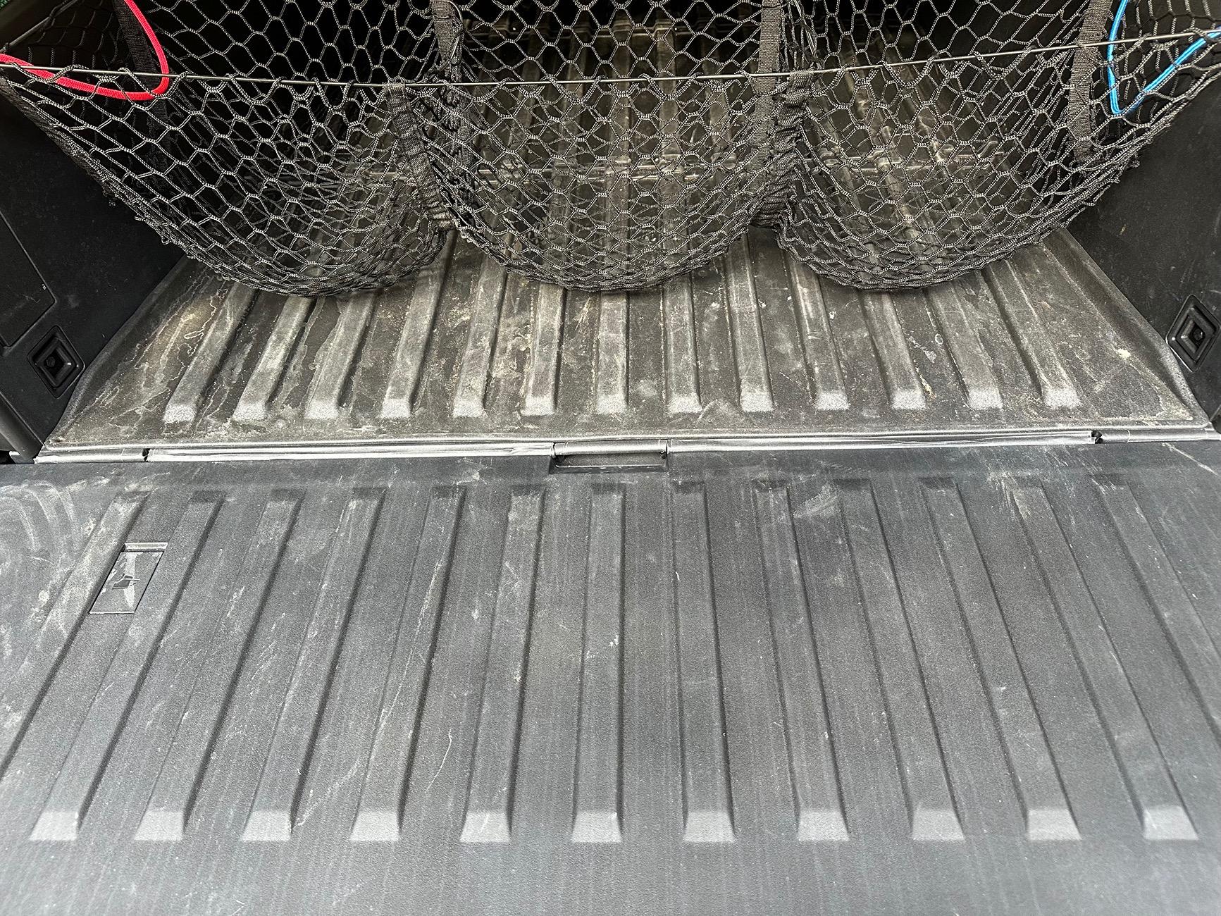

As you can see from this photo, the seal is still filling the gap, except where I left a small opening for water to drain, visible on the left side of the image.
