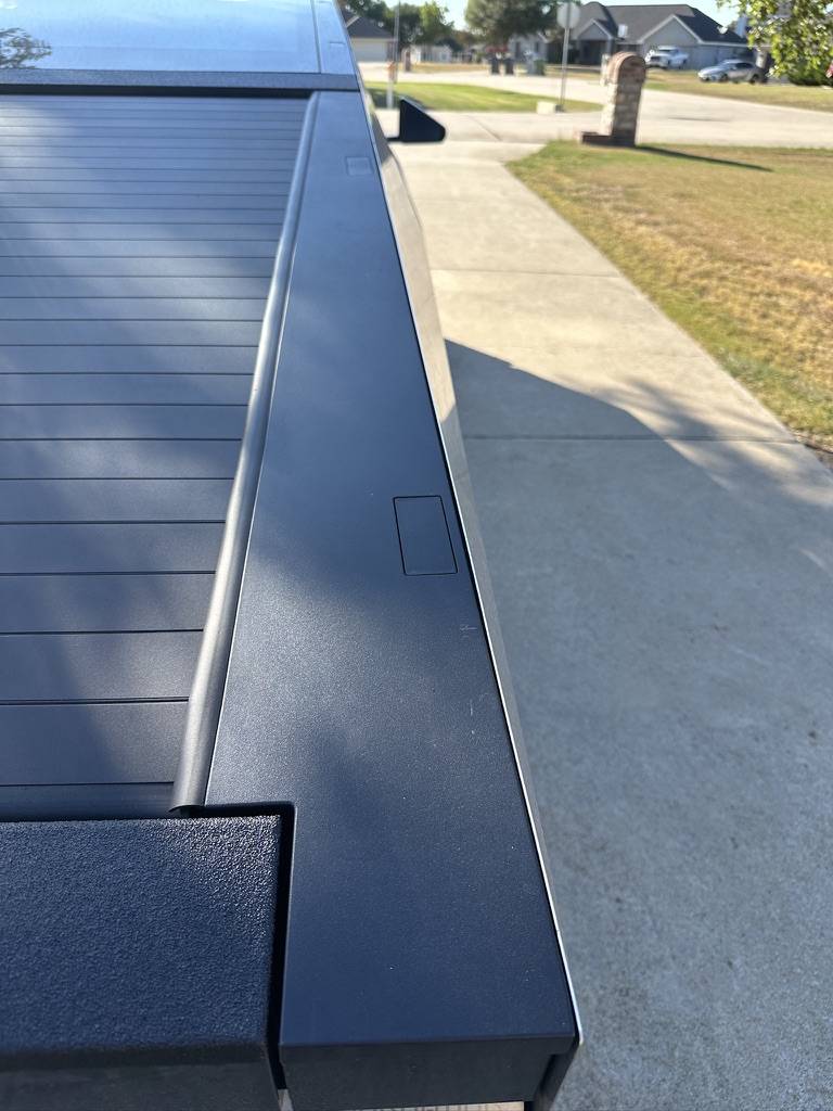

The Line-X dealer I took my truck to told me they would remove the sail trim and tailgate cap for spraying and that they would need to primer the plastic first, which is common for Line-X on plastic parts. I had literally just gotten my sail trim pieces replaced as part of the recall, so I figured I would look into what is needed to remove those again and I am glad I did because there is a note in the service steps for the sail applique and tailgate applique stating not to reuse the parts after removal:
Left Hand Sail: https://service.tesla.com/docs/Cybe...UID-1EFBCFAB-294C-4757-A2C1-DF6BA6B4C80A.html
Right Hand Sail: https://service.tesla.com/docs/Cybe...UID-415D63EA-024A-4B3D-8BC7-78356E4B7F71.html
Tailgate: https://service.tesla.com/docs/Cybe...UID-C8F2EB42-D393-448C-A1E9-9FC1830220D5.html
Initially, I thought it may just be out of an abundance of caution because of the potential for clips to break, but then I watched this video of someone removing the sail applique:
Given the number of clips that popped off and ended up in the truck body, I was concerned the Line-X shop may be able to get the sails off, but if they lost clips along the way, I'd have no side sails to reapply, no Line-X coating, and I'd have to wait for replacement parts to get everything put back together.
I decided to drive to my local Tesla service center and inquire about purchasing the parts brand new and just taking them to the Line-X dealer for them to coat and get to me when they're done. To my surprise, they actually had all three parts in stock and I was able to pick them up right then and there for $357.23 after tax. I dropped them off at the Line-X dealership just a little bit ago, along with the aeroflap from the front of the bed. I decided to have that piece done as well, just so there is a uniform coat and color to all the parts surrounding the tonneau cover, plus it will make the aeroflap a little more durable when it's removed for the Cybertent to be set up.
These are the part numbers I picked up today:
Left sail - 1741538-00-G
Right sail - 1741539-00-G
Tailgate cap - 1812376-00-C
I probably won't have the parts back from the Line-X shop until Monday because I am going out of town this weekend, but I figured I'd share this info for now and I can post pictures next week once I get the parts back and swapped out.
FWIW, the Line-X dealer said it'll be between $400-$500 to have all four parts sprayed with their Platinum product. That should provide the best durability and UV resistance. The price is a little higher than one might expect because they said there will be a decent amount of material waste. Apparently the gun shoots a 3’-4’ wide area and none of these parts are more than 5”-6” wide. ?‍♂
We’ll see how it turns out and if it ends up being a huge mistake, at least I know what it’ll cost to replace the parts back to stock. ?

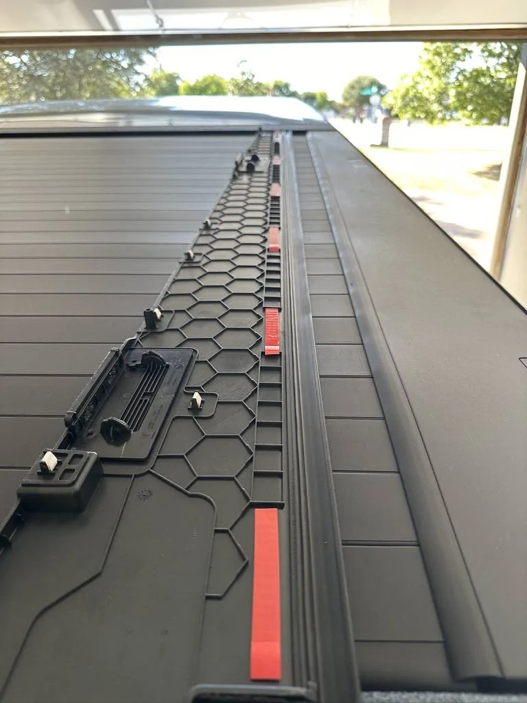

For the sails, they just pop up…but with the sail recall they also have a lot of 3M double sided tape. My Tesla tech let me watch him do the recall installation and he straightened out the top so it was flush with the roof. He had to pull it off at the top, bend up some of the steel, add a plastic washer and he needed to reapply some double sided tape because once you pull the sail up, it’s toast. So if you have the sails linexed, be sure to remove the old double sided tape and reapply it with new stuff. Be sure it’s the super strong stuff made for vehicles.

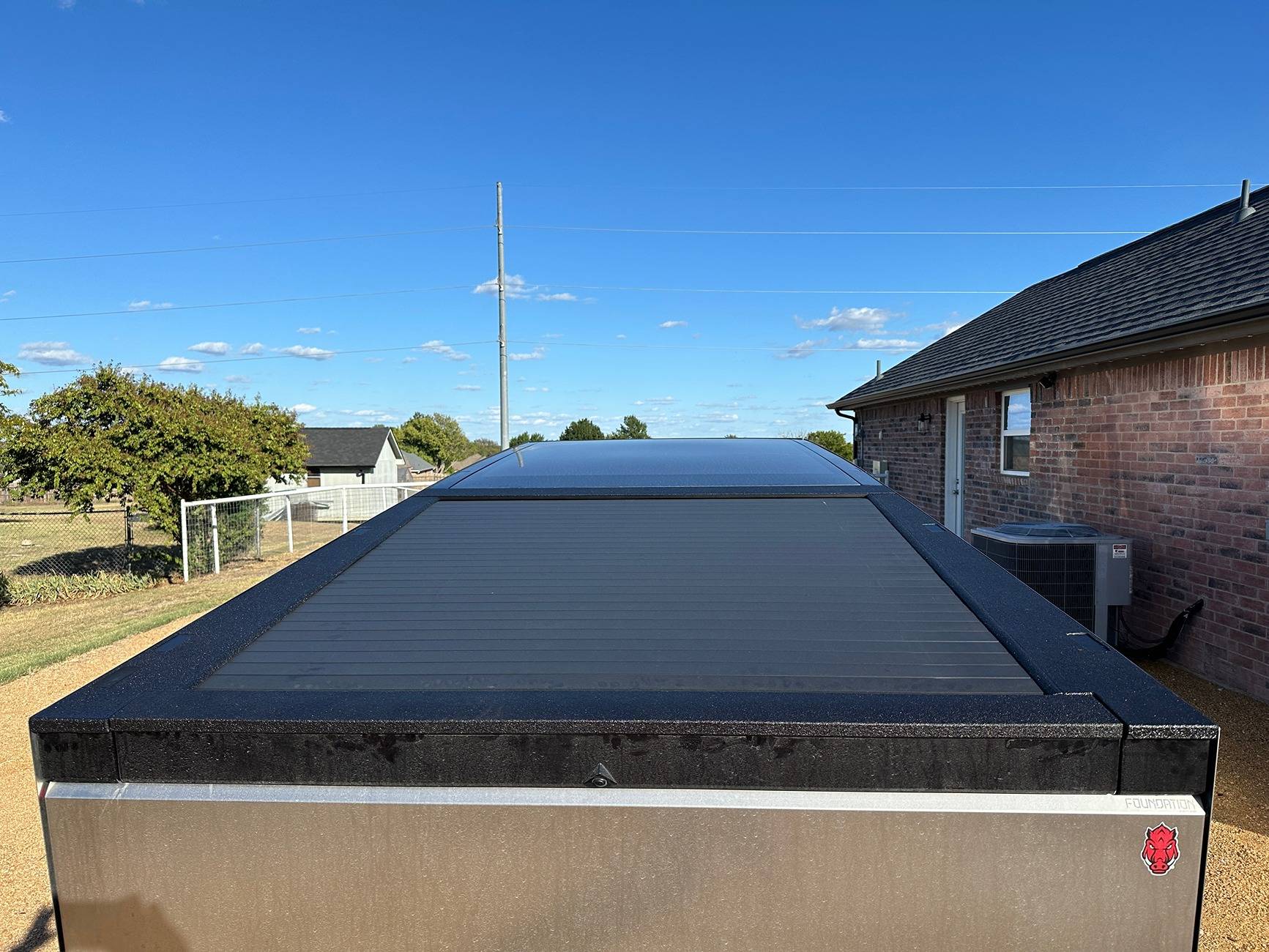

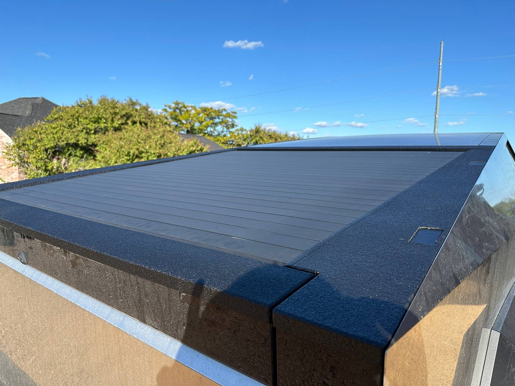

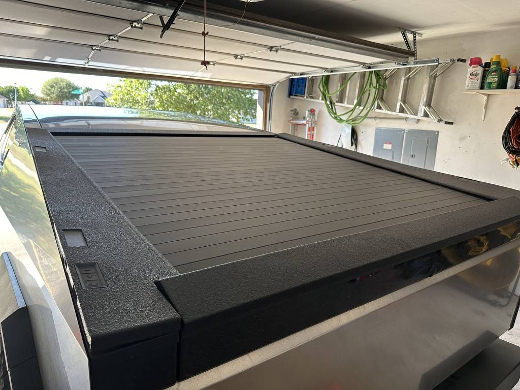

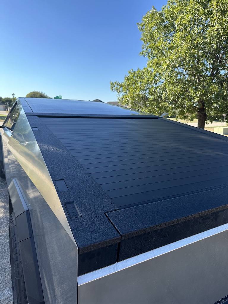

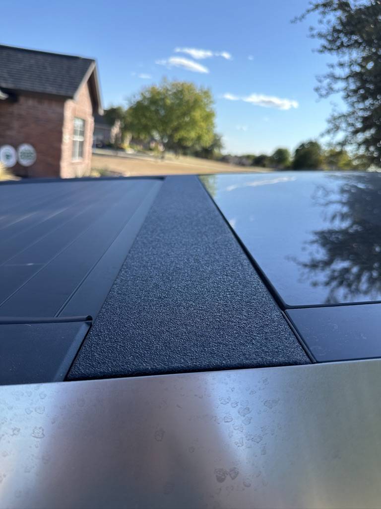

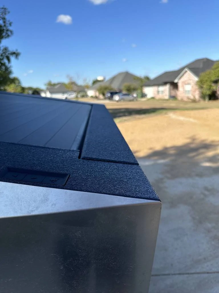

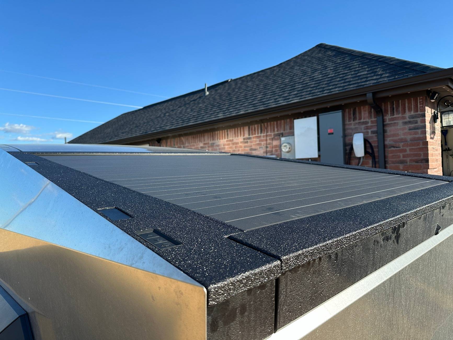

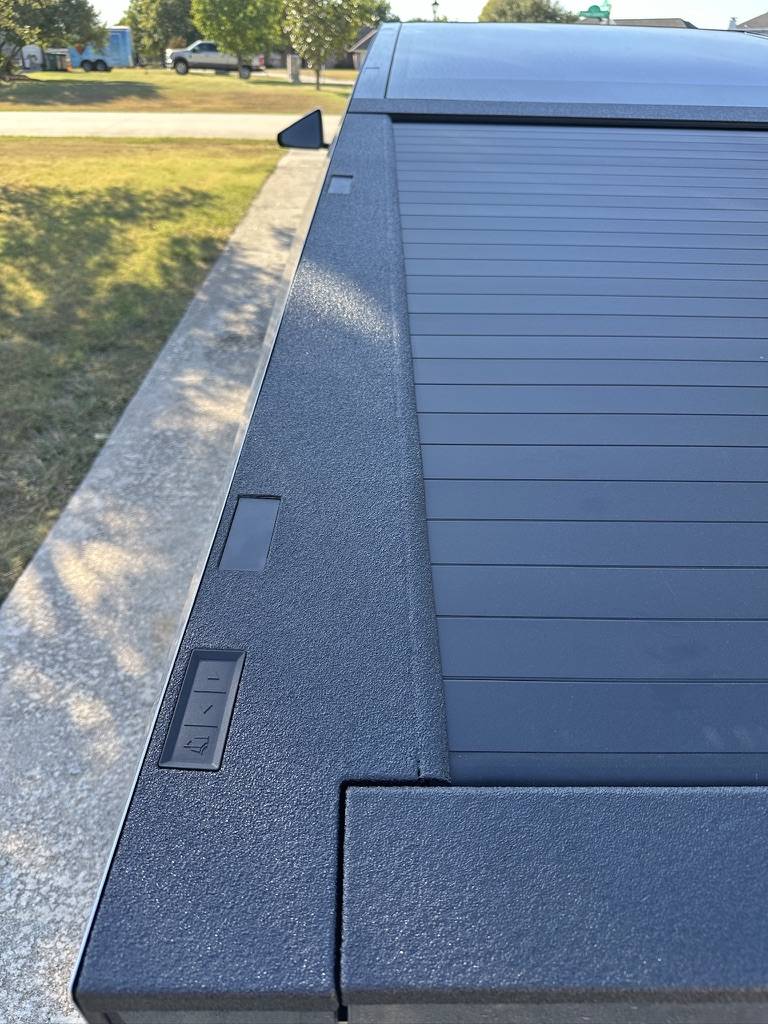

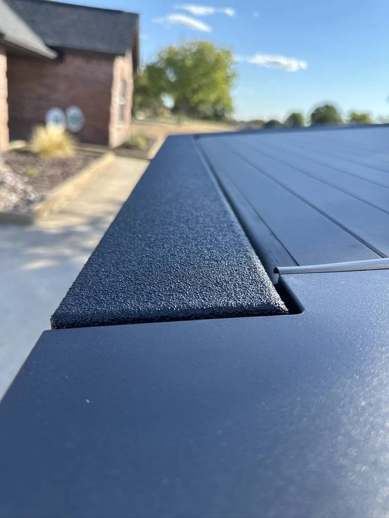

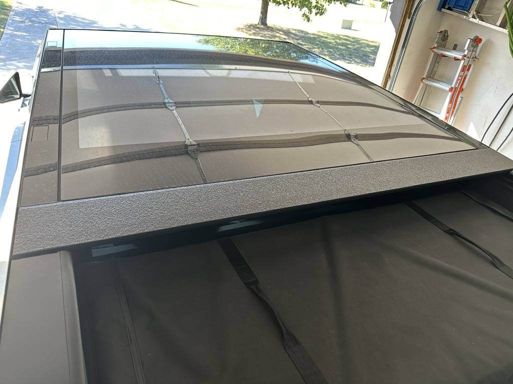

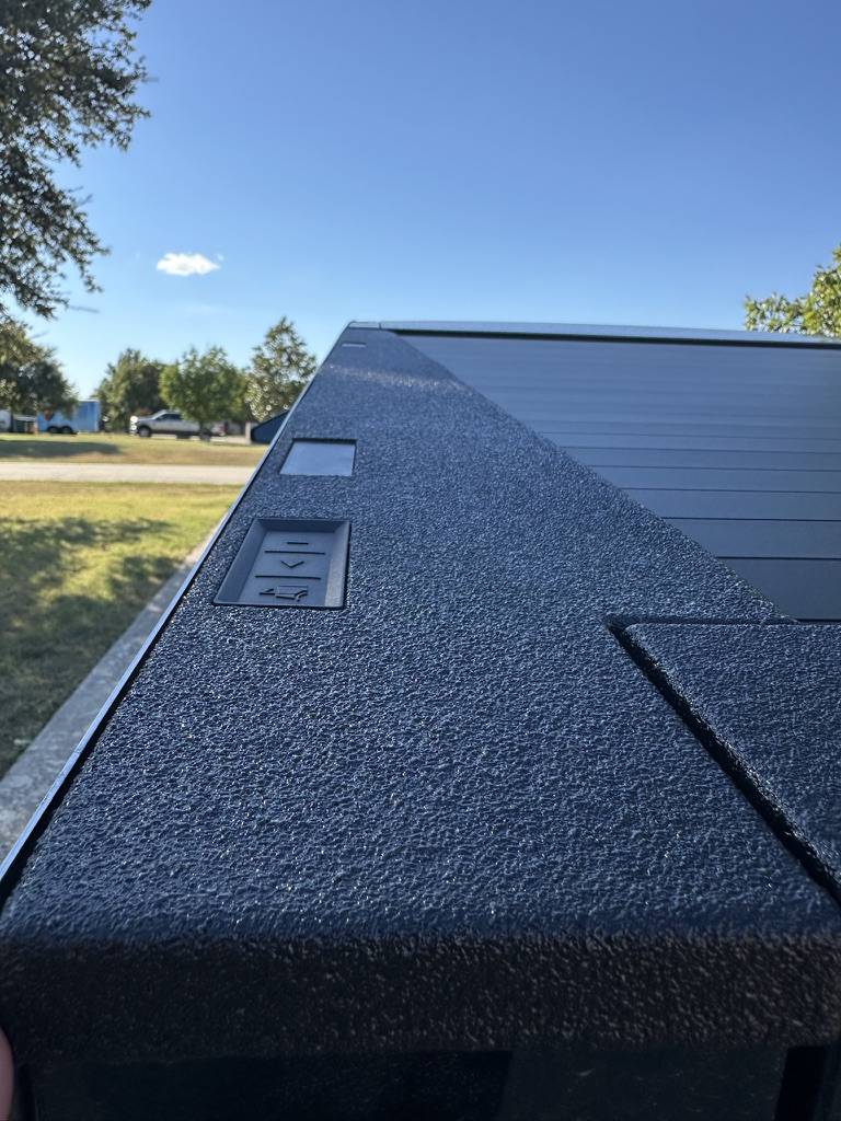

Got the parts back this afternoon and they were easy enough to swap out. The side sails come with the double sided tape already on the parts, so it was a matter of pulling up the old sails, using alcohol to clean the surface where the tape sticks to the metal, then installing the new sails.

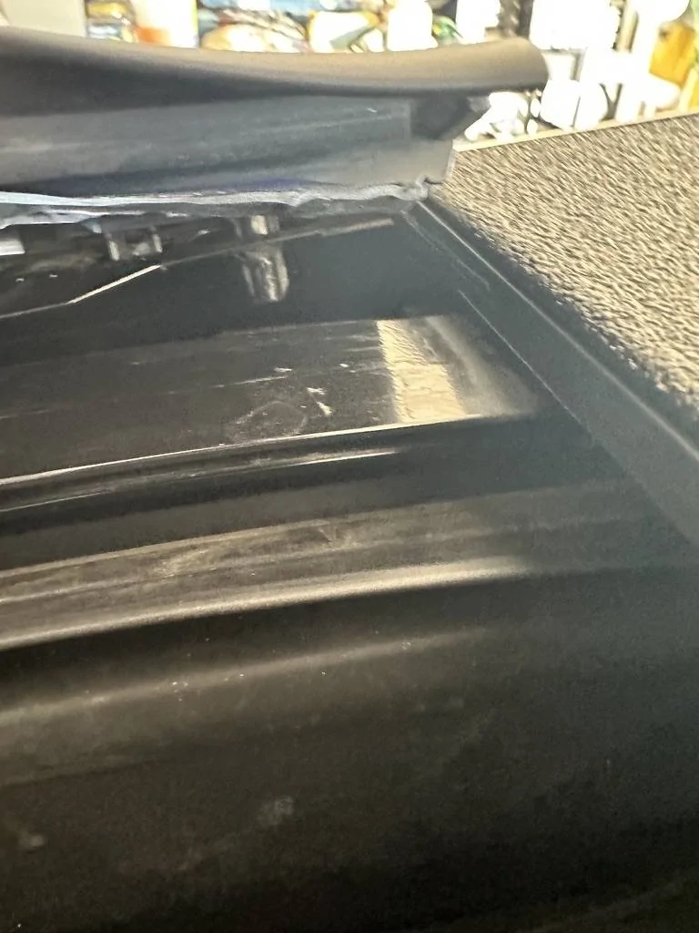

Two things of note, I did lose most of the clips when removing the sails and lost a couple from the tailgate cap, so I can see why Tesla's stance is these parts are not reusable for the clips alone. On the sails, though, there is a push nut that needs to be installed and I suspect it may be part of the recall (e.g. the push nut was added to prevent the sails from lifting enough to come off). Because I just had my sails replaced recently, I had to cut the post the push nut was on in order to remove the old sails, thus rendering them unusable. I used needle nose pliers to hold the bottom part of the post the push nut was on and cut the top so I could at least reuse the push nut and not lose those parts in the body of the truck.
I do have an issue with the areas around the cross bar mounts where it seems the shop didn't primer that area well enough and the Line-X material isn't sticking, so I'll have to follow up with them on that. Overall, I'm relatively happy with how it turned out and it should definitely make things more durable. Whether or not it was worth the cost and effort will be up to each individual to decide. FWIW, it ended up being less than expected for the Line-X at $389.70 so between that and the parts cost of $357.23, the total for me to have this done was $746.93.
Here are some pictures (in no particular order) of the parts before, during, and after installation along with a close up of the push nut referenced in the service manual.
