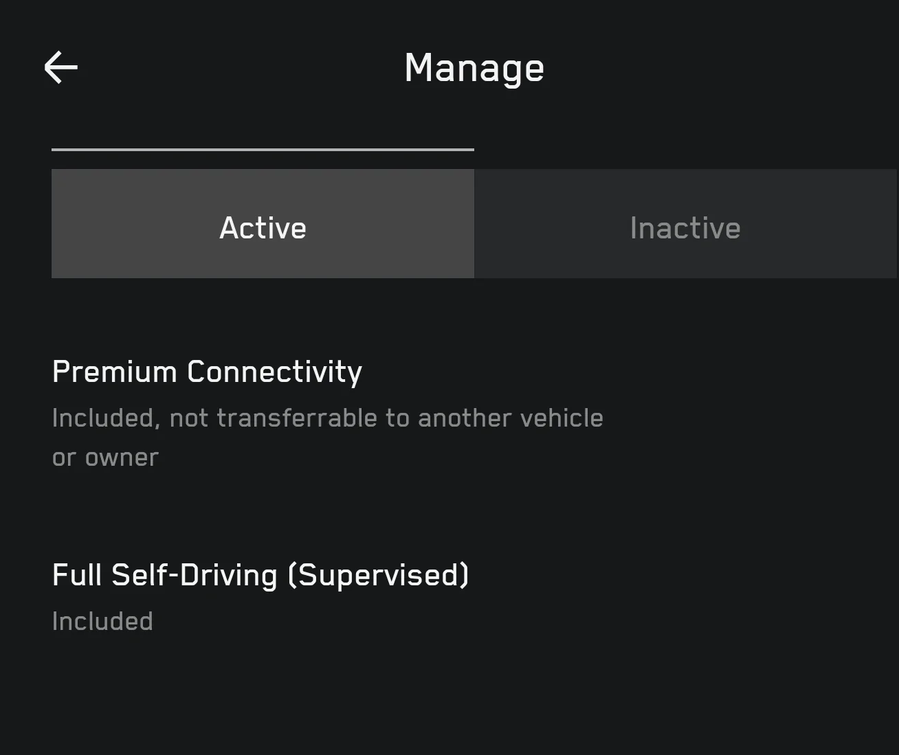

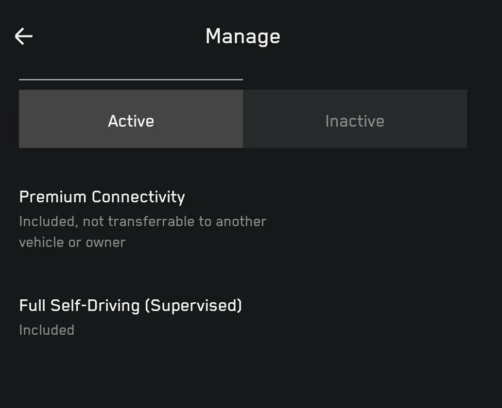

I lost my Premium Connectivity again today in my FS CT. Like last time, it popped up a message asking if I wanted to upgrade to Premium Connectivity. When I clicked it it took me to software upgrades where it said No Upgrades Available.
This looks to be the same problem I fixed recently with a re-boot. So I did a rolling re-boot (because I was already driving to my destination). However, unlike last time, it didn't fix the issue. But last time I did a stationary re-boot, maybe that's more thorough?
I had a software update ready to install (2026.2.9.3) so when I reached my destination I installed it. The Release Notes said minor fixes. On the short drive home (10 minutes) it looked like the Premium Connectivity was working again (unless it was just playing buffered music from the wi-fi at my destination).
I'm hoping this recent software update addressed this issue.
10,338
20,776
Followup:
I think I tracked the problem down to one of Driver Profiles. I use multiple driver profiles depending on the task, off-roading, highway cruising etc. It seems that an upgrade to a new phone somehow got me on the wrong driver profile (and Premium Connectivity seems to not be linked to one of my driver profiles. Selecting my normal driver profile seems to have fixed the problem. I wonder if I can link the problem profile such that it recognizes Premium Connectivity? It's a profile that I created while outside cell coverage for off-roading. I suppose I should just delete it and create another (while having cellular coverage).
