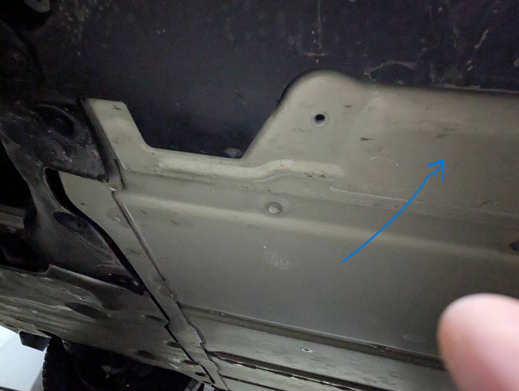

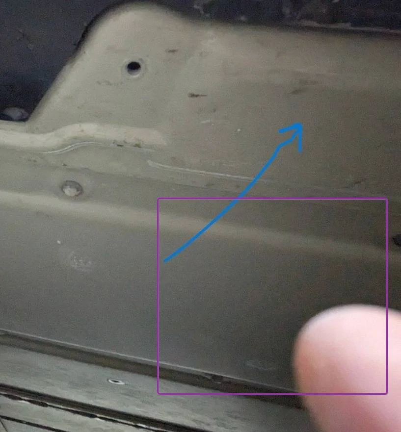

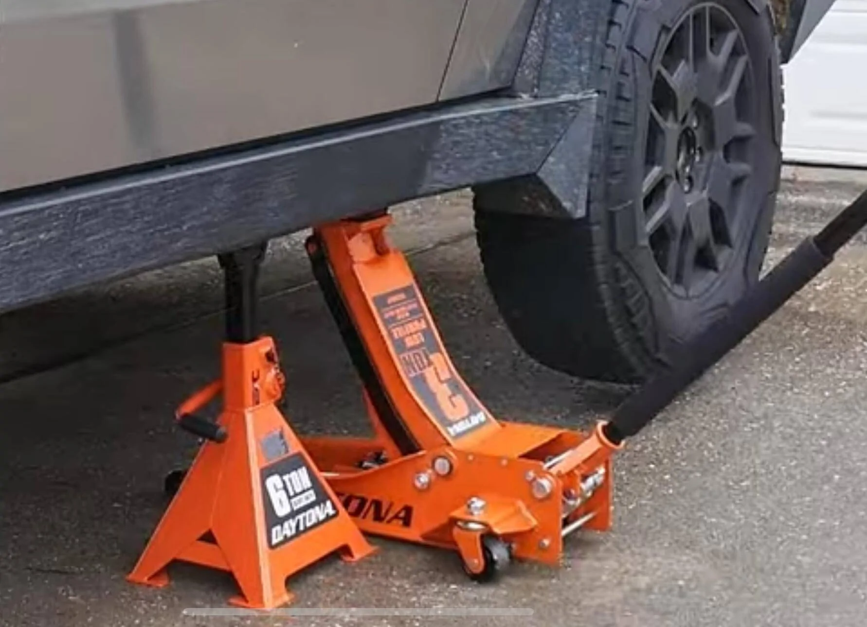

Does the 11 inch minimum height fit while in Medium height mode? I am getting about 10 3/4" height where I measured.I got this bottle jack/jack stand combo and it worked pretty well when I used to to switch over to my winter tire set-up. It's nice because it can auto catch the jack stand as you're using the bottle jack, and it can range between 11"-21". The jack has a saddle and I couldn't find a flat jack pad to use with it, so I wound up grinding the wings flat to make it flat.
