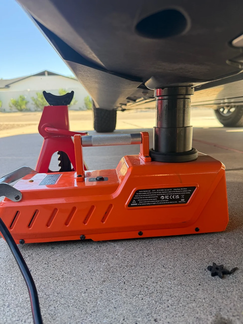

I was deep in the woods earlier this week, and got a flat... No worries I figured, got a spare and all the stuff with me. Started jacking up the vehicle and it just wouldn't get high enough even with some block under the jack. I had a 4 ton hydraulic jack similar to the one Tesla supplies. Ended up digging to get the spare installed, but that prompted me to look for a better jack... I ended up ordering this : https://www.amazon.com/dp/B0BX6N9V3G which claims nearly 17" of total height when fully extended. And guess what ? It has insufficient height to get the wheels off the ground even on paved flat terrain. Did a second test with a 6 or so inch block, and then it worked.
So the lesson is test your gear to identify gaps and fix them before an emergency.

This one works and gets high enough if any of you are as lazy as I am
https://a.co/d/06pMrDnT
I run mine off my Ecoflow power station but you could just as easily get a power brick and plug it into the vault plug.

you should let the air out of the tire and test it on a flat. Some of those jacks are too tall when they are retracted. Chances are that you’ll be changing the tire when it’s flat so that would be a more realistic test.

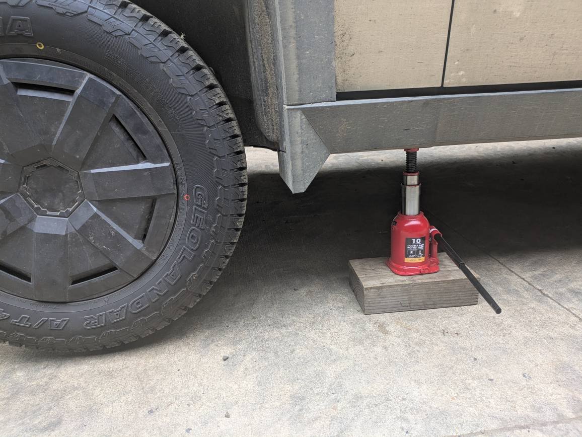

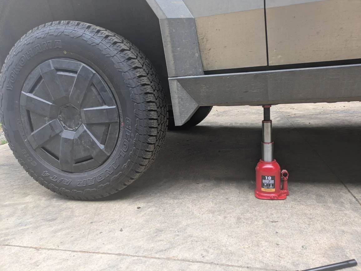

All you need is some blocks of wood (others have done it in a pinch with rocks).
Quote:
Steps:​
Drive up tire on to a 4 inch rock​
Put truck in extraction mode​
Once it is 15 inches, slide the stud under the jack point of that tire..​
Loosen lug nuts​
go into service mode (see video)​
Select individual suspension tire and deflate (see video)​
Tire will rise and will lift off the rock, so remove it.​
Replace tire​
tighten lug nuts..​
Go to service mode, inflate that one tire..​
exit service mode​
remove stud​
Jack height is specified in the listing. You can measure the rim to ground while inflated, and subtract that from 14" (very high suspension setting).
