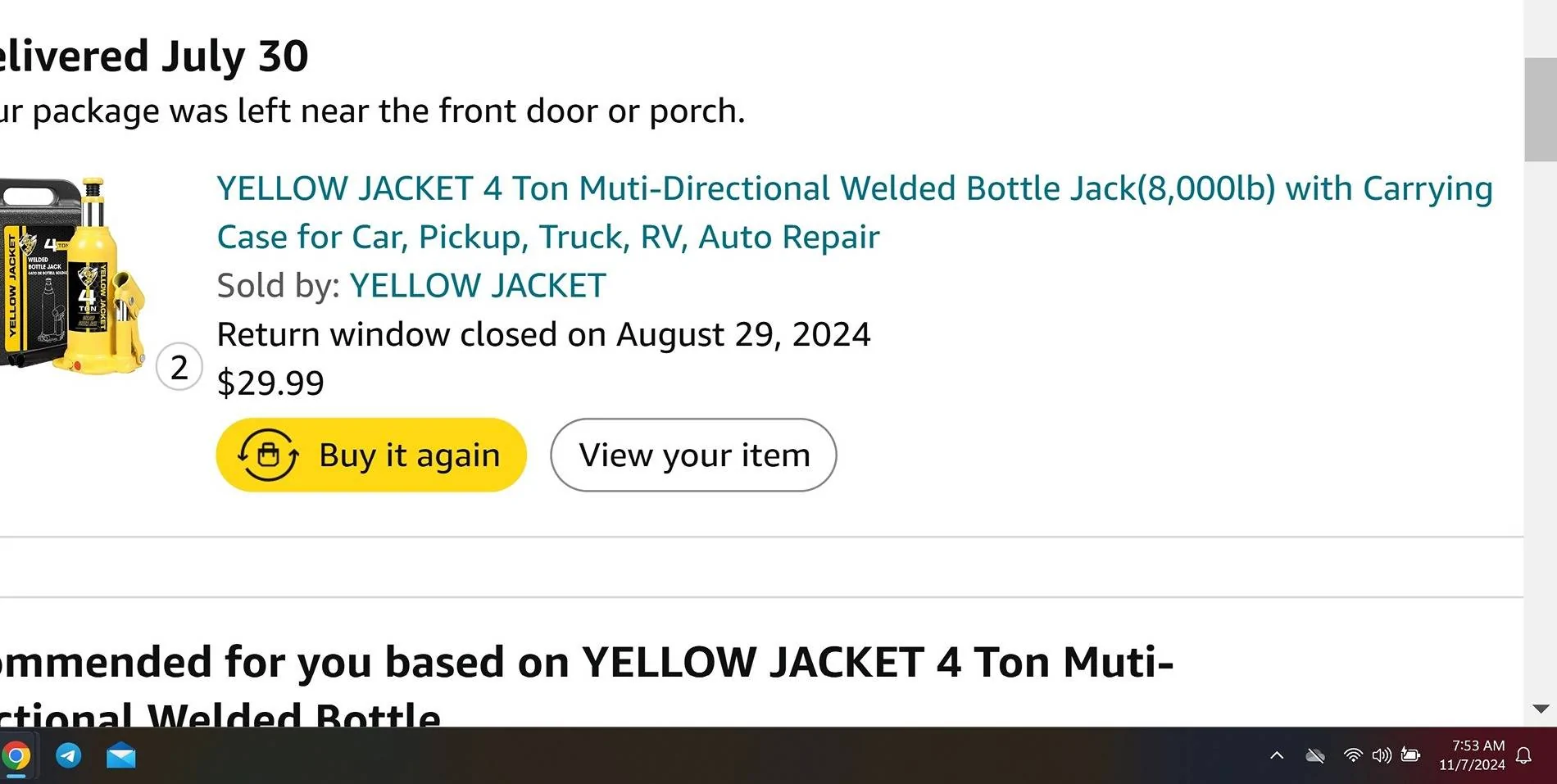

$65? that link has it for $29.99...
Edited. I misread the post and thought you said it is 65. Anyway, I bought two jacks for 65 total.
