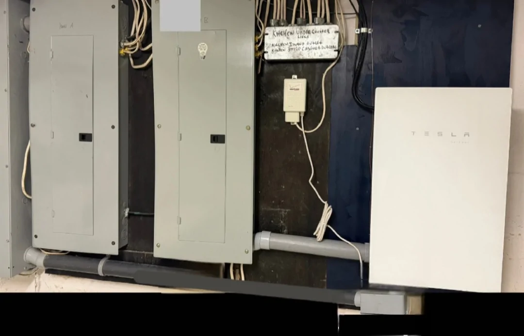

I’m seeking advice on how to handle a major installation error. I finally had my Tesla Powershare system installed (Universal Wall Connector + Gateway) for my Cybertruck after holding the hardware for a year.
The Goal: Whole Home Backup. The Reality: The installer wired the system as a "Partial Home" backup, and they did it incorrectly even for that configuration.
Current (Incorrect) Setup: [Service Meter] —> [Main (200amp) Panel A] —> [Subpanel (200amp) B] —> [Powershare Gateway]
The Issue: The Gateway is at the end of the chain, it only backs up the circuits inside the Gateway itself. If the grid goes out only those brakers inside the gateway are backed up. Tesla Support confirmed my account is provisioned for "Full Home Backup," but the physical wiring contradicts this. Tesla stated the Gateway is suppose to be right after the meter.
My Dilemma: 1. The installers have been paid, but the job is technically incomplete/wrong. 2. I’m worried that if I force them to redo it, they will cut corners to avoid a total loss on the job. 3. Should I trust them to fix this, or cut my losses and hire a new Qmerit-certified pro to rip it out and start over?
Questions for the community:
  • Has anyone successfully forced a "fix" from an installer who clearly didn't read the manual?
  • What is a fair "rework" cost if I hire a new company?
  • Are there specific "gotchas" in moving the Gateway to the Service Entrance that I should watch out for?
Here is my current setup:
[Service Meter] —> [Panel-A] —> [Panel-B] —> [Powershare Gateway]

[Powershare Gateway] (Photo)
It is a sub panel with limited circuits and power. They should have asked you what circuits you wished to have available for backup when you have a power outage.
10,247
33,923
If they were not going to wire up everything, then there should have been a discussion before work began. Red flag #1.
Of course, documenting the circuits with Sharpie scribble is disqualifying IMHO. Get a LabelMaker FFS

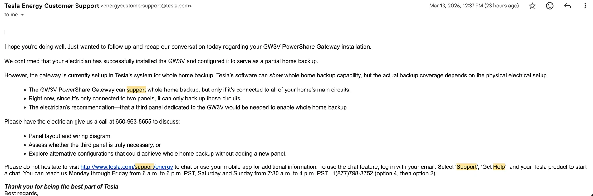

Attached is the response from Tesla --

It would add expense to your system but that looks like a good application for a load-shedding panel (SPAN Panel, etc.).
In any case, I would have someone else draw up a correct schematic and have the original contractor install it how it should have been installed to begin with. Education is expensive and it looks like your electrical contractor needs some education.

I am speaking with the owner of the company. And rather than him simply following Tesla’s guidance and speaking with their installer hotline he is trying to convince me and providing alternatives. I really do not want any back and forth with the electrician. I just want the system installed how Tesla recommends. The installer stated “what needs to happen” after the fact and apparently did not follow the installation guide as a Certified Tesla installer. When he states “reduce the panel from 200amps to 50amps.” it left me feeling empty. Especially when Tesla specifically stated: “The GW3V PowerShare Gateway can support whole home backup, but only if it’s connected to all of your home’s main circuits.”
Response from Owner/Installer:
I looked into connecting one of the main panels to the gateway. Here is what will need to happen to connect an entire panel.
1- You only have 11kw of power available. The connected load to the gateway cannot exceed 11kw or 50amps. I would need to calculate all the loads connected to the panel to determine what you have. One central AC is typically 4 to 5 kw. Once we determined the connected load I would likely need to move several circuits from on panel to the other creating the "Battery back-up panel" and the "non back-up panel". This will essentially reduce the panel from 200amps to 50amps.
2- The gateway will need a 200amp main breaker installed. The S1 and S2 lugs need to be removed and the main breaker connected.
3- The service feeders running from the trough to the panel will need to be removed and a new set of feeders extended to the gateway.
4- A set of feeders will need to be run from the L1 and L2 in the gateway to the "Battery back-up panel". This panel will need all the grounds and neutrals separated and will become a sub panel.
The inspector has not come out yet, but I will share my frustrations with them.
What frustrations does this installer need to share with the inspector? Had I not brought up my concerns would the installer have had any frustrations?
