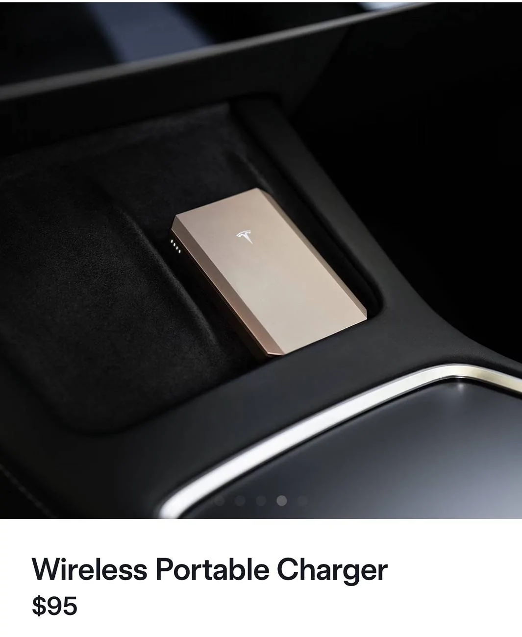

Hoping that the new Wireless Portable Charger on Tesla‘s online store might work like my idea of a MagSafe to Qi adapter
Magnetic, wireless charging
“can be recharged using your Tesla's charging pad”
Description doesn’t specify whether it can charge while it is charging.
https://shop.tesla.com/product/wireless-portable-charger?sku=2048596-00-A
