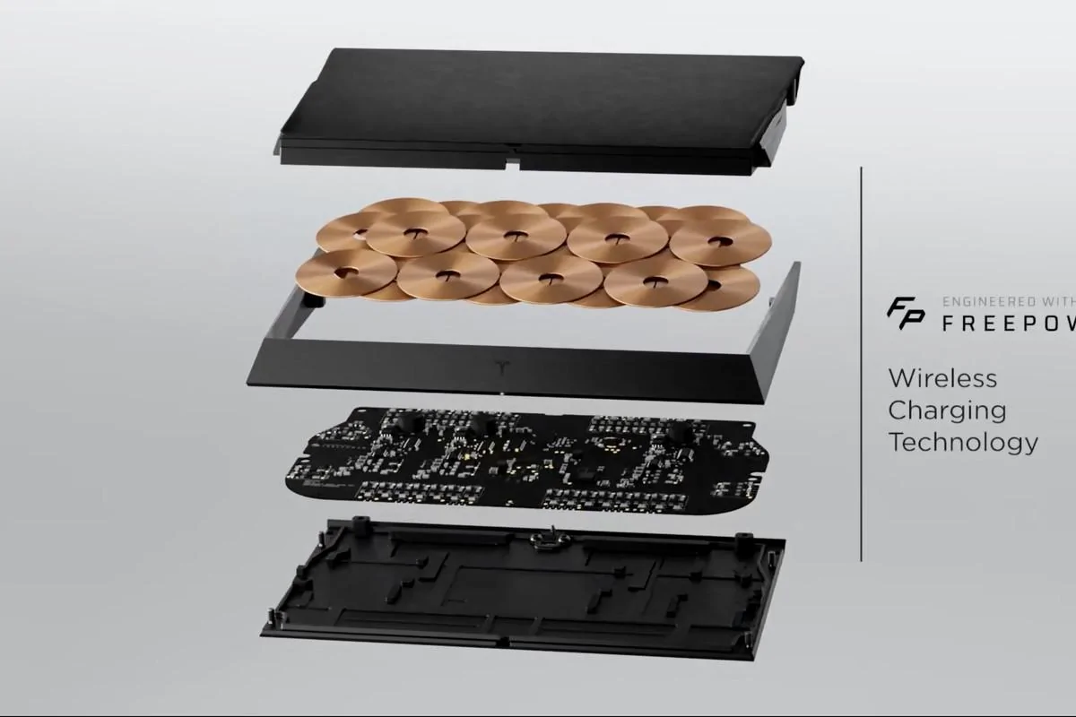

Tesla actually sells a Wireless Charging Platform, presumably one of their in-vehicle chargers stuffed into a desktop case:
https://shop.tesla.com/product/wireless-charging-platform
Which purportedly looks like this internally:
Tesla Cybertruck Iphone charging, overheating the phone, possible cause? Screenshot_2022_12_23_at_09.40.17
With that many coils it's hard to miss! The Cybertruck charge pad may be different internally, but I'm not willing to take mine apart lol

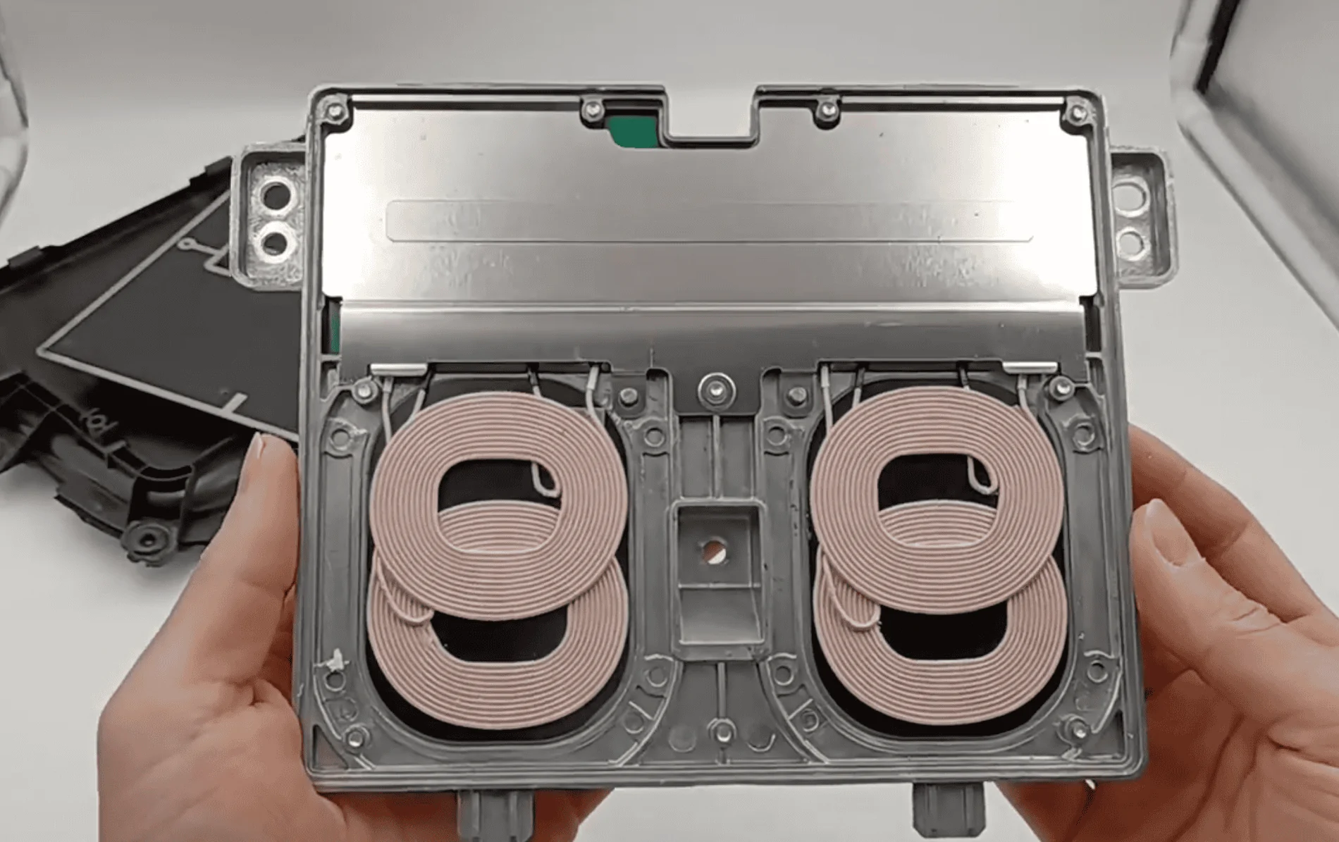

The Model Y charger looks very different internally:
Tesla Cybertruck Iphone charging, overheating the phone, possible cause? Screenshot 2024-08-13 at 6.33.34 PM
But this is a "V3" revision, and the Cybertruck is "V5".
Tesla does not use that array in the vehicles but they should.
