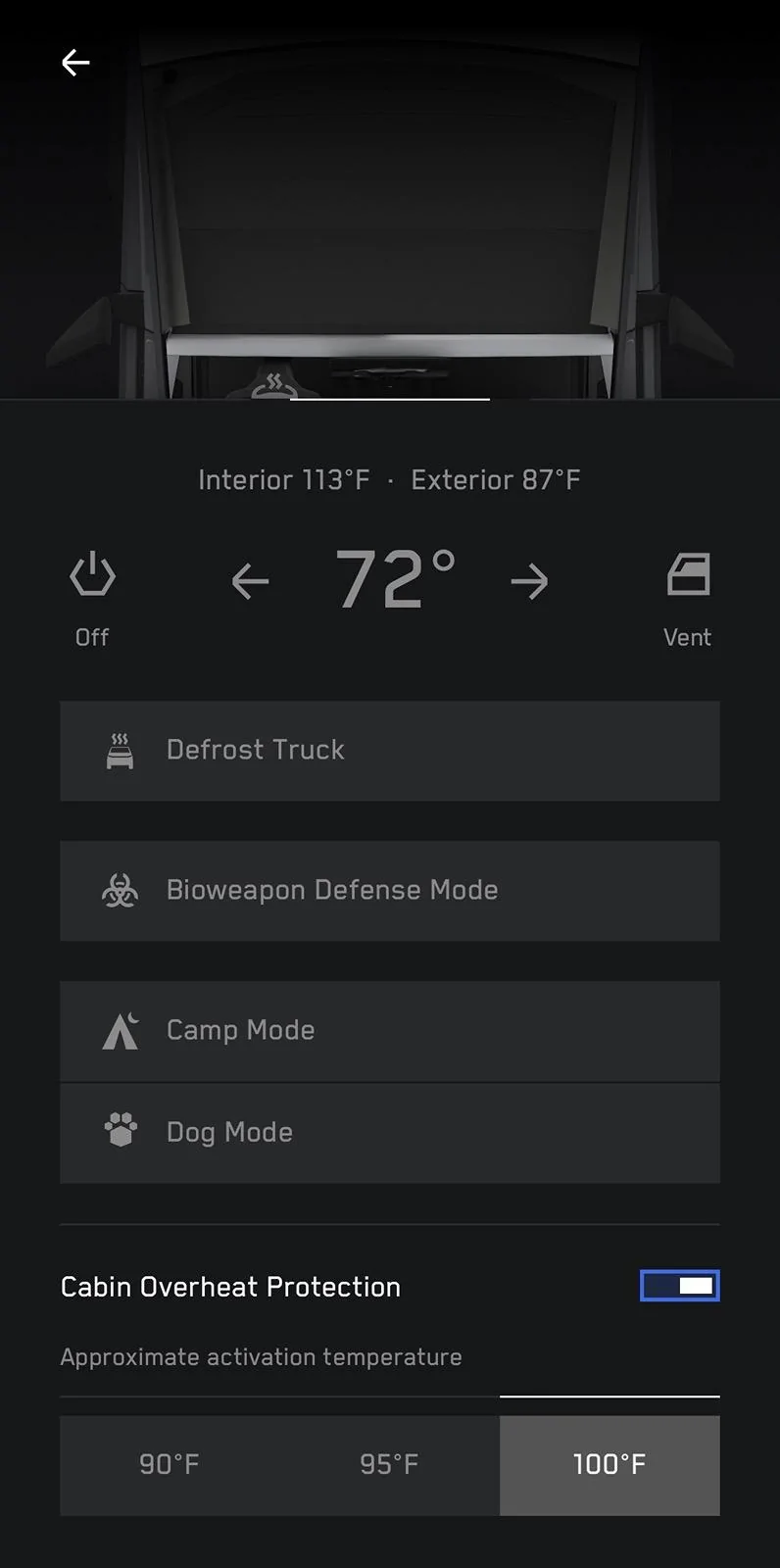

Tesla Cybertruck Is Cabin Overheat Protection not working? IMG_6997
113F interior despite 100F ceiling limit.

Mine was working great with 2024.14.3. Just received 14.6 but have not tried it again yet.
It seems to have stabilized back to 100F now that I’ve awaken it. I’m curious if left idle too long, does entering its lowest power mode (hibernation) prevent cabin protection from operating. I had the truck sitting on the driveway for a couple days.
Yes, it does have a time out.
The time out is twelve hours in a Model 3, but yeah, doesn't work in hibernate or sleep mode. Also shuts off if the battery gets low.
Dunno what parts are different in the Cybertruck - it doesn't use the same software branch. Model 3 allows 'fan only' vs 'use AC' for the overheat protection, so maybe it's only partially enabled in the software so far.
10,270
34,004
COP is intended to maintain a reasonable upper temp for your comfort, not to protect the vehicle. It therefore disengages 12 hours after being parked.

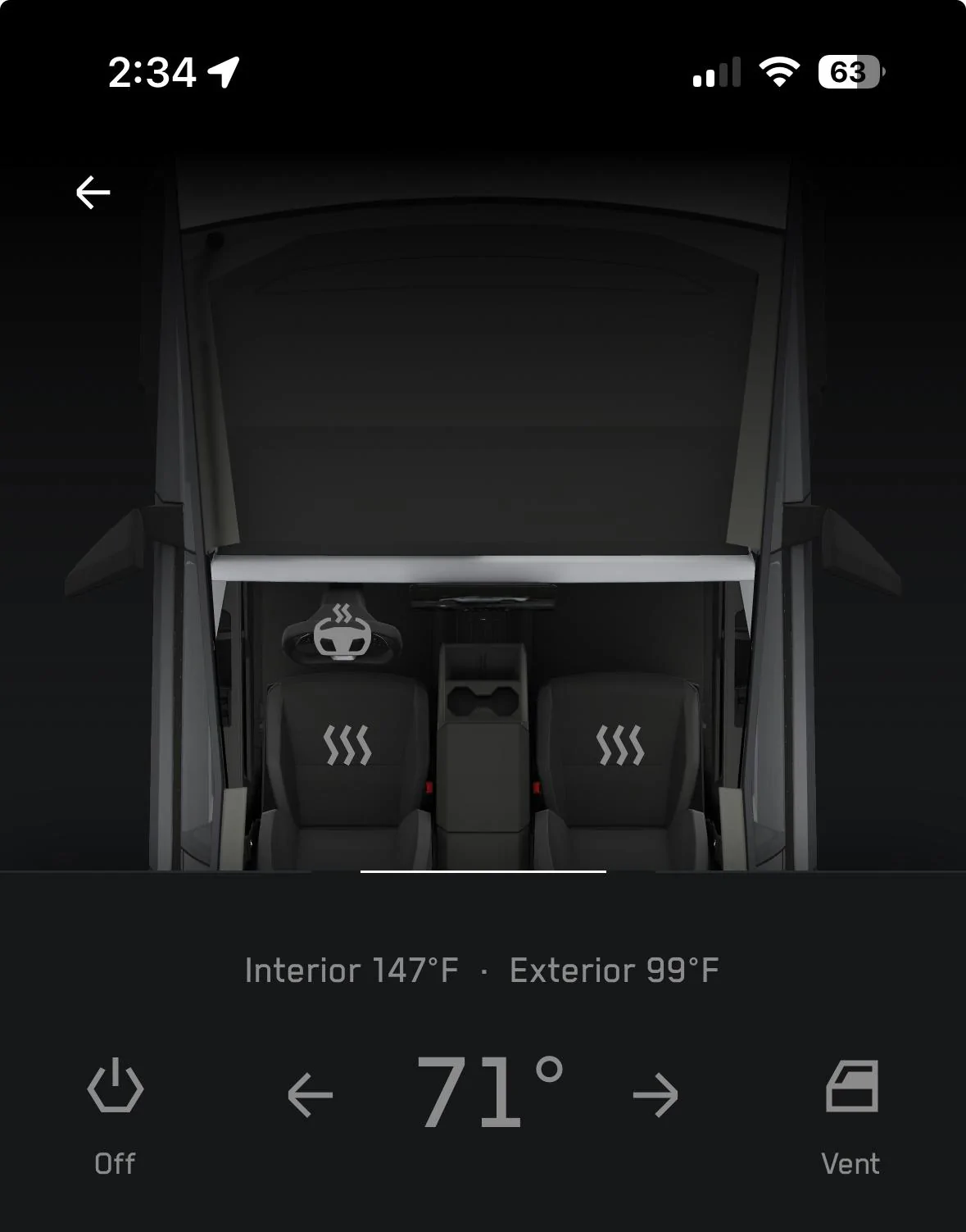

Tesla Cybertruck Is Cabin Overheat Protection not working? IMG_0014
Only 147Âş lol
I tried "Vent", but this dropped the temp about 5Âş within about 10 minutes, and then it stayed there for hours.
So instead I activated climate: 5 minutes to get down to ambient, another 10 or so to get comfortable (below 80Âş) and another 10 to reach my set-point. This is while parked in my driveway, in the sun. August is going to be interesting.
