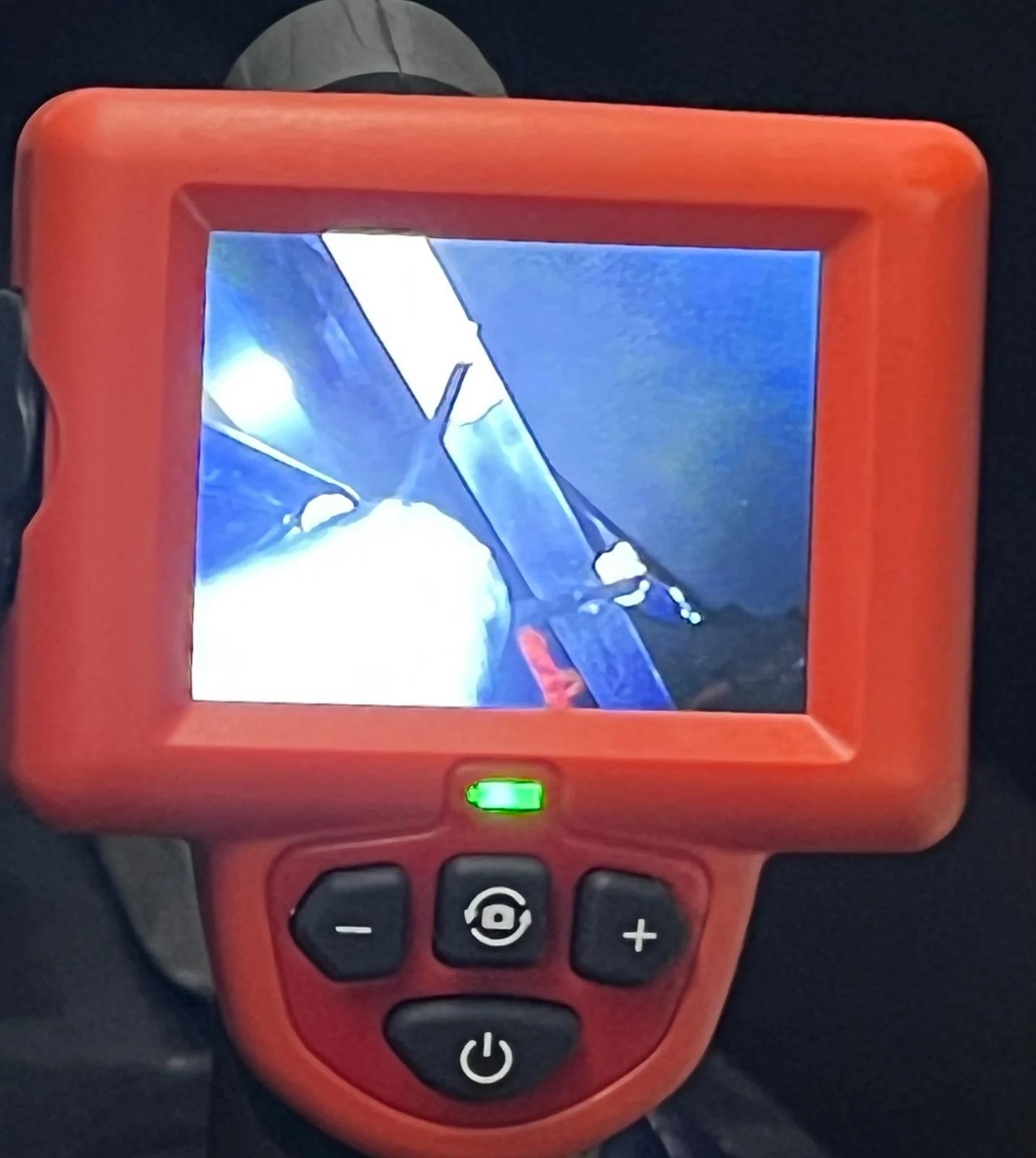

My wife rigged a plumbing grabber tool with hot glue blobs on the teeth but there is this annoying bar in the way. iPad is above that silver bar. ?

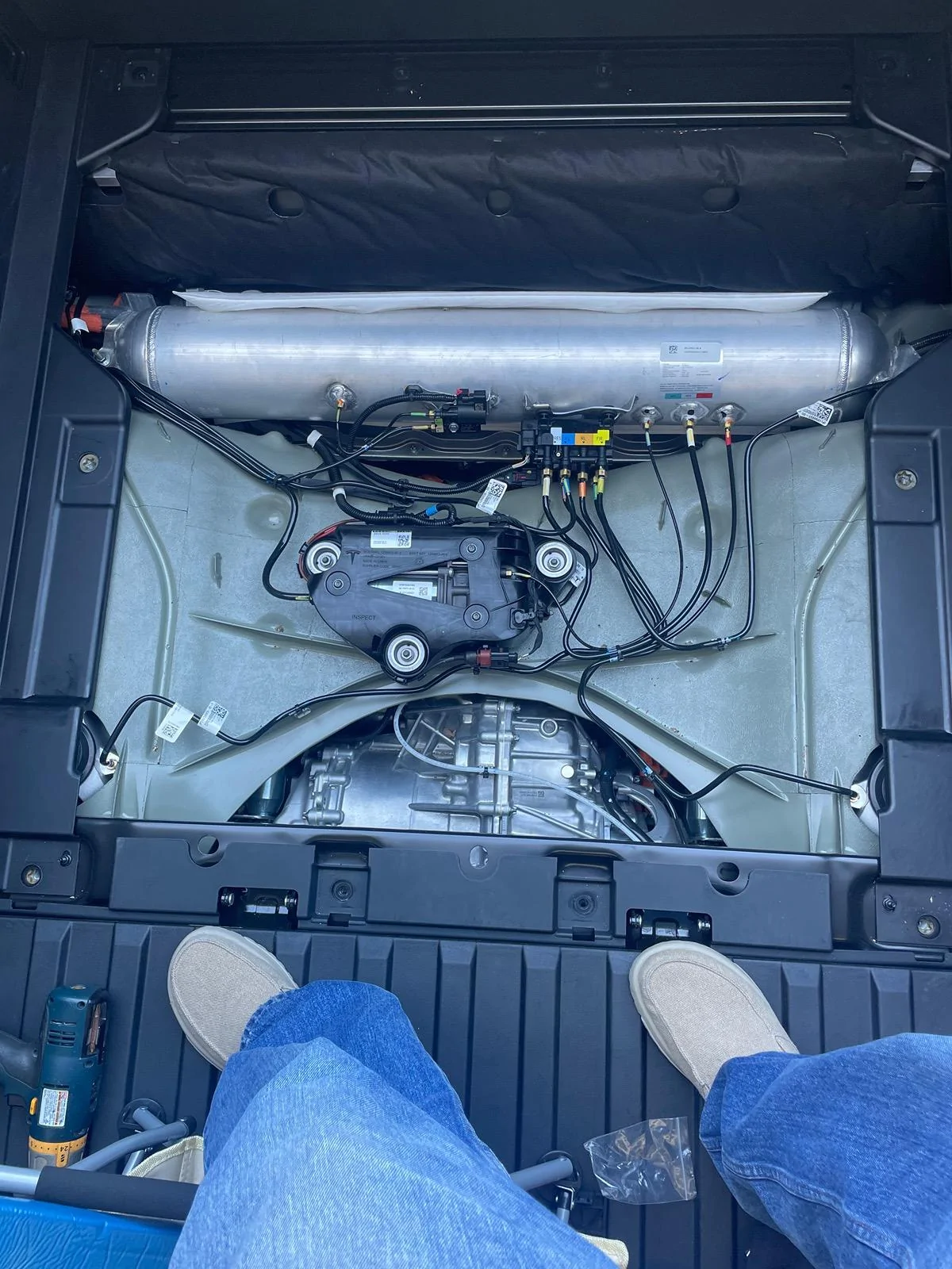

I'm sure Tesla service can get it out for you. You might be able to get it out yourself if you drop the tailgate and crawl in you can unscrew the font part of the truck bed slide that panel back sn you might see the ipad laying there. I dropped a washer down the side gap and when i removed the cover to try to find it I saw the tonneau cover was all rolled up there.

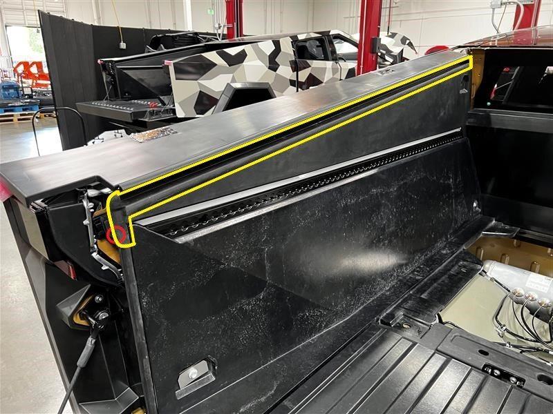

What is interesting is that all instructions for the LH side panel assembly show no power outlets. Which honestly is not good as I have no idea how to remove side panel without messing up the outlet wiring behind it.

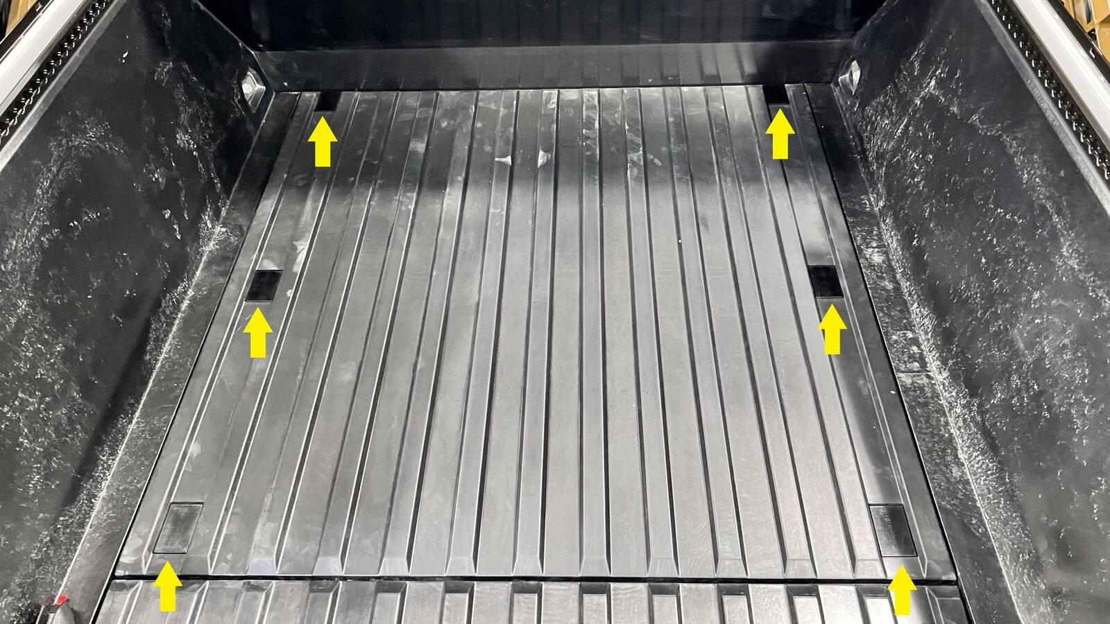

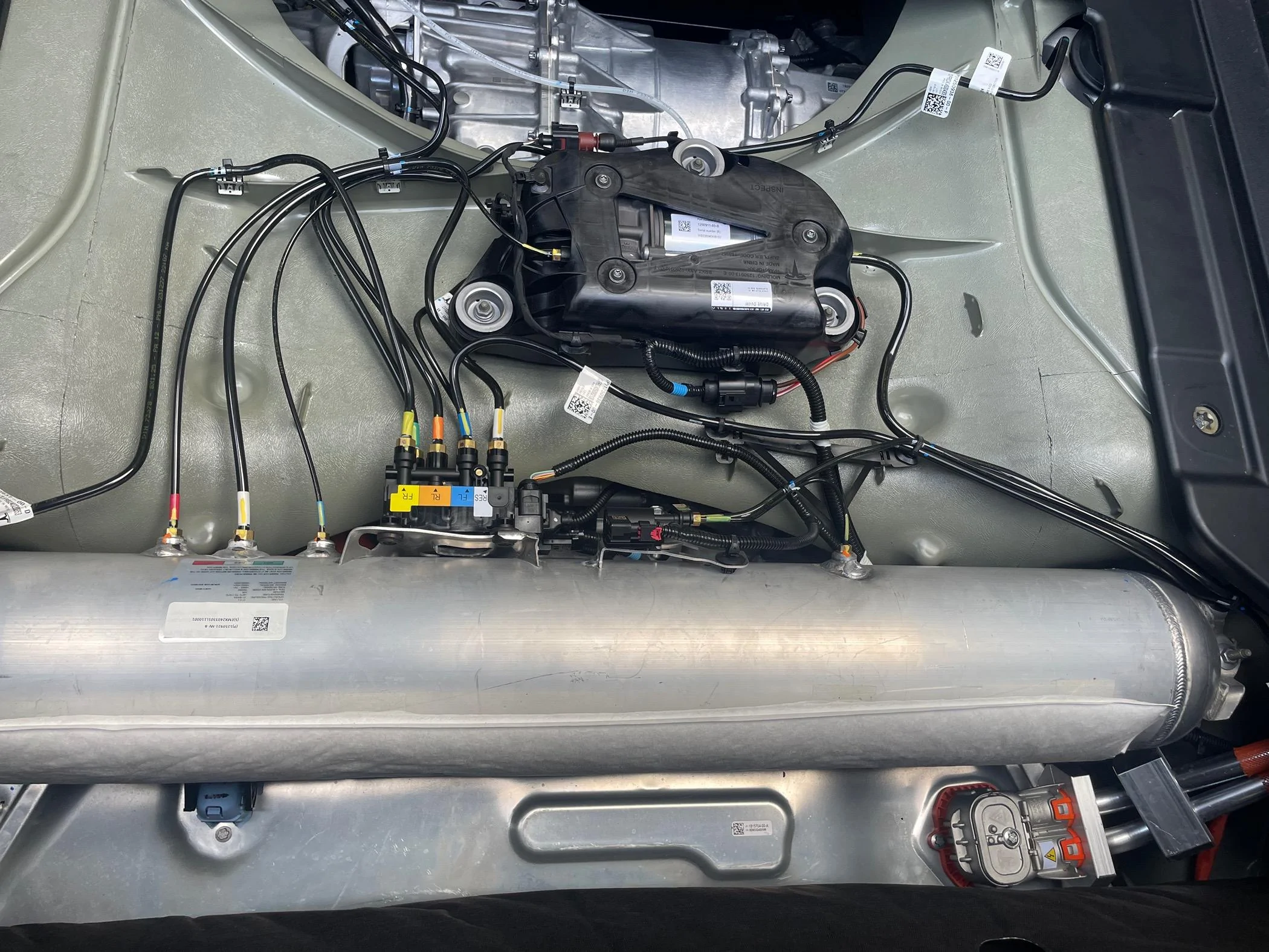

Maybe this other pic shows the tonneau cover better. Its behind the soft black fabric in front of the compressed air tank. To remove the cover just lift the plastic covers up and undo the 10 bolts. I tried to upload a video for you but x said its too big.

That’s the bed floor not side panel though. Can’t get access behind that front wall with bed floor removed. In reply to cyberGus.

Not sure if your question was for me but no nothing needs to be done with the outlets or power. It only takes about 10 minutes to remove the bolts and lift the front portion of the truck bed up. The power outlets are at the back of the truck.
